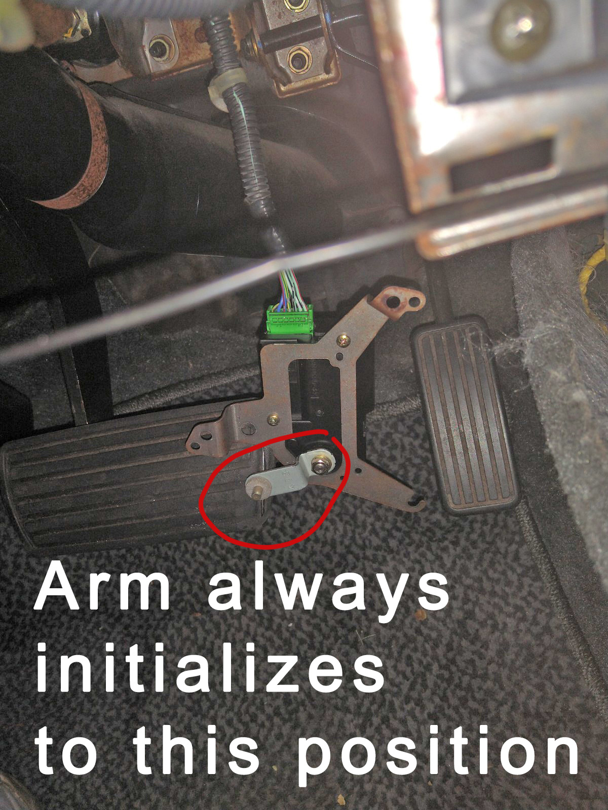

When I reinstalled, instead of spinning endlessly, this time the actuator arm initializes...then goes to a particular position. But it does not respond to any commands from the climate control panel. I've tried every combination of buttons to try and get the arm to move again. Nothing.
So, I disassembled and tried changing the orientation of the arm then reinstalling. No matter where I seem to place the starting position of the actuator arm, as soon as I turn the car on it always rotates back to the particular position as shown in the picture. And will never do anything else.

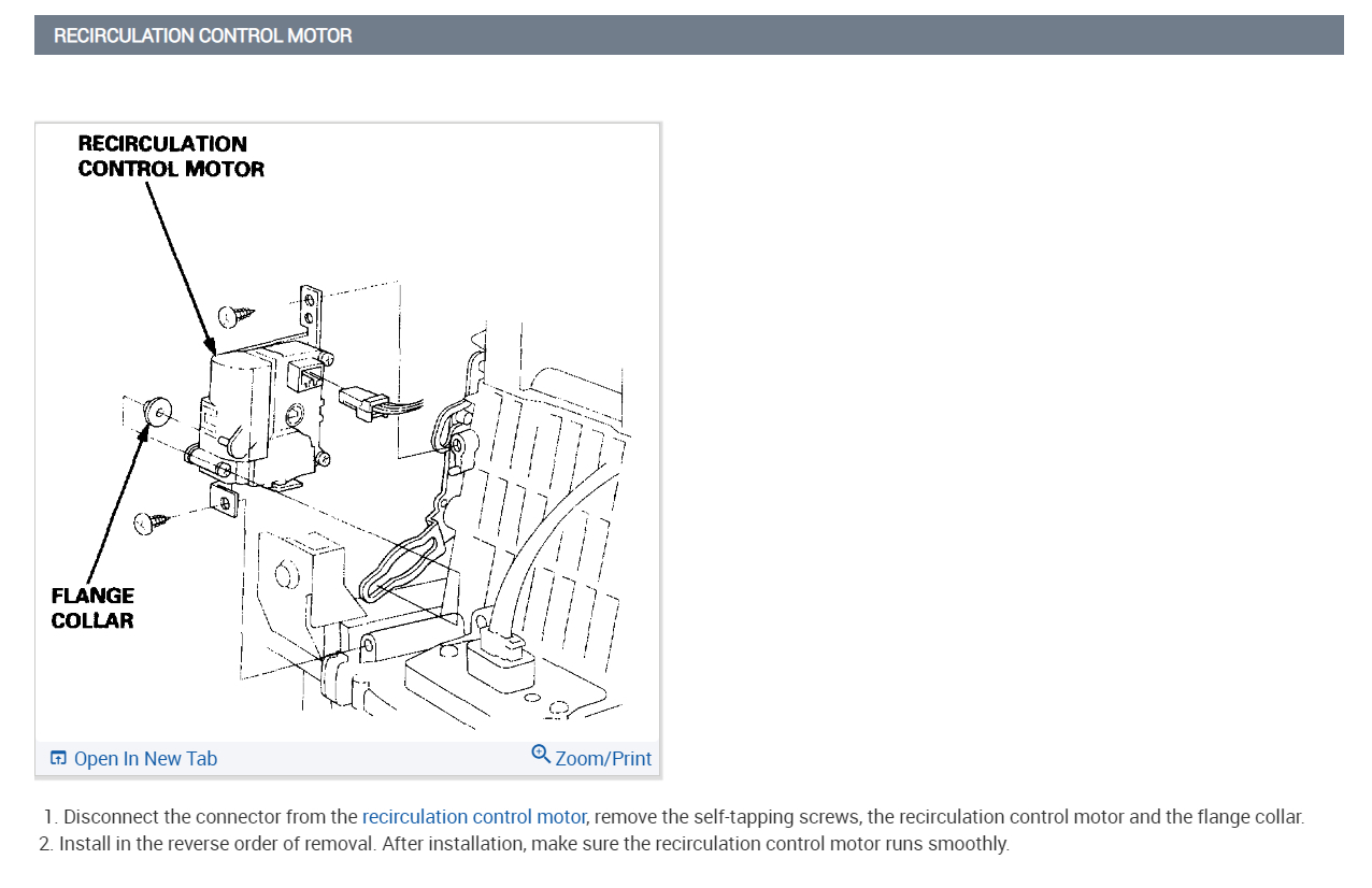

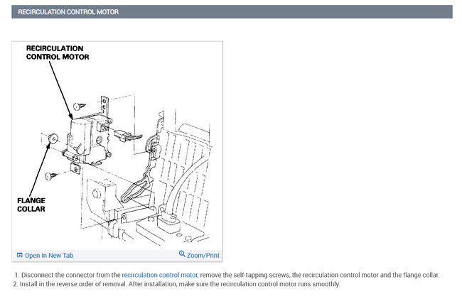

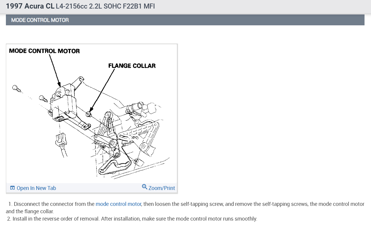

Yep, the arm position, the system automatically re-initializes and recalibrates itself into the proper position. But it sounds like the potentiometer is not working inside the blend door actuator which happens. I would get a new unit and replace the old one. Here are the instructions to help you install it correctly in the diagrams below. Check out the diagrams (below). Please let us know what happens.
