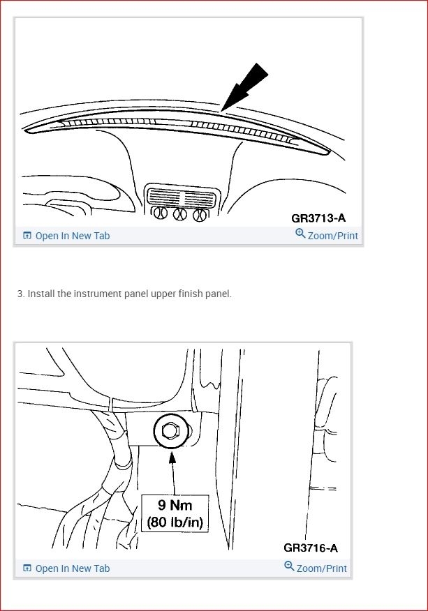

Hi, my car is stuck on defrost. All of the vacuums seem to be connected. Does anyone know how to replace the blend door on this car listed above?
Jun 17, 2019 at 8:25 PM

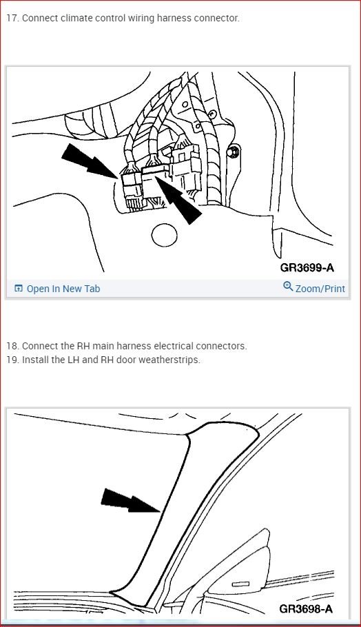

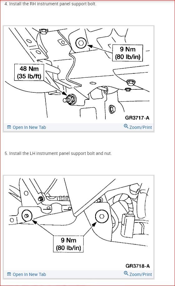

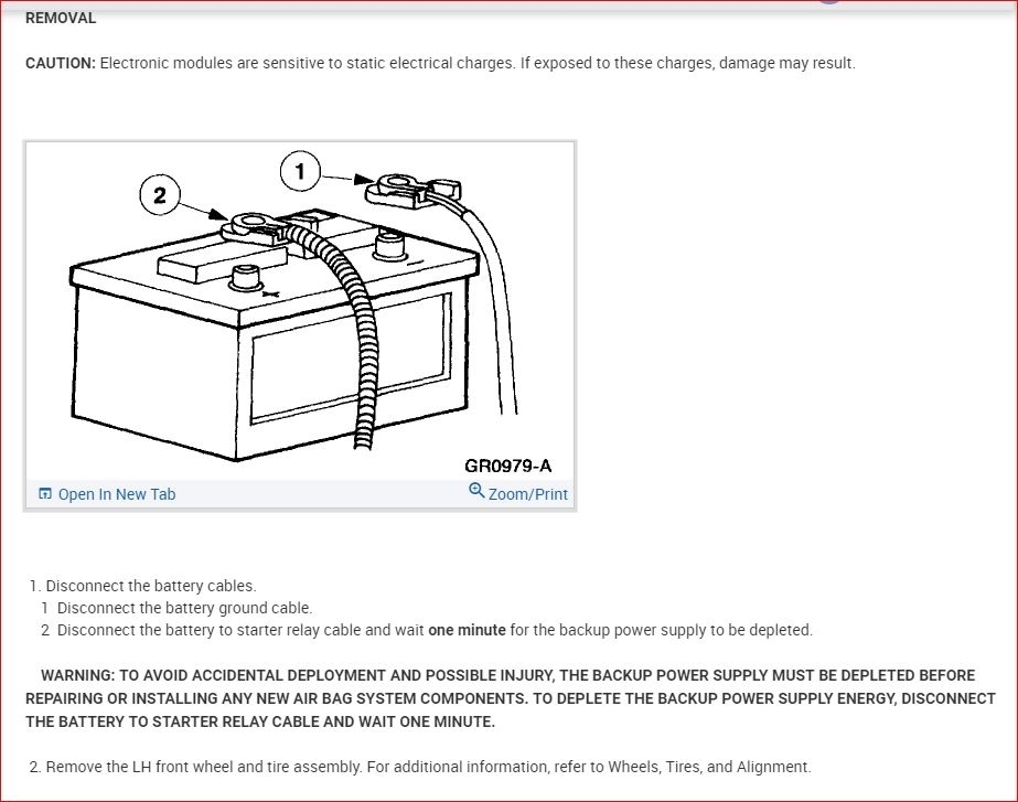

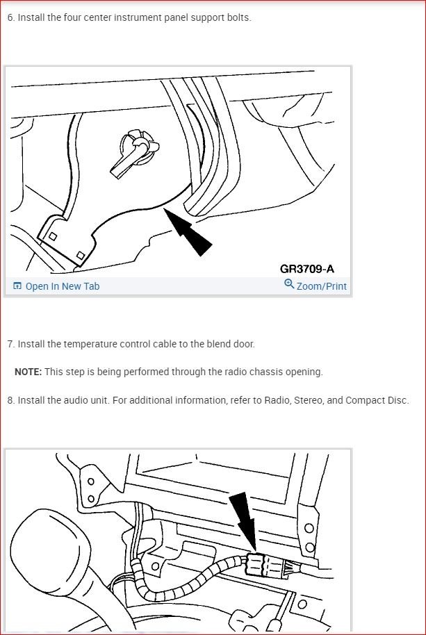

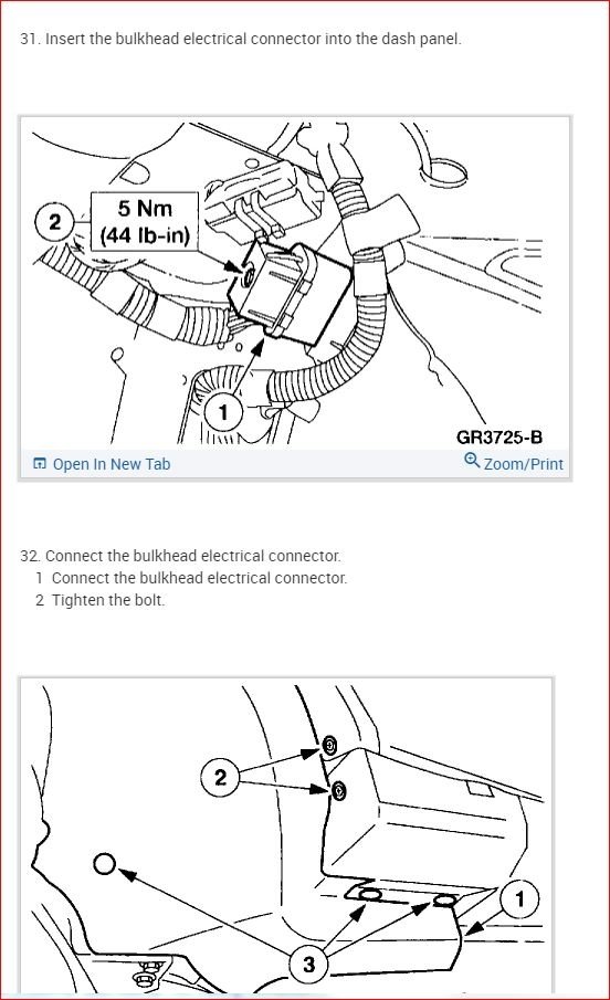

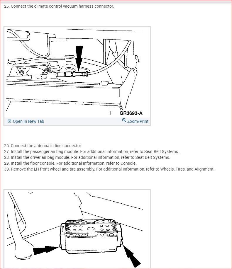

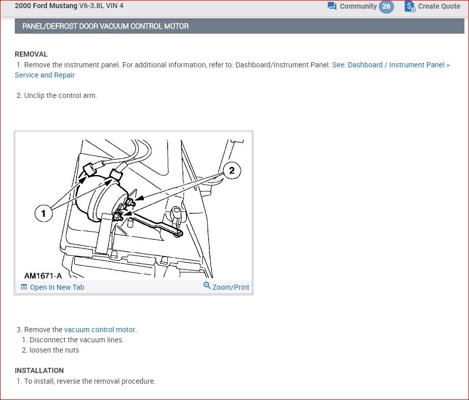

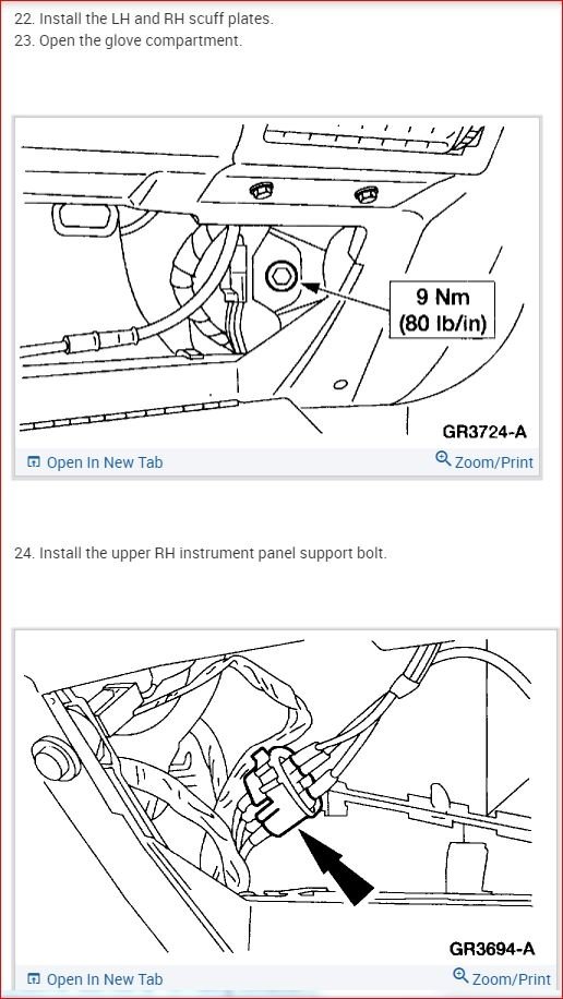

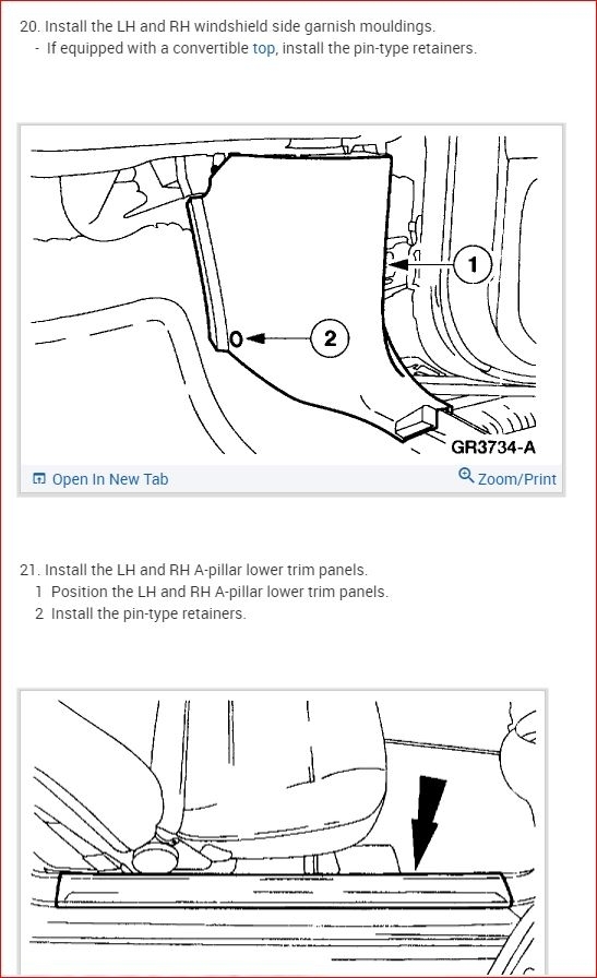

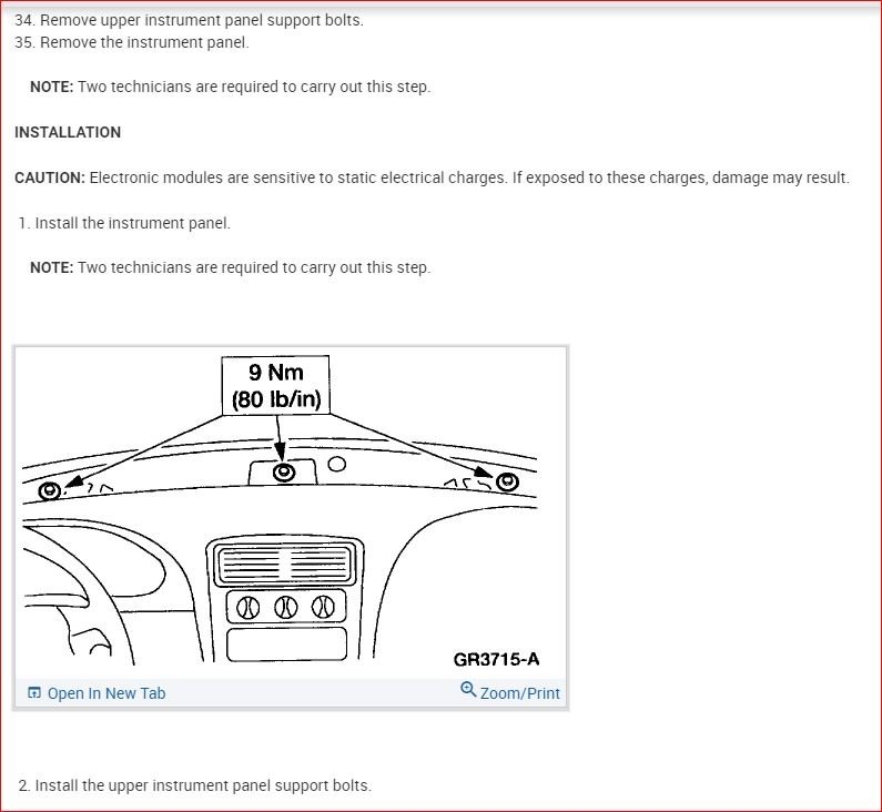

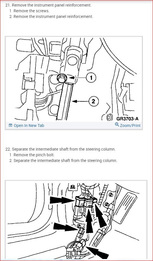

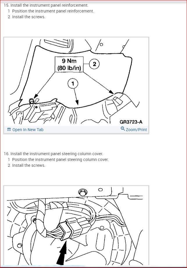

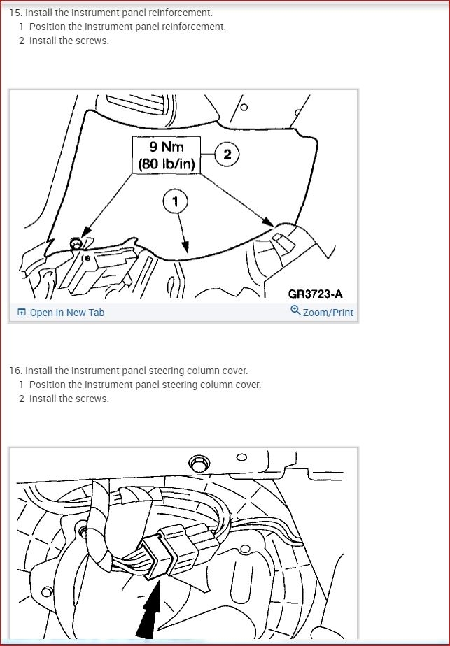

Hi KR03204,

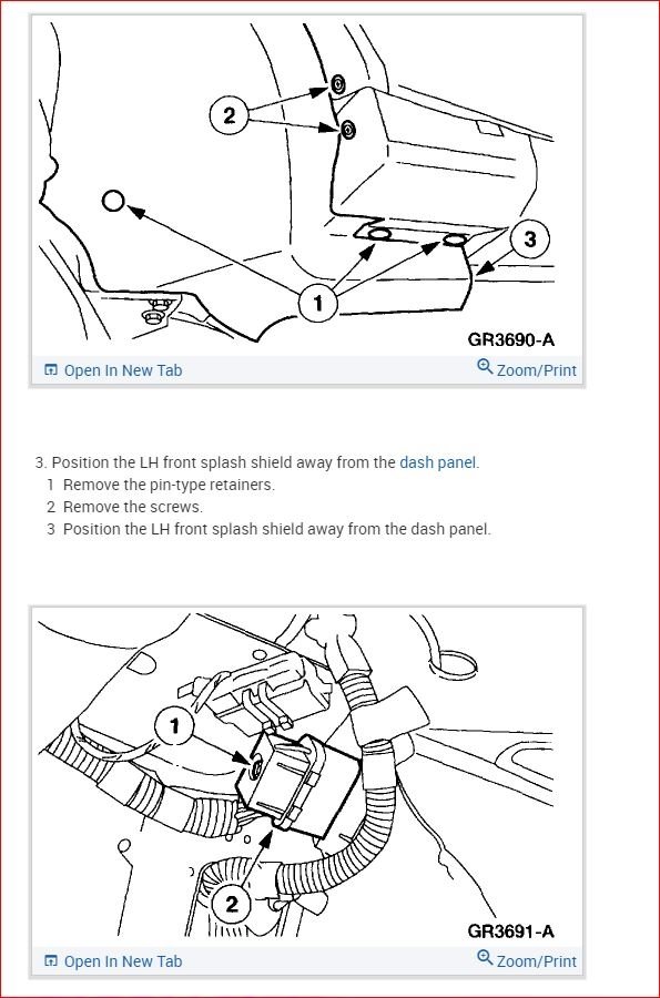

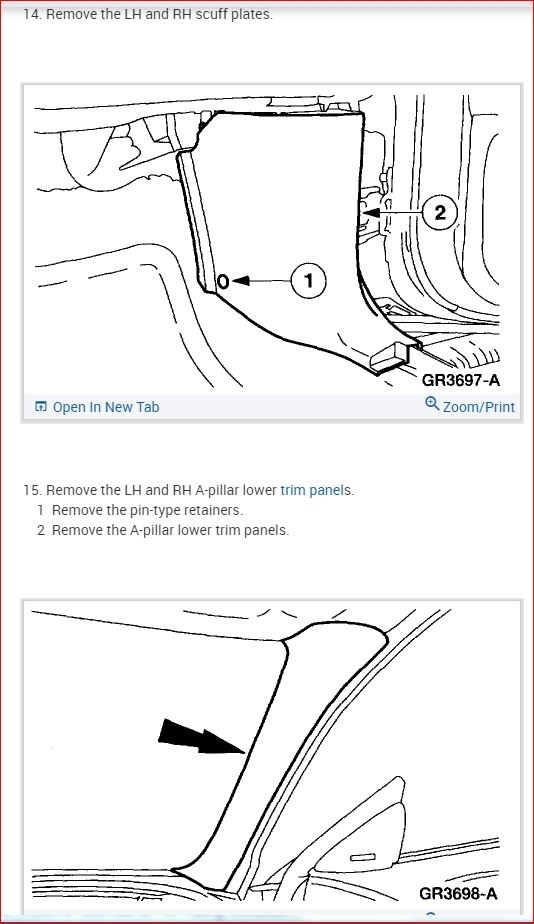

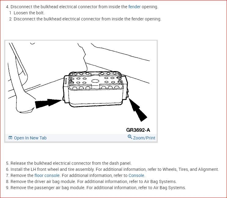

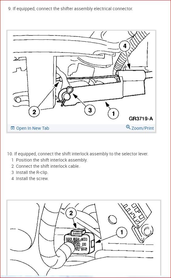

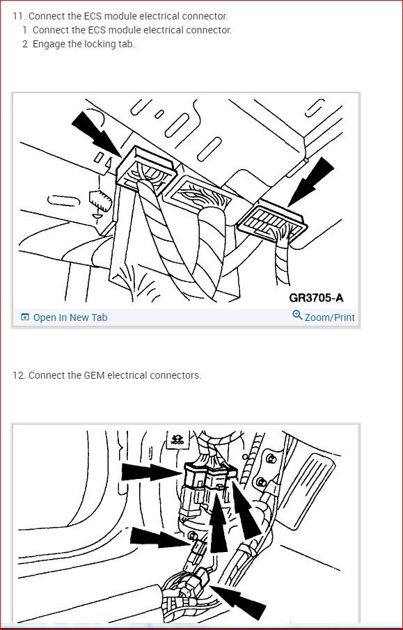

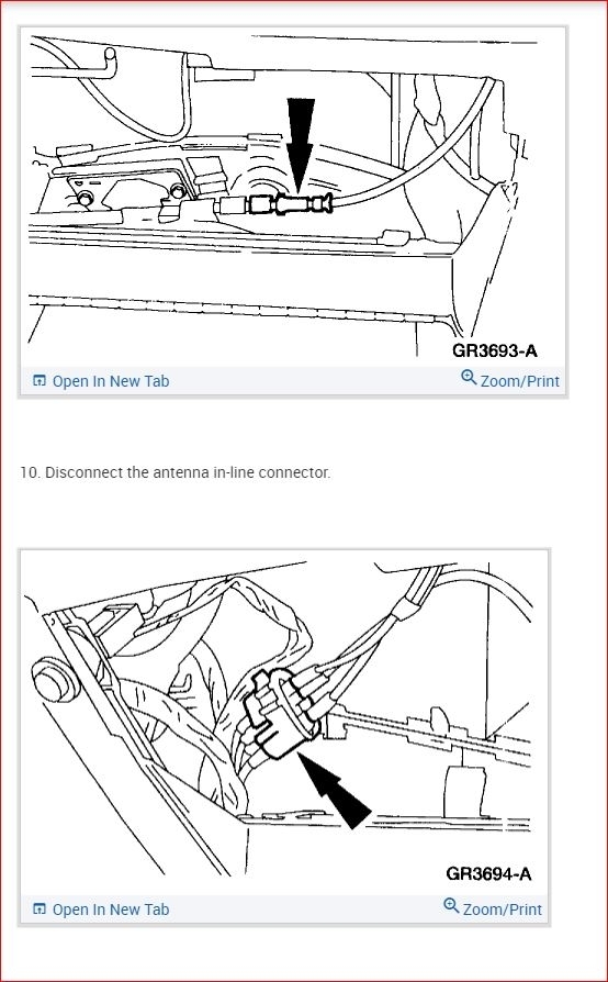

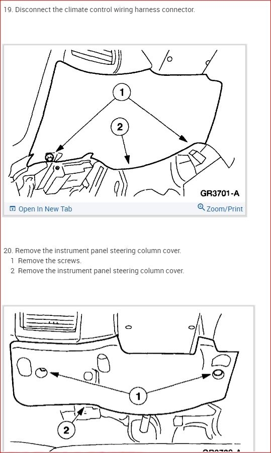

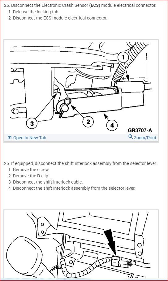

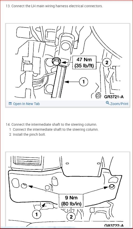

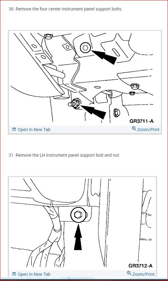

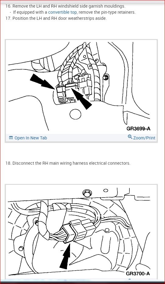

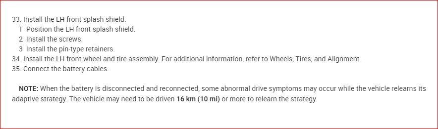

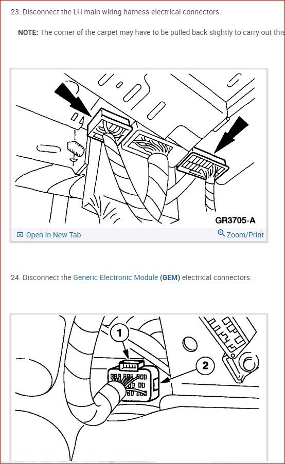

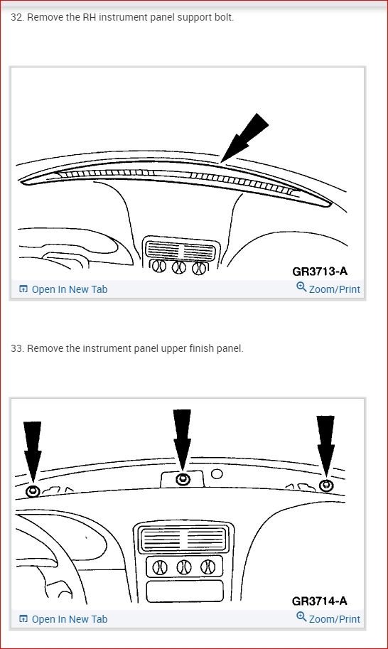

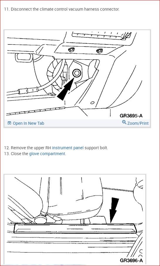

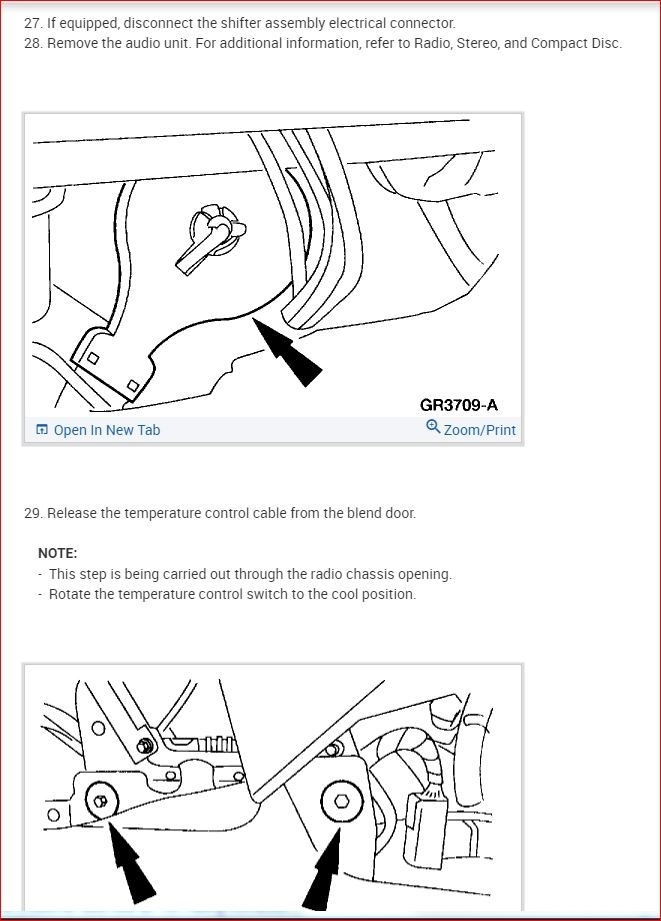

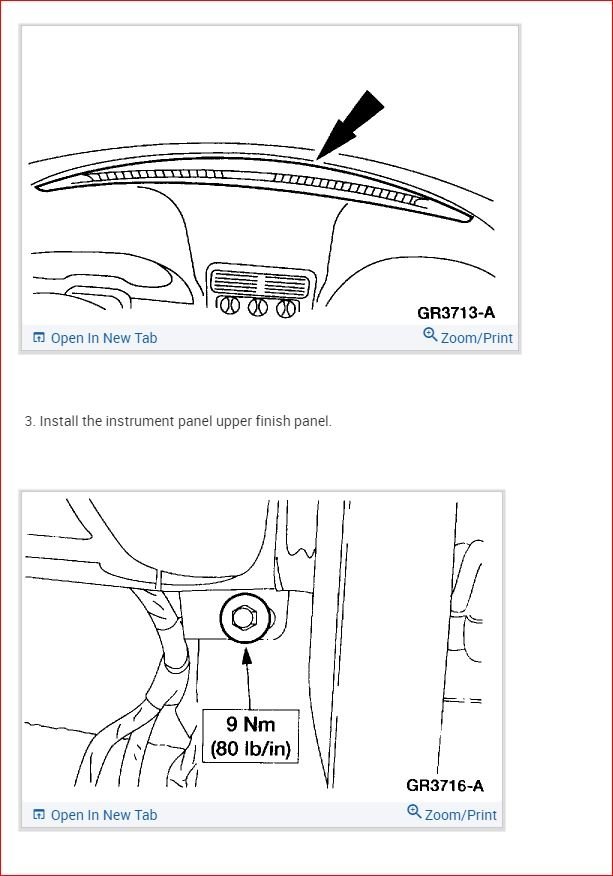

This motor requires you to remove the dash. I attached the procedure on how to remove it and the dash. This is pretty involved so you may want to try to disconnect the vacuum line going to the motor and put vacuum to it and see if it moves. If not, then it is the motor.
