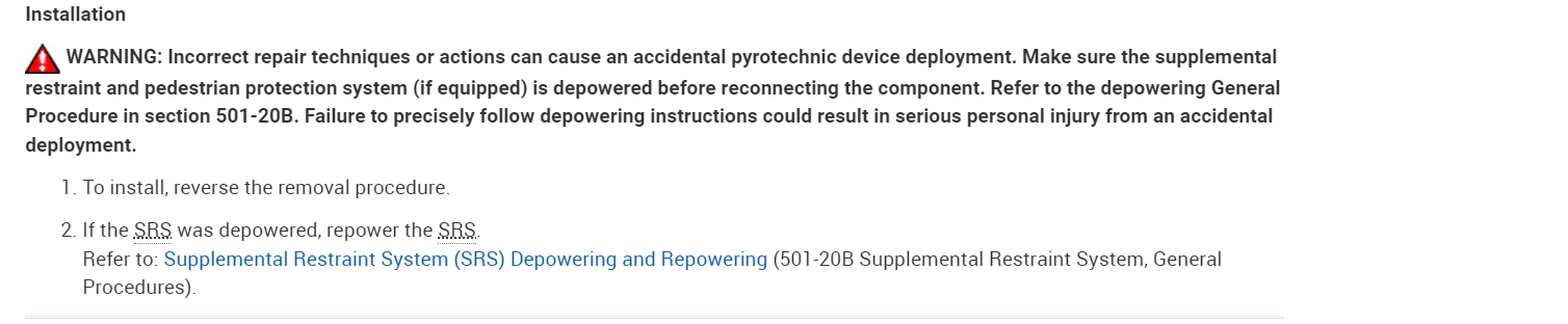

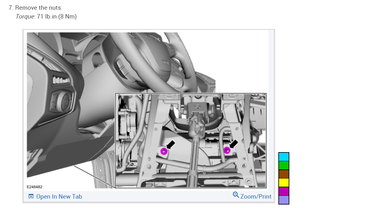

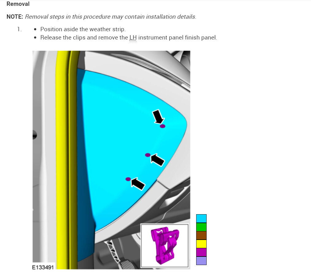

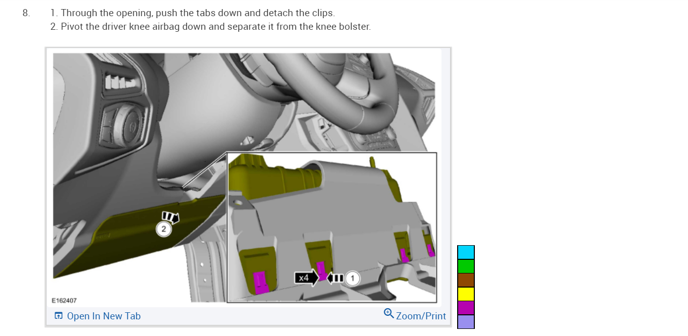

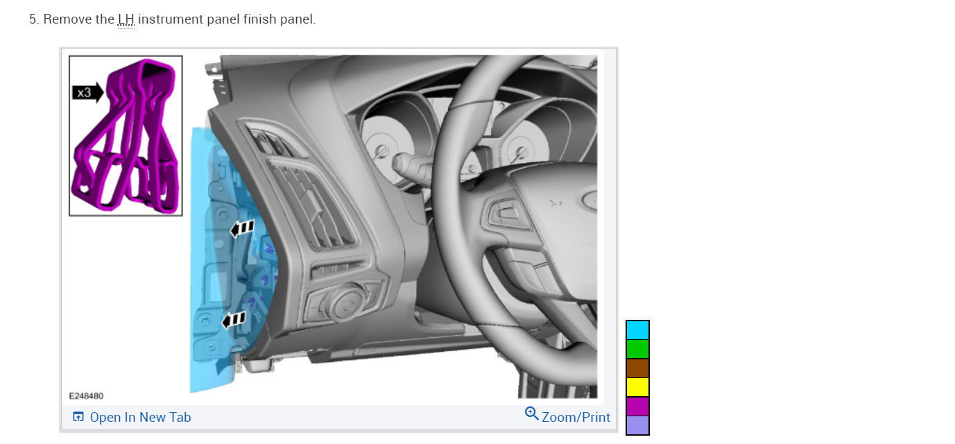

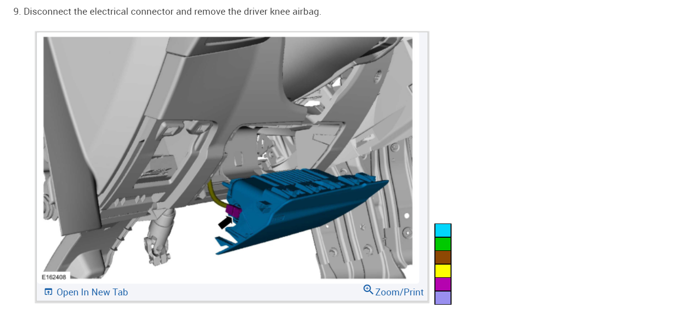

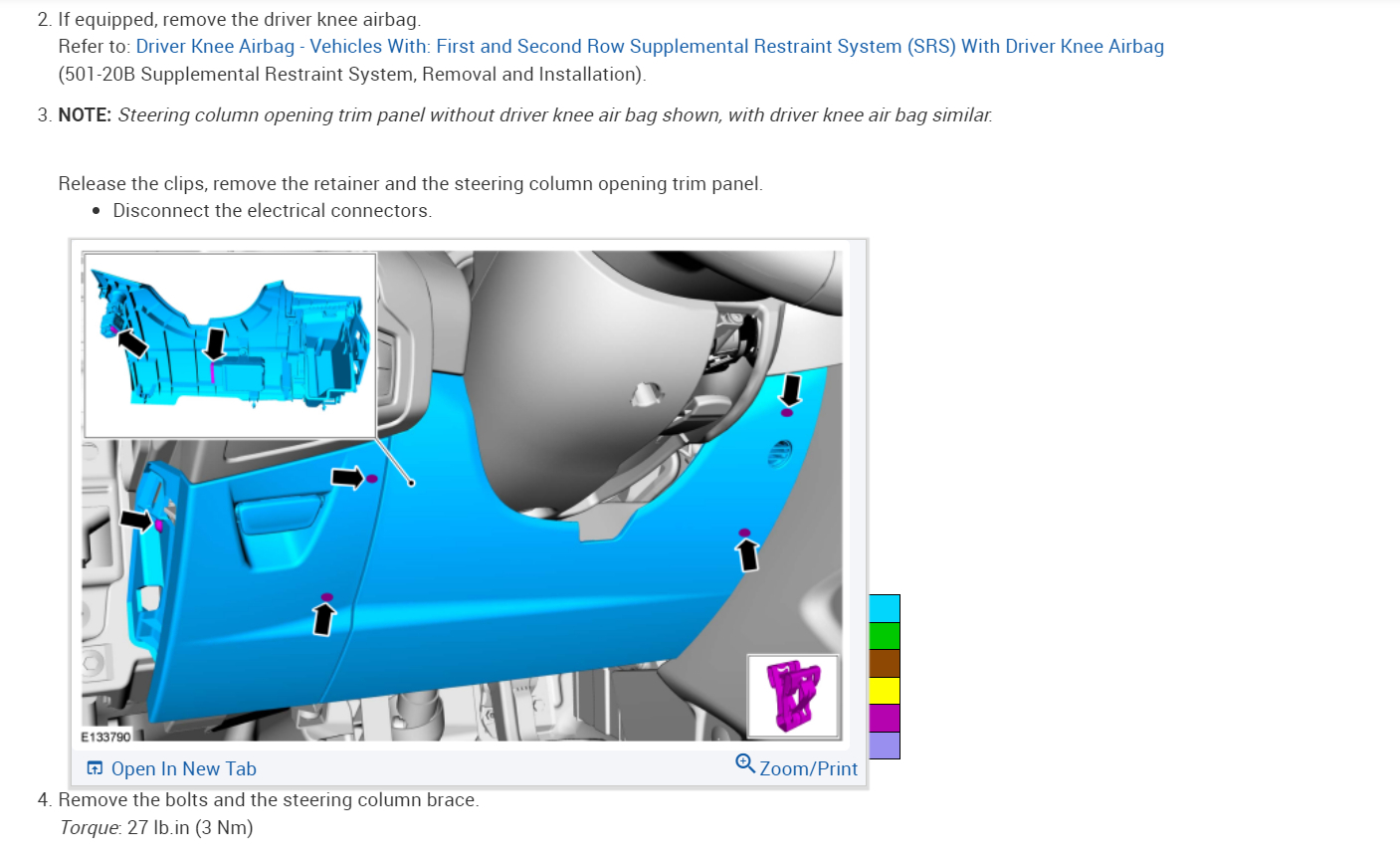

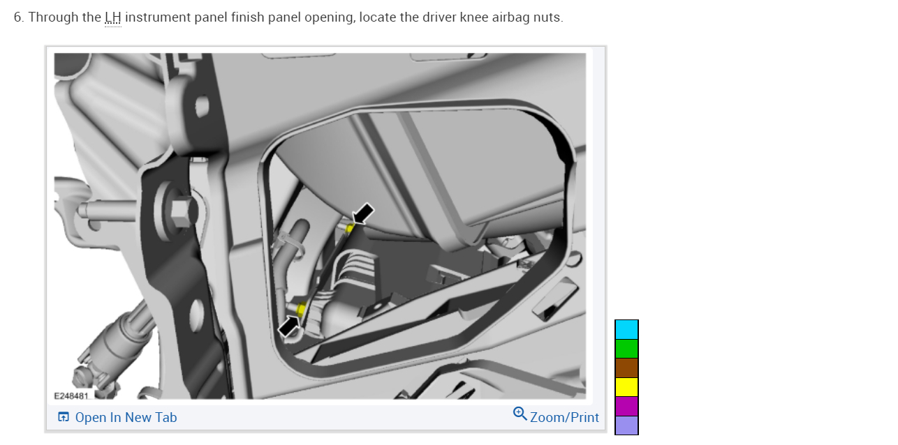

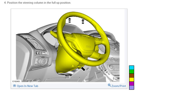

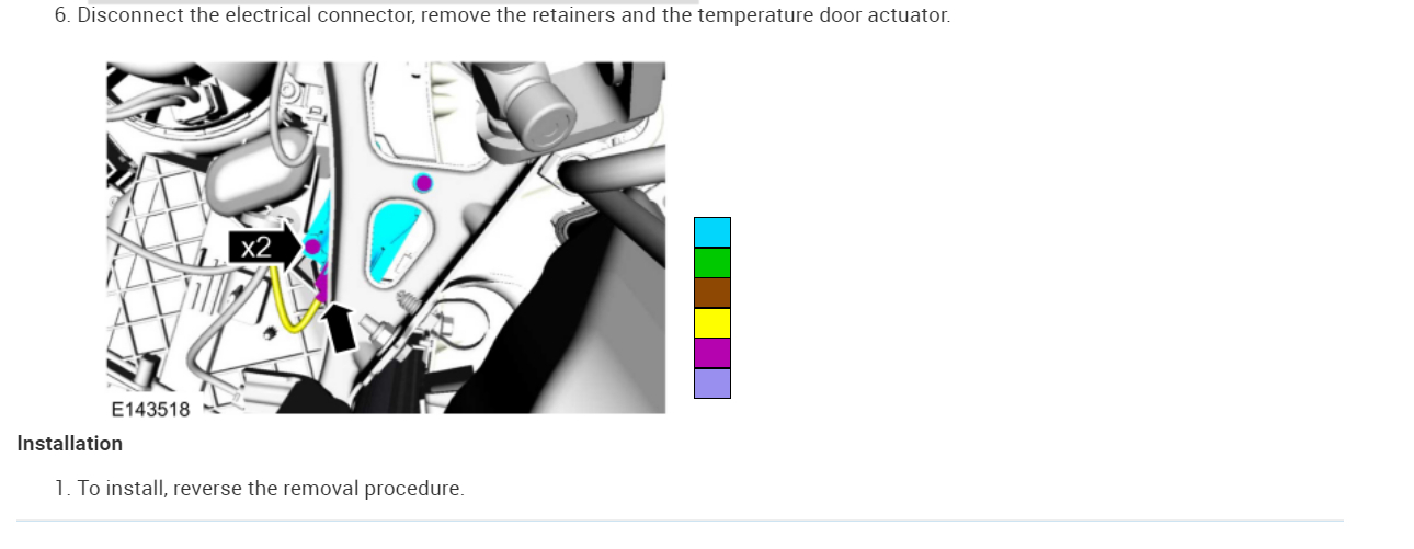

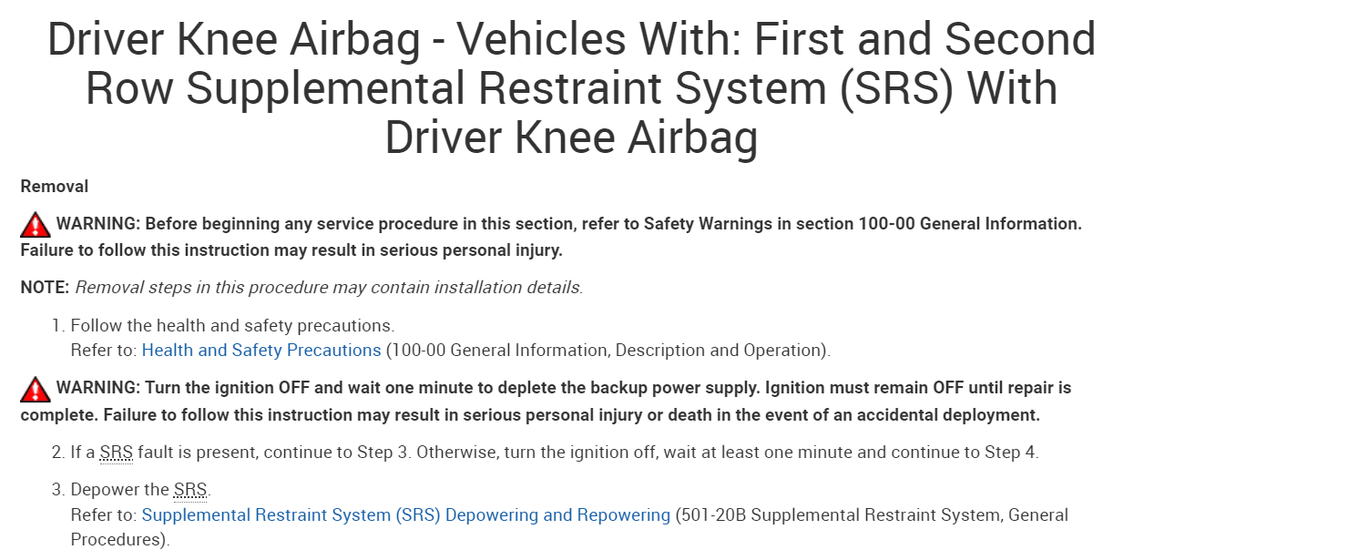

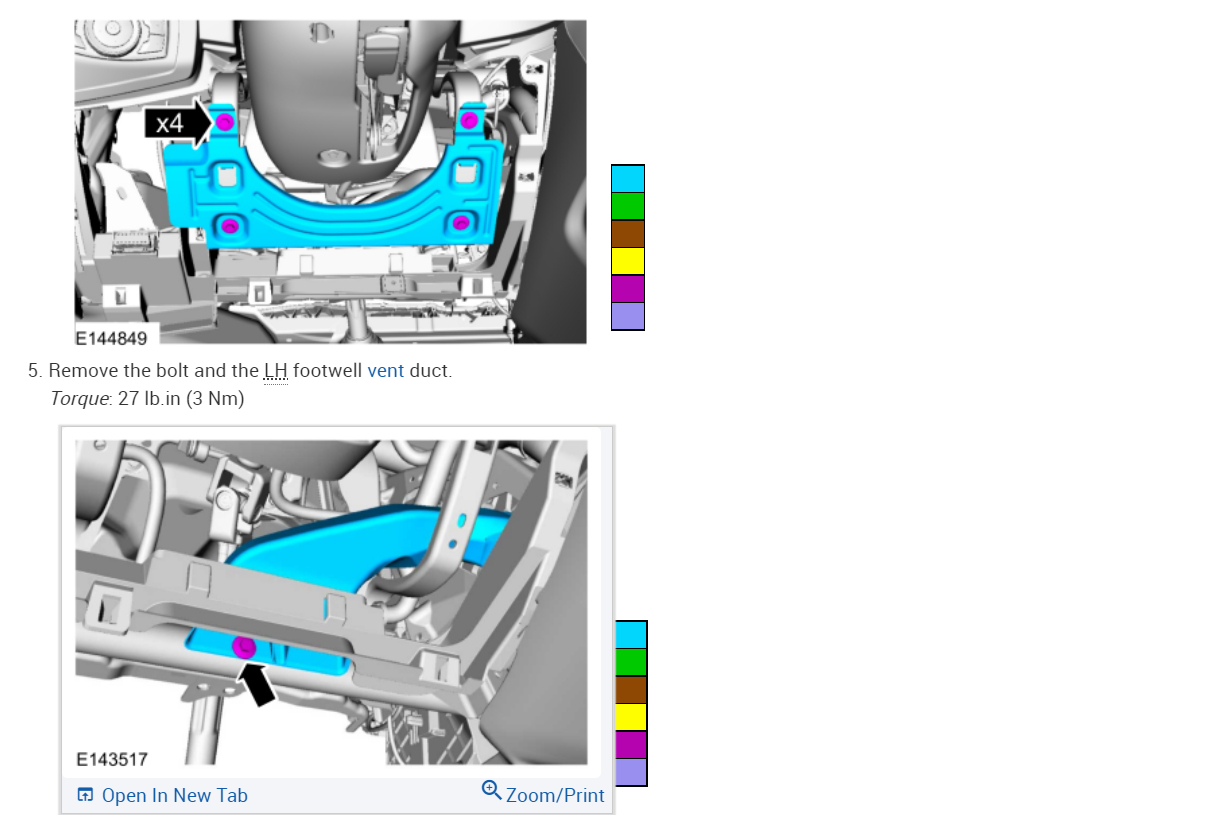

Hello, is this the Temperature Blend door you're referring to? Not the Air distribution door.
The temperature door actuator looks pretty easy, just need to be aware of any Driver Knee Airbag if it's equipped with one. I will post the knee air bag service info as well.
