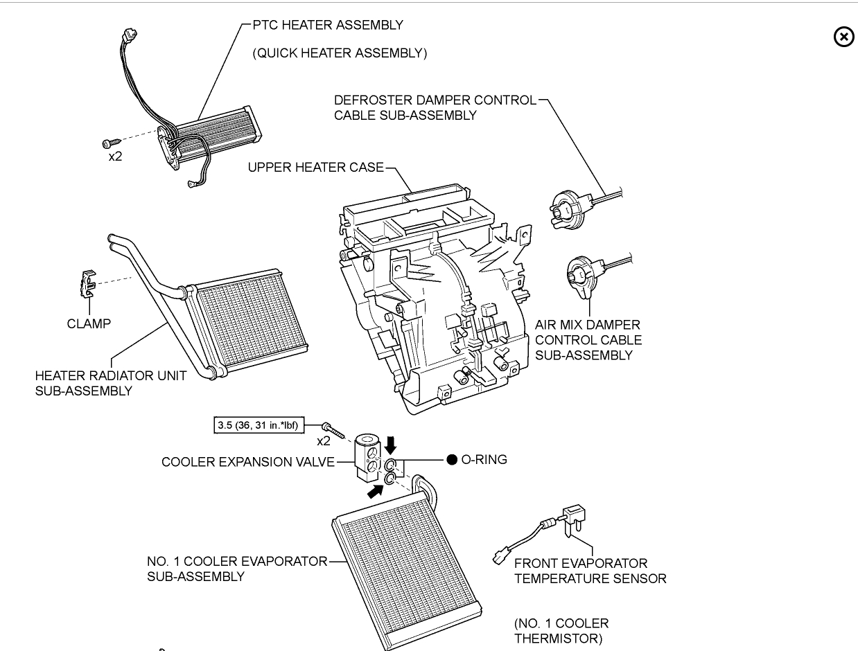

blend door is stuck on b-level all the time so A/C does not blow out the dash vents to cool the car. I was wondering where the blend door actuator was?

It seems your car does not have a blend door actuator instead there are two cables that run from the control head, one of them must be messed up. Here is a diagram to help you see what I am talking about.
