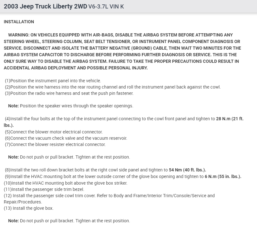

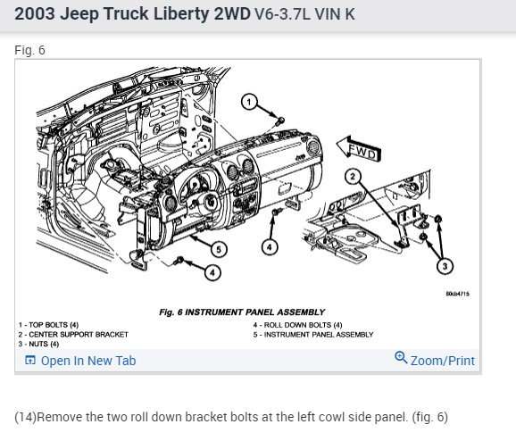

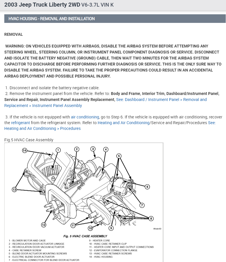

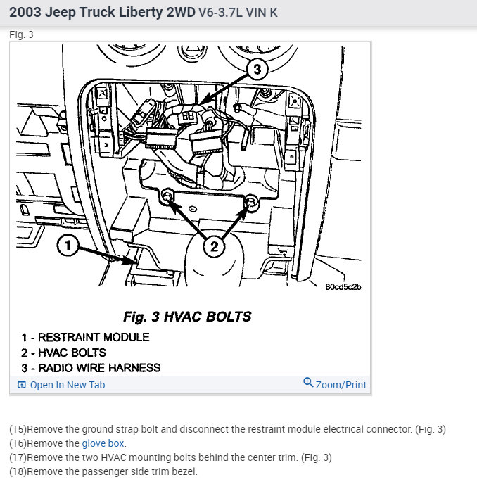

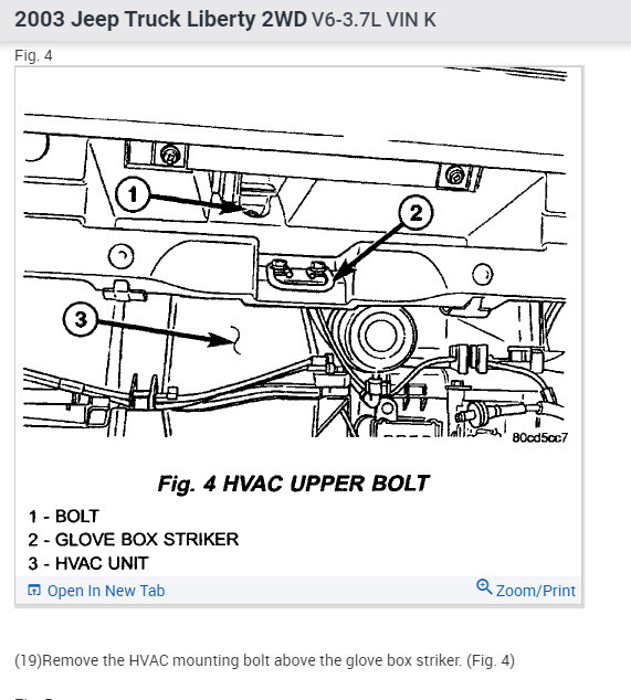

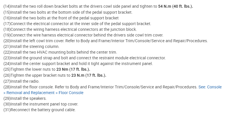

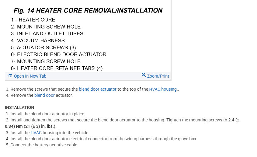

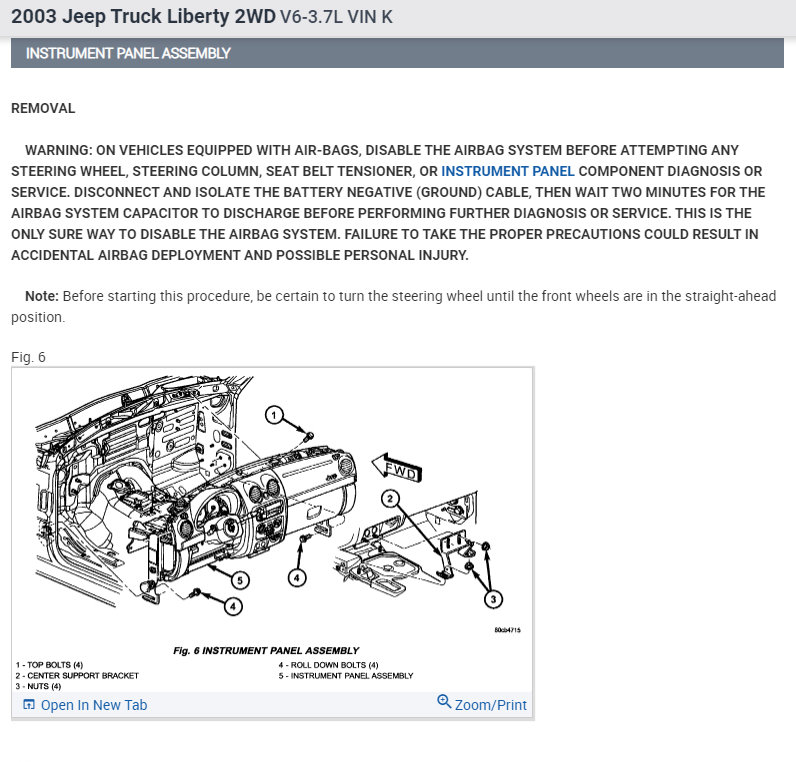

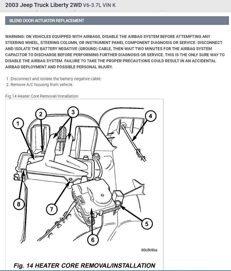

The blend door actuator is located on the HVAC box, which is located behind the dash.
In order to access it you will have to remove the dash.
I have attached the procedure below for your reference.
Let me know of any questions.
Thank you.
