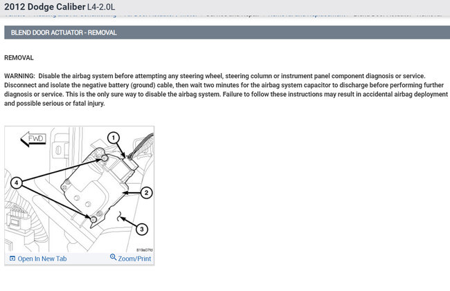

I have a clicking noise in the dash on the passenger side. I stopped by the dealer and they are saying around $700.00 to fix. They said that they believe it is the blend door actuator. I have found the part for less then $50.00, but I cannot find a video or anything on how to access it in a Caliber. I have found for an avenger. would it be the same for the Caliber or how do I access it? Your help on instructing what or how to remove glove box or whatever else I need to do to access would be wonderful. Thank you very much for your prompt attention and help. Have a great day!

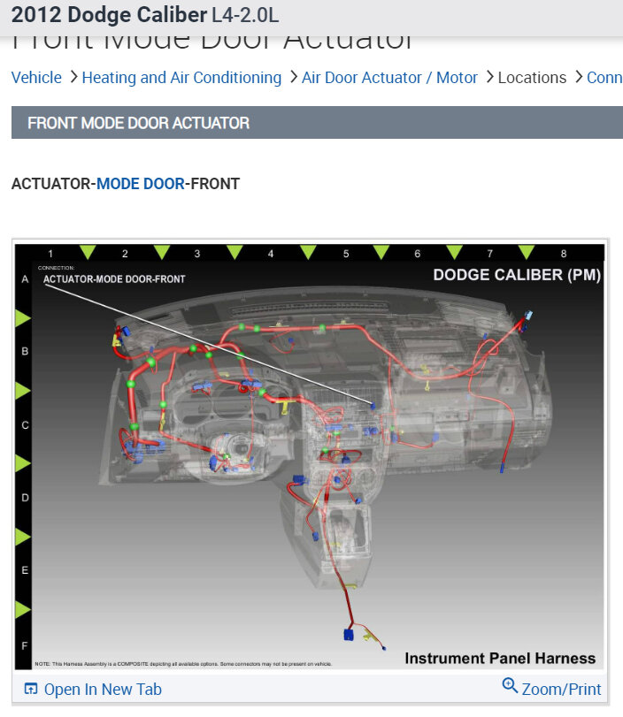

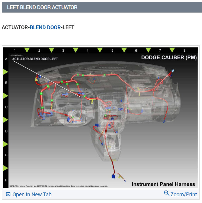

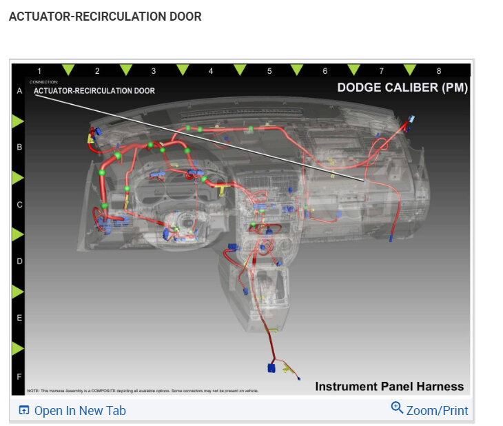

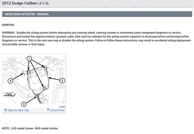

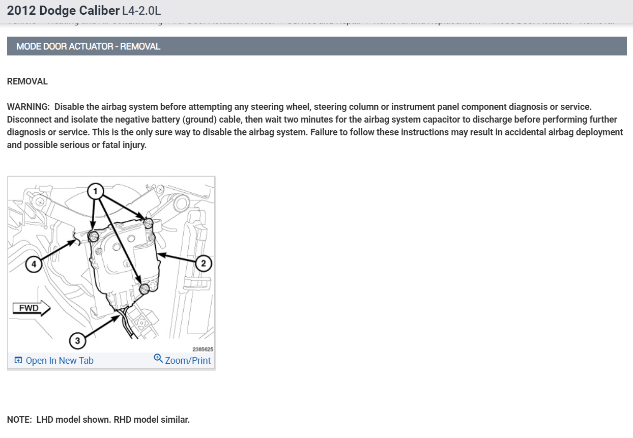

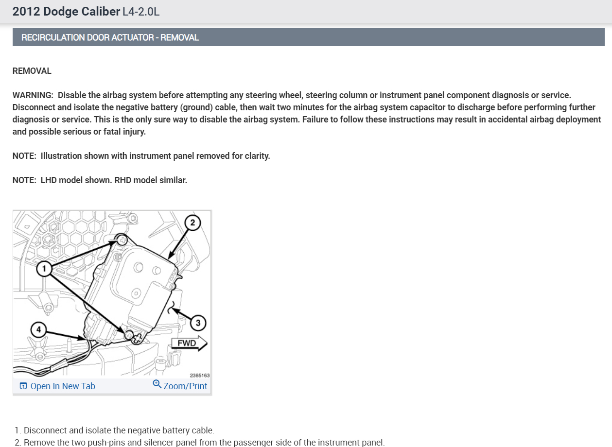

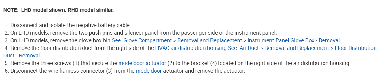

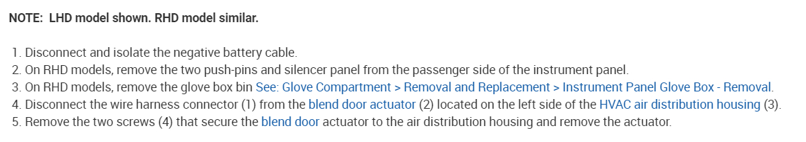

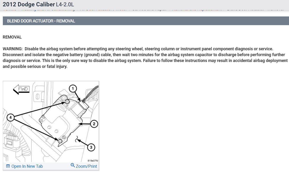

You don't say which actuator you need so here are all of them so you can do the repair. Check out the images (Below). Please let us know what happens.

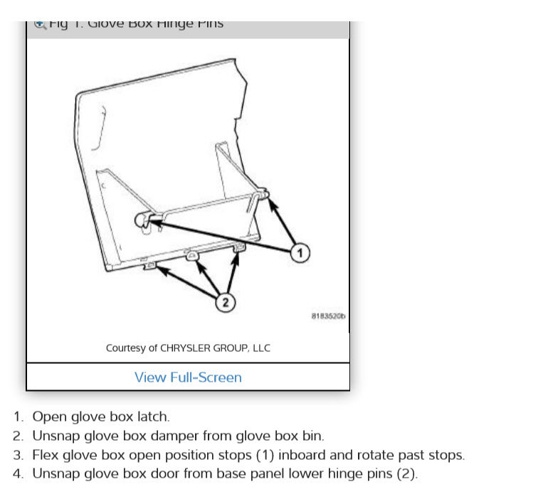

Can you please advise as to the actual removal of the glove box...it is highlighted in blue on you sheet but cannot click to go to it. Thanks for your help.
Jan 23, 2017 at 4:11 PM
HMAC300
  • 48,601 POSTS
when you get a pic form me you can't click on highlight to go to it. here is for glove box removal actually if you just undo the top pins you can probably reach the other part.
