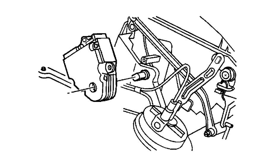

On my passenger side the air blows cold and on the driver side the air blows hot. I know I have to replace place the blend door actuator. I just want to know do I have two one on the passenger side and one on the driver side. Are I have just one behind the glove box are under the dash on the driver side.
Sep 23, 2019 at 1:12 AM
Good morning,
You have the driver's side actuator is under the left side of the dash.. Yes, there are 2 on the right side, one for that blend door and the other for mode control.
Picture attached below.
