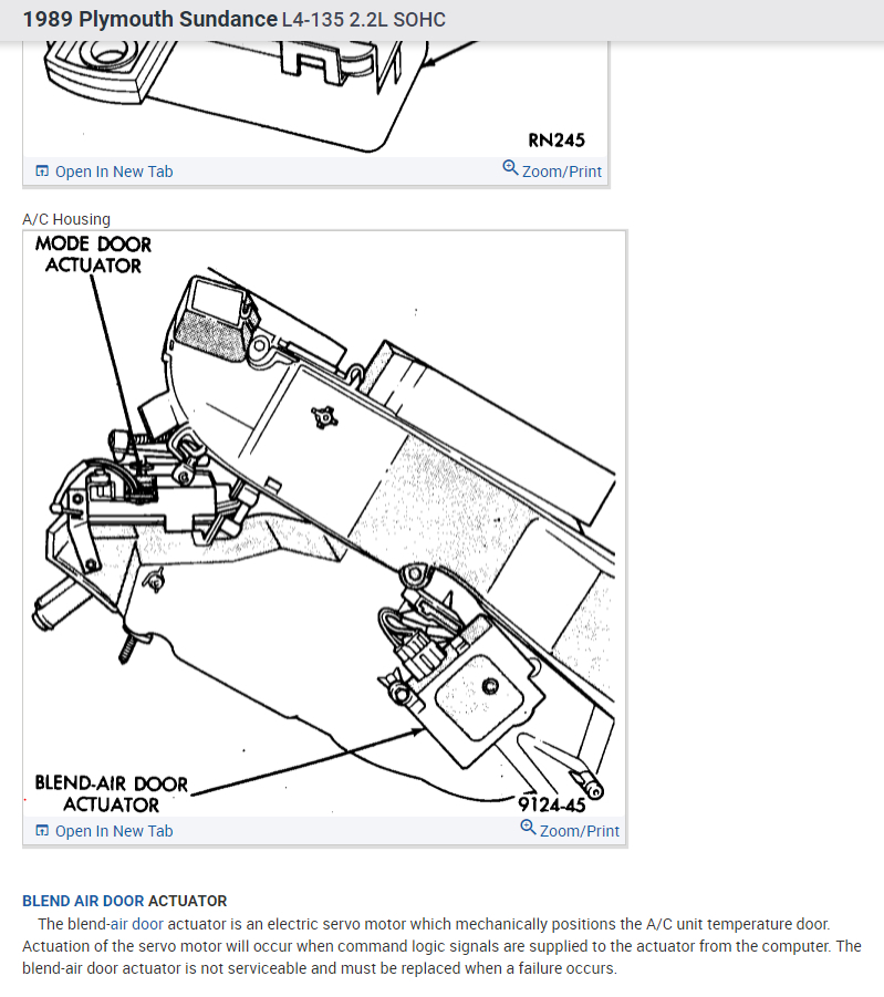

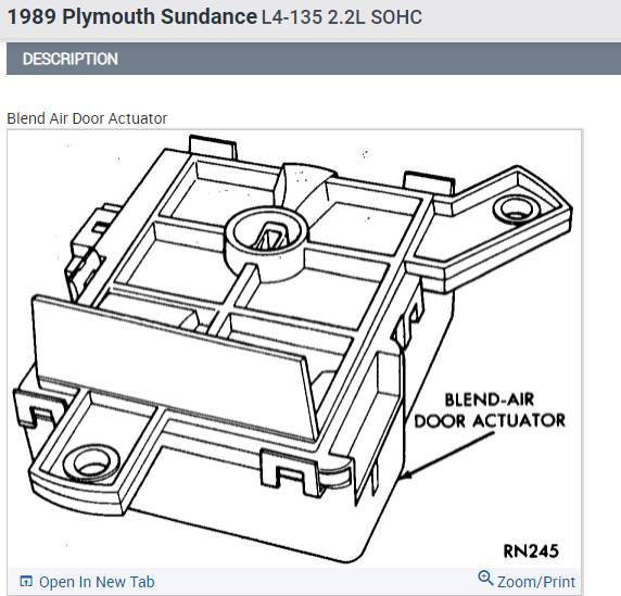

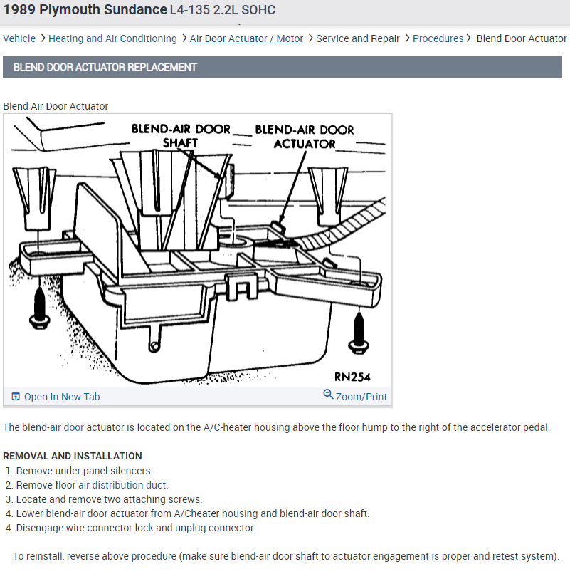

The blend door actuator is located on the A/C-heater housing above the floor hump to the right of the accelerator pedal.
I have attached diagrams for your reference. Please run through this info and let us know how you make out with it or if you need more info.
