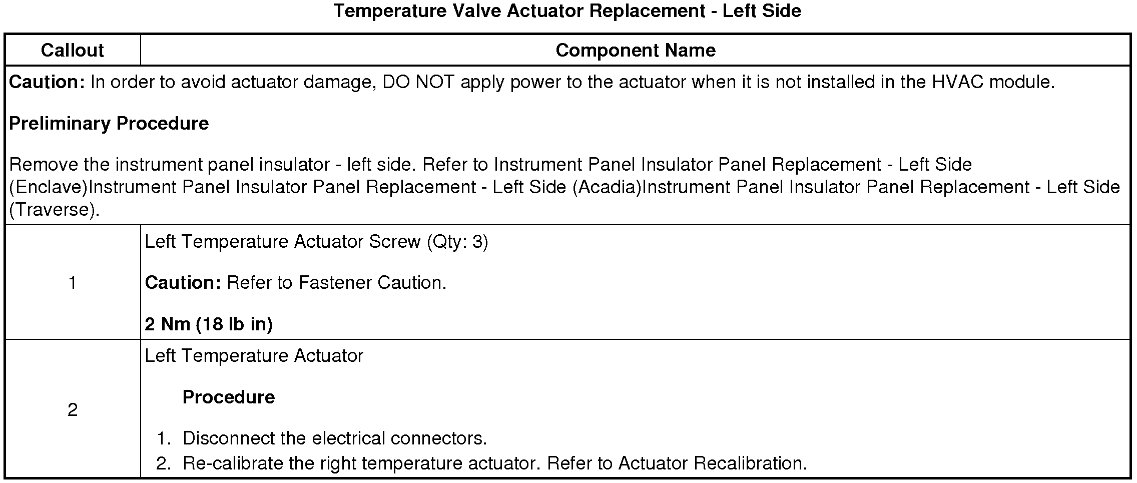

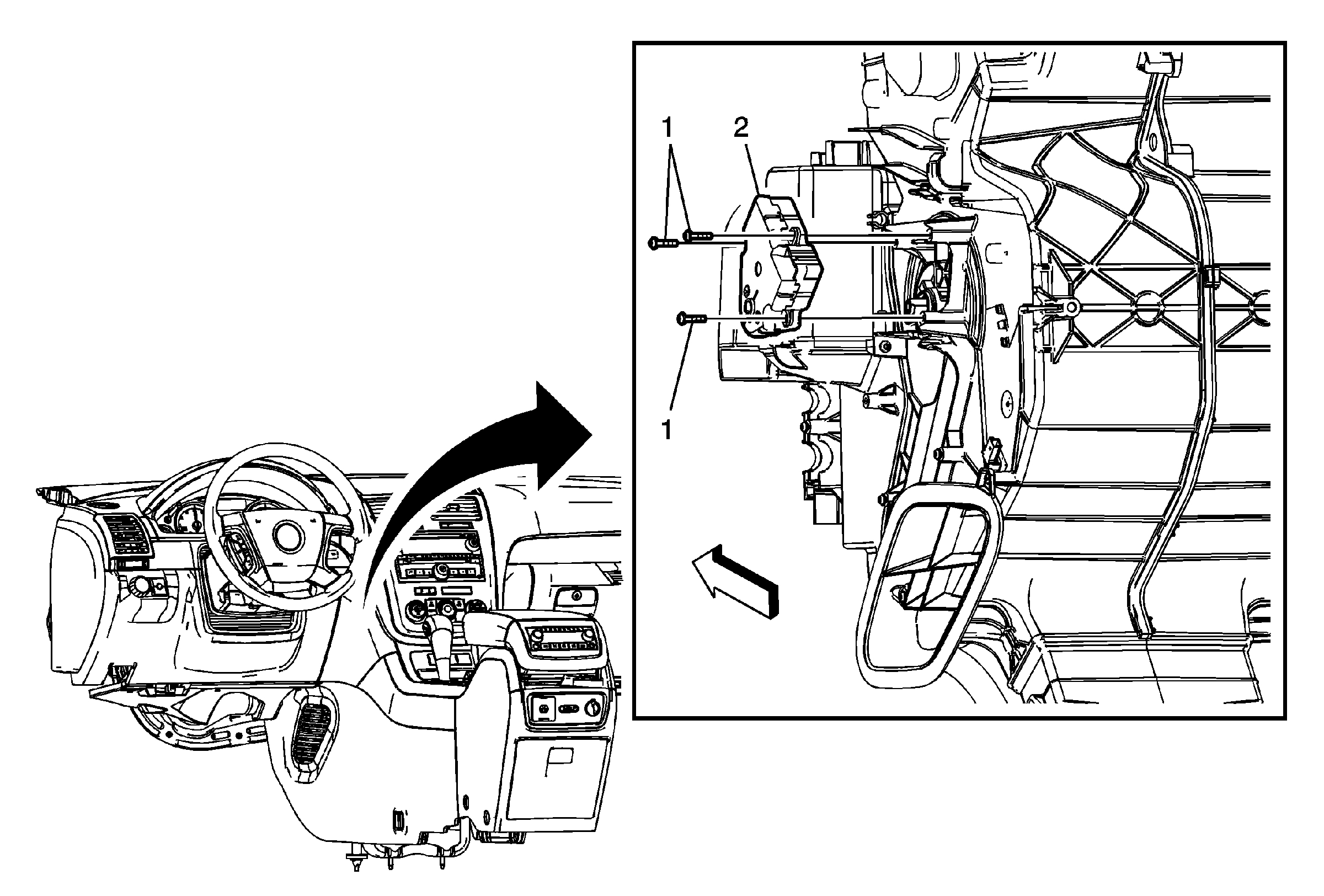

I'm not sure if you already replaced it, but the two pictures below are the directions for replacing the actuator.
Let me know if you have it taken care of.
Jun 1, 2020 at 8:19 PM
