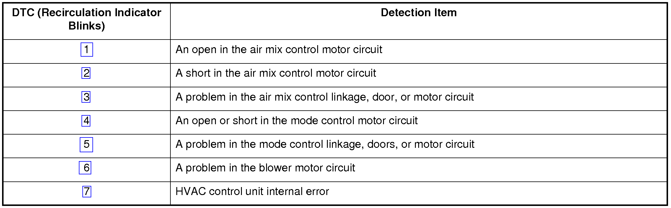

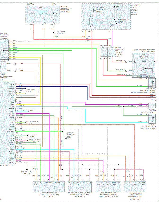

Do me a favor. Try putting it into self diagnostic. Here are the directions. The two attached pictures correlate with the directions. Also, the second pic lists what each code indicates.
I looked through the wiring schematic, and the only thing I can suspect at this point is the control unit. If you unplug the fan, can you tell if the actuator is working?

Hey Joe, it didn't look like OP responded, but I am having the same problem, I run the self diagnostic with my old blender actuator plugged in and I get 2 blinks back, meaning a short in the mixer. Then I have the same problem when I plug in a new mixer actuator the light goes off on the ventilation button, and come back and starts blowing again as soon as I unplug, which sounds like a short to me. I also purchased a tested replacement temperature control unit and have swapped that out as well.

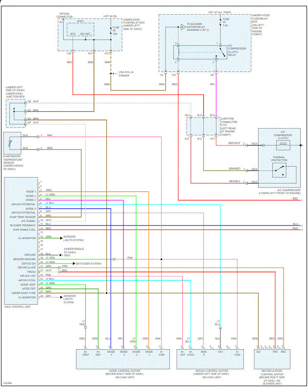

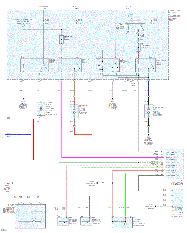

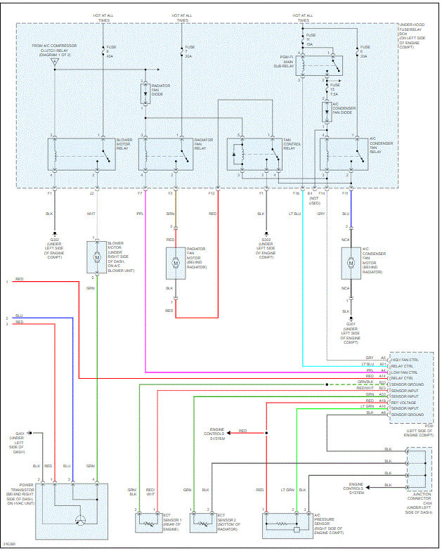

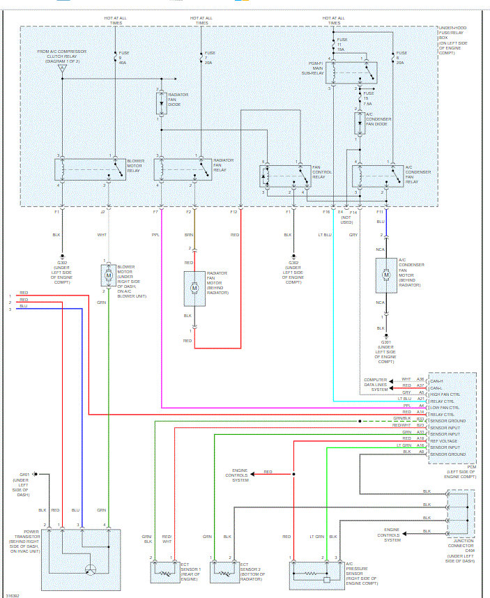

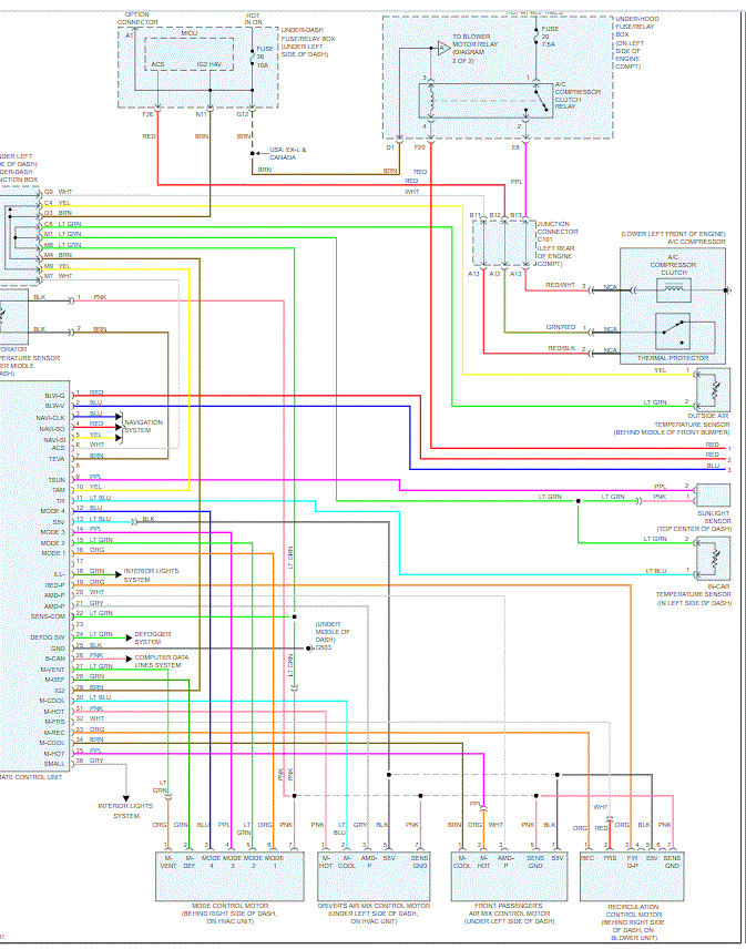

I attached pics below for the HVAC on a 2009 CRV. Just making sure your vehicle is the same year and model. Pics 1 and 2 are for manual climate control.
Pics 3 and 4 are for an automatic climate control system. I'm not sure which one you have.
