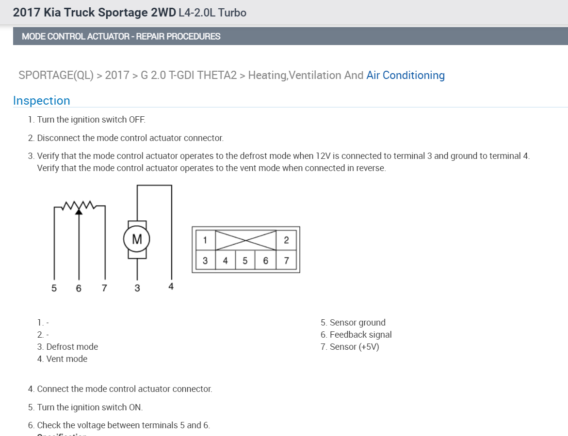

The blend door actuator behind glove box that controls heat and cold air went bad, I replaced it new lasted a few days. now it's bad again. Any suggestions on what could be my problem?
