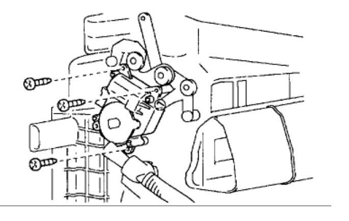

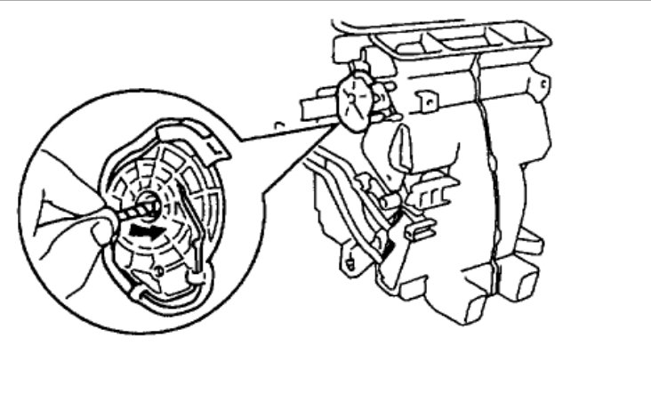

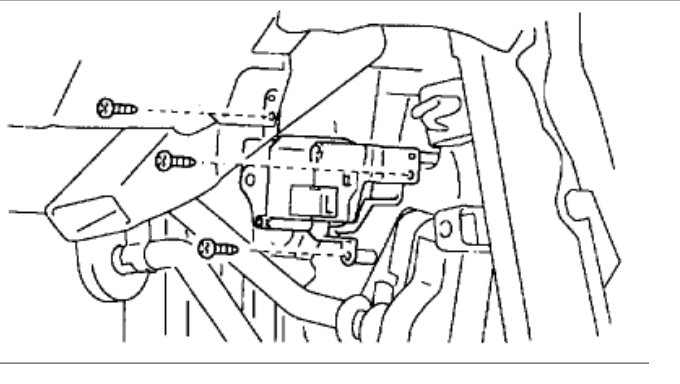

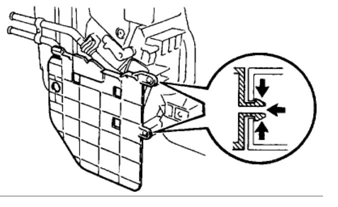

Yes the blend door actuator will cause the heater or air conditioner not to work right.
Here is a guide that will give you an idea on what you are in for when doing the job:
Here is what it will be like on your car (below) I gave both air control and temperature control actuators:
