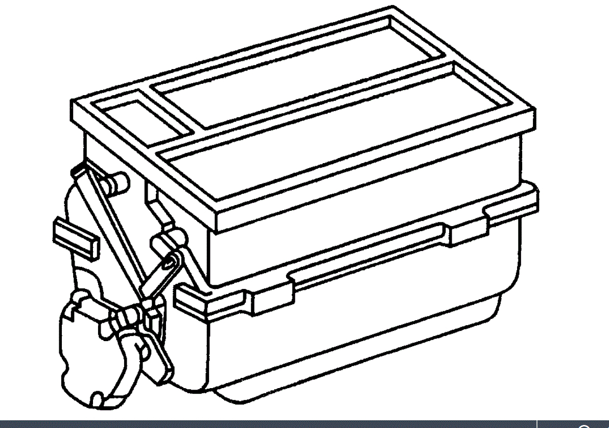

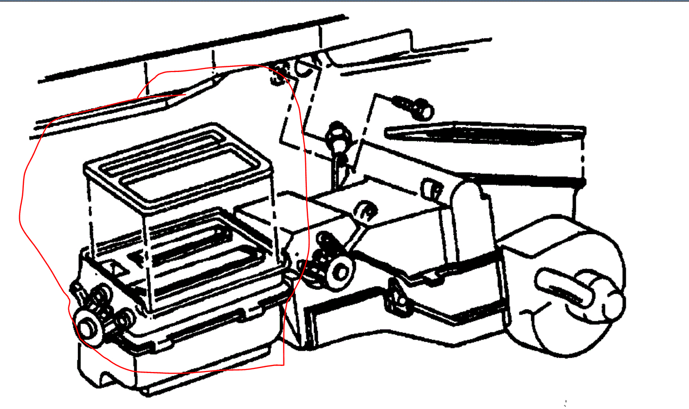

I just went through two manuals, and the only thing mentioned was the actuator. I can tell you that the door is in the air distribution case. Looking at the pic, that shouldn't be too hard to access. I attached a couple of pics below.
