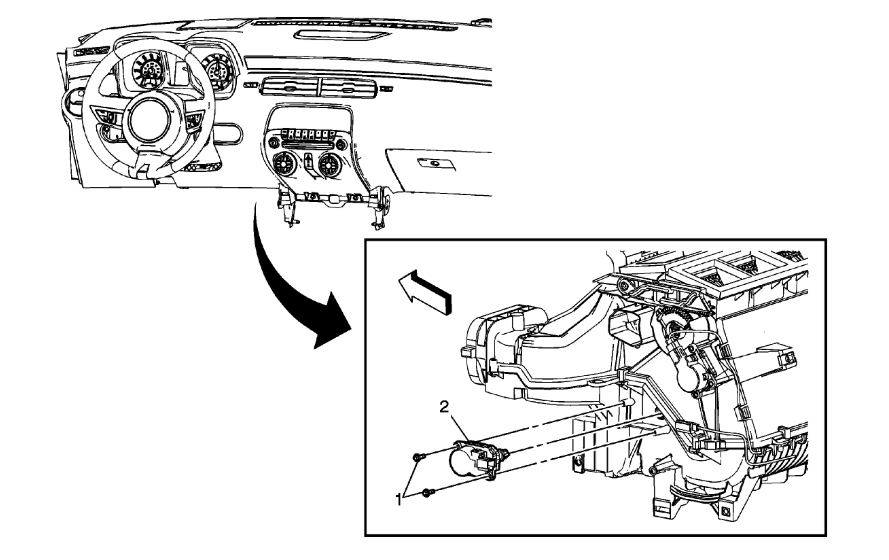

The same with the A/C. Do I have to remove the dash to repair it? And if so, where are the screws to remove the dash?
Nov 8, 2019 at 8:38 AM
CERTIFIED EXPERT
52,796 POSTS
Good morning,
Do you have dual controls for controlling heat and cold?

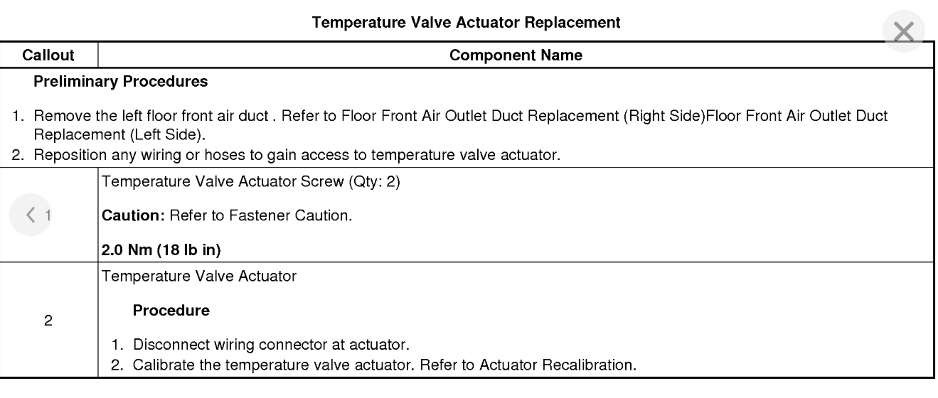

I attached the procedure and a picture for the blend door actuator but there is only one listed.
If this is the case, good chance the heater core could be clogged with debris in part of the core itself.
