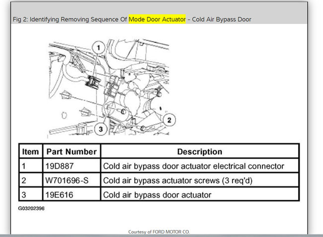

Hello, which blend door actuator, controls the main hot to cold and vice versa.
Jul 8, 2019 at 3:00 AM
SCGRANTURISMO
  • 4,897 POSTS

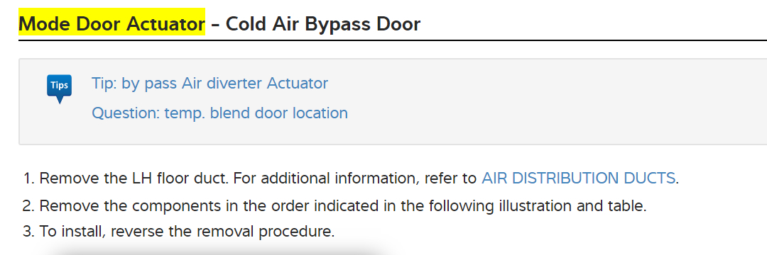

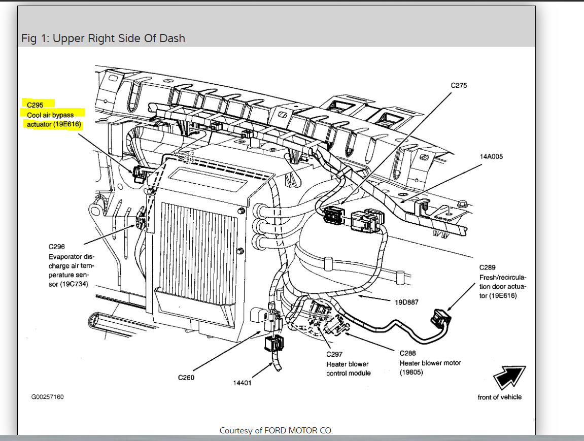

I have included the information that you requested in the diagrams down below. I have included a diagram with the actuators location and factory instructions on the removal and installation of the actuator. Here is a link for you to go to also:
Please go through these guides and get back to us with what you are able to find out.
