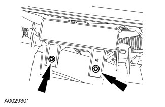

Vehicles with anti-theft/key-less entry:
4.Remove the screws and position aside the anti-theft/keyless entry module.
Fig 1: Removing anti-theft/Key-less module.

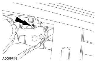

5.Working through the opening near the RH defroster nozzle, remove the screw.
Fig 2: Removing screw near right hand defroster nozzle.

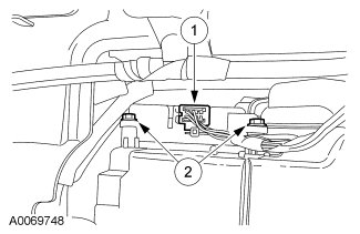

6.Remove the temperature blend door actuator.1.Disconnect the electrical connector.
2.Remove the screws and the temperature blend door actuator.
Fig 3: Removing temperature blend door actuator.
