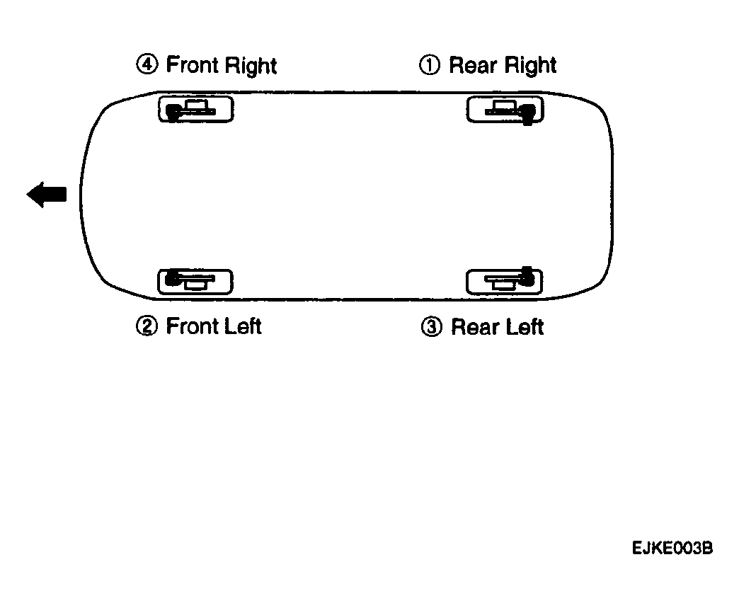

If I bleed the ABS module with a scan tool do I need to bleed my lines at the calipers also?
Jul 19, 2018 at 12:36 PM
Hi and thanks for using 2CarPros. Com.
I recommend bleeding each wheel to confirm air hasn't gotten into the system. Just make sure to start with the right rear and work left front, left rear, right front. I have attached a picture which indicates the process.
https://www.2carpros.com/articles/how-to-bleed-or-flush-a-car-brake-system
Let me know if you have other questions. I hope this helps. Check out the diagrams (Below). Please let us know what happens.
