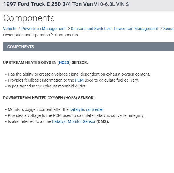

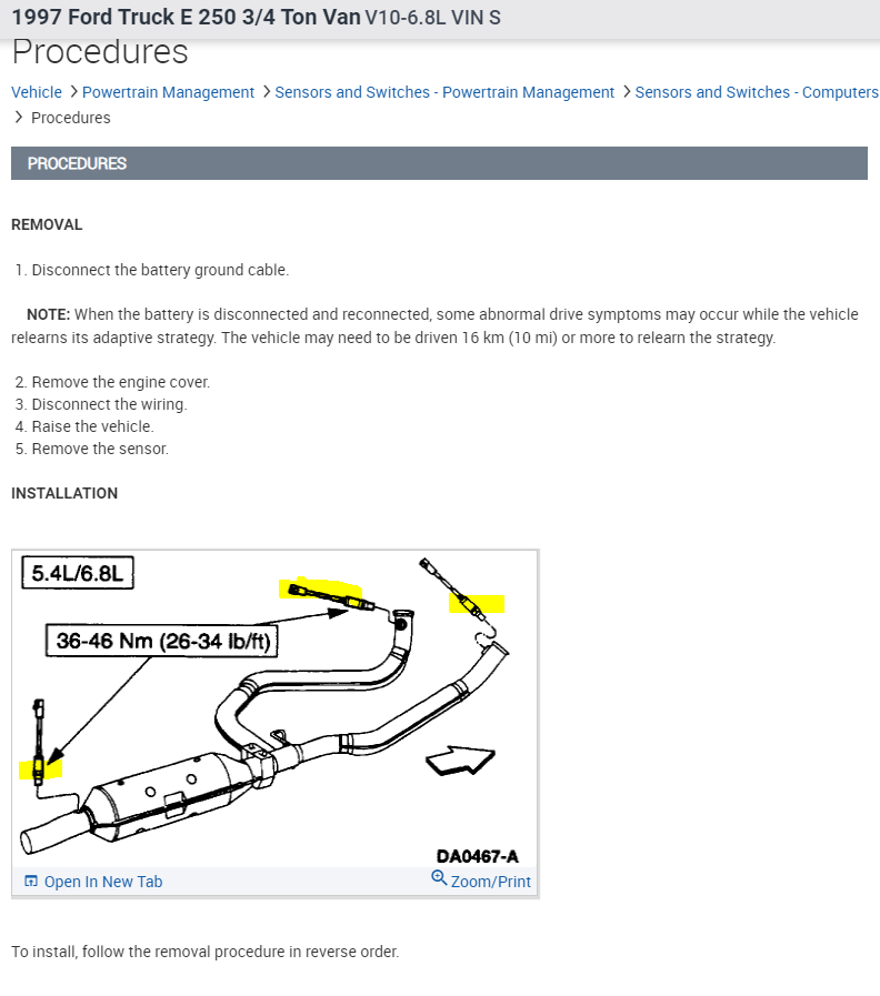

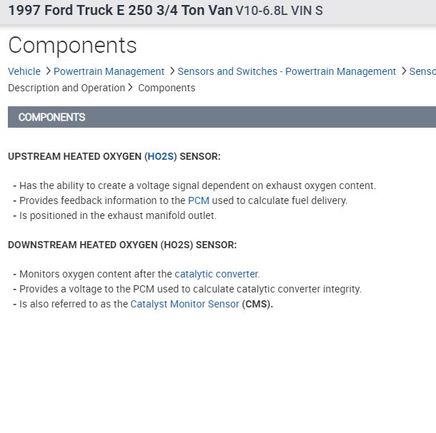

This V10 should have three oxygen sensors. See diagram below for the location.
The best course of action would be to take a look at the guide and go through the possibilities to find the issue. This way you are not replacing a part that does not need to be replaced.
