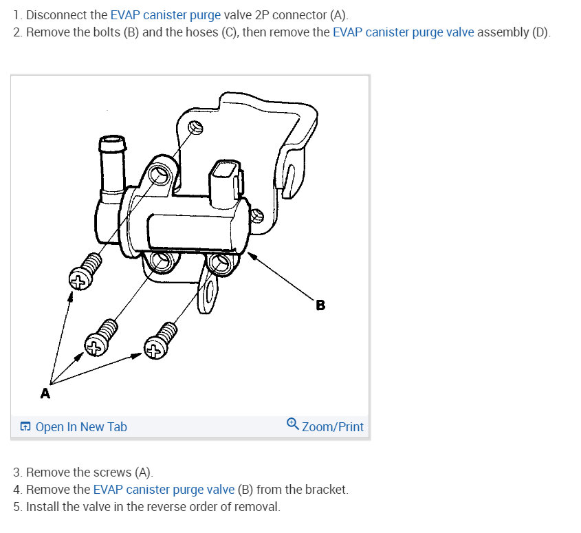

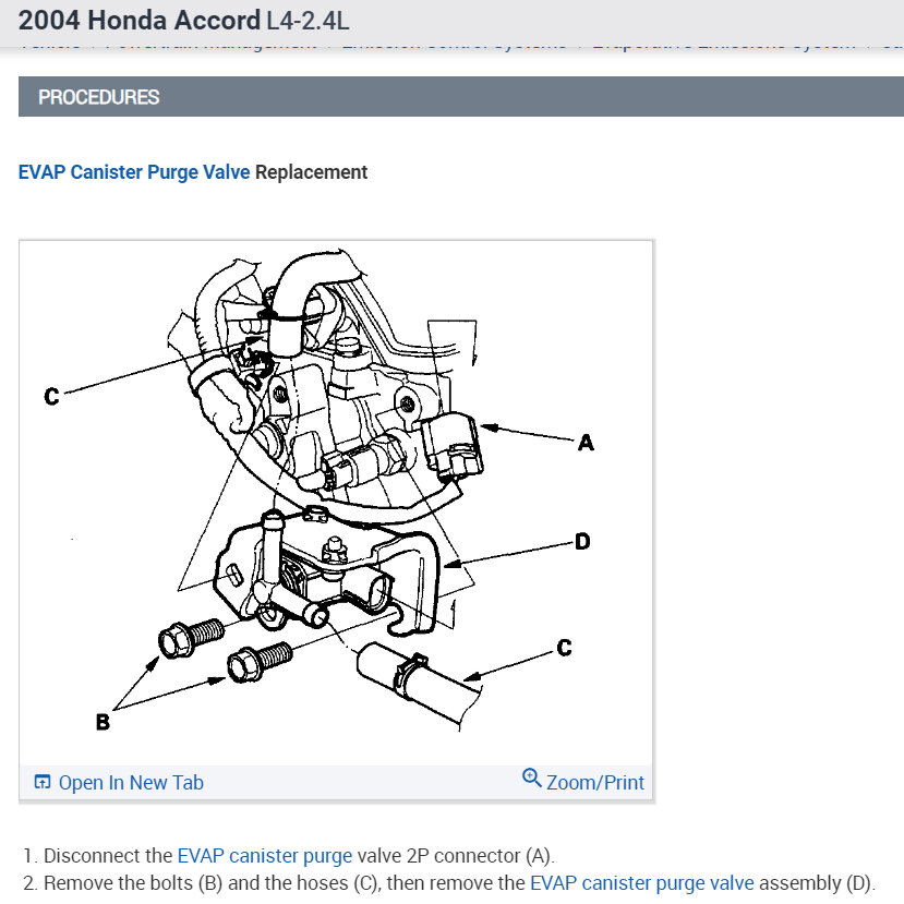

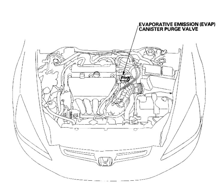

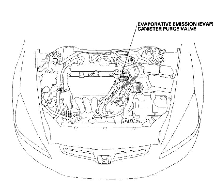

I have seen the EVAP purge stick open which can suck fuel into the engine, but I need to ask if there are any codes?
Here is the location of the purge valve. Please remove it to see if you can blow through it, if so, the valve is bad and needs to be replaced. Check out the images (below). Please let us know how it goes.
