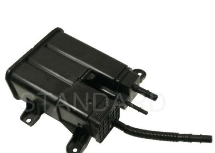

it's probably your evap canister there shold be a bracket above it where it shold connect or slide in.

That part looks nothing like what is hanging down on my truck :(

3 out of 4 screw holes are busted... I went through a huge puddle cuz the highway was flooded as a result of some severe thunderstorms and I am guessing the pressure from the water blew it off. I looked up that part on Advanceautoparts.com website and it doesnt look anything like it... Any other suggestions?

if it looks similar to the pic I'm sending it's the evap canister it has 4 bolts holding it on. you should never drive through water deeper than a couple of inches.
