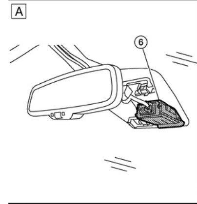

What is the black box next to the inside rear view mirror, proximity warning?
Nov 16, 2020 at 10:15 AM
BMDOUBLE
  • 1,139 POSTS

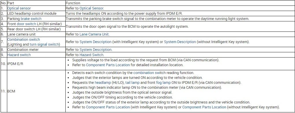

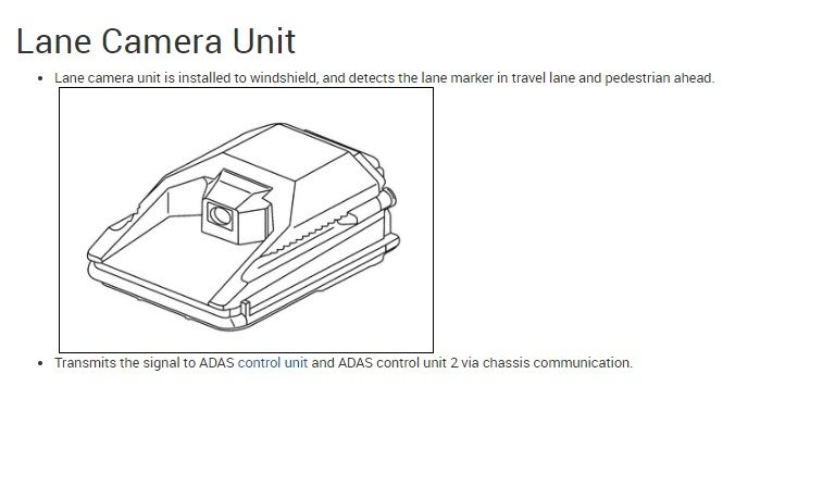

It is the Lane camera unit. Here is a picture with a chart.

My car was stolen. Without replacing this unit will I have any problems with the operation of the vehicle?
Gus Stavros
Nov 16, 2020 at 12:04 PM
BMDOUBLE
  • 1,139 POSTS
The lane keep system will be disabled, and there will be various trouble codes spread throughout other modules, but should not affect the overall basic functions of the vehicle.

It should not affect lighting in any way though correct?
Gus Stavros
Nov 16, 2020 at 12:12 PM
GSTAVR
  • 5 POSTS
Will it effect anything else and will it trigger a light on the dashboard?
Nov 16, 2020 at 12:15 PM
BMDOUBLE
  • 1,139 POSTS
It should not affect lighting because that system has it's own optical sensor. You will have a warning light or lights depending on what systems your vehicle is equipped with. You will not have forward emergency braking (FEB) operation and lane control.

Is it a plug and play or does it have to go to dealer to be programmed if I decide to get a replacement?
Gus Stavros
Nov 16, 2020 at 3:37 PM
GSTAVR
  • 5 POSTS
Is it plug and play or has to be programmed if I decide to replace it ?
Nov 16, 2020 at 4:16 PM
If you are replacing the lane/camera unit, it should be plug and play.
