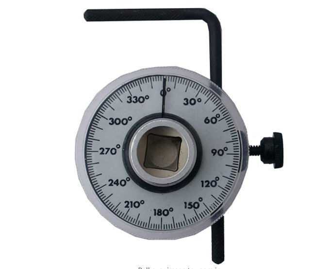

Please ensure that you fit new conrod cap bolts.
Tightening torque is
25Nm initial torque
Using an angle gauge tighten the nuts to another 45 degrees
See below for a picture of an angle gauge.

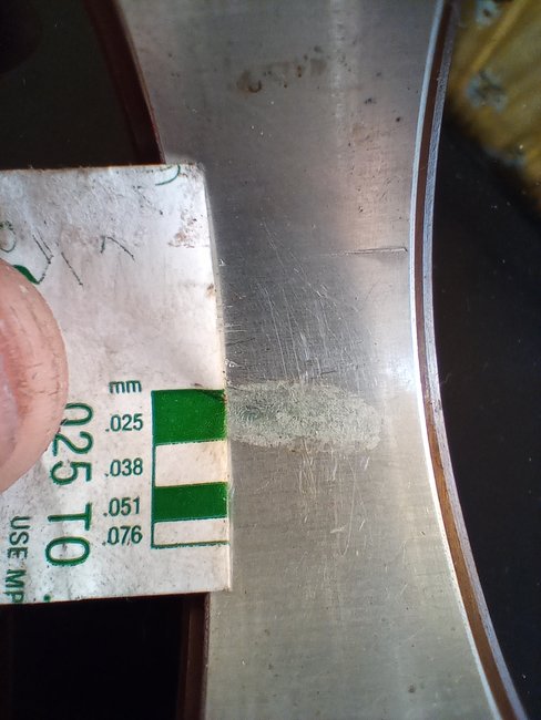

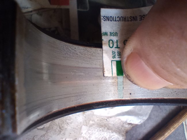

Too tight right.
May 24, 2021 at 3:39 AM
Yes too tight, I would redo the measurement after cleaning the bearing backside and block/rod remember the measurement must be done dry. let us know.

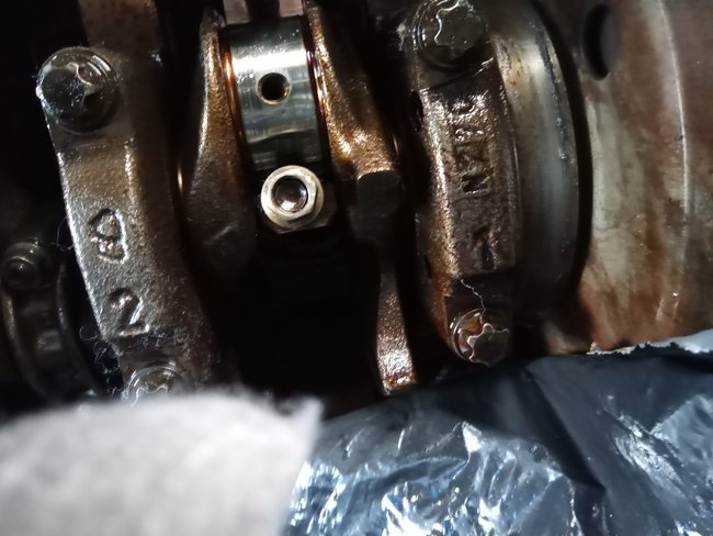

Main bearing present original.
May 27, 2021 at 11:54 PM
the bearing looks worn how is the crank side?

What size bearings are you using?
Standard or oversize?
Also please measure the crankshaft main and big end journal diameters.
If unsure take the crankshaft to a reputable engineering/machine shop to have the diameters measured. They can then advise as to which size bearings should be used or if the crankshaft needs to be machined to the next undersize to accommodate a new set of bearings.
