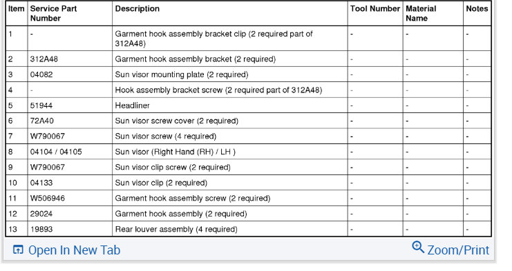

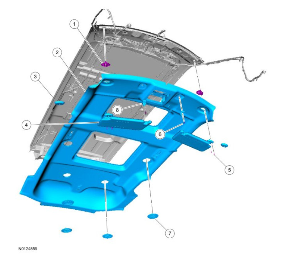

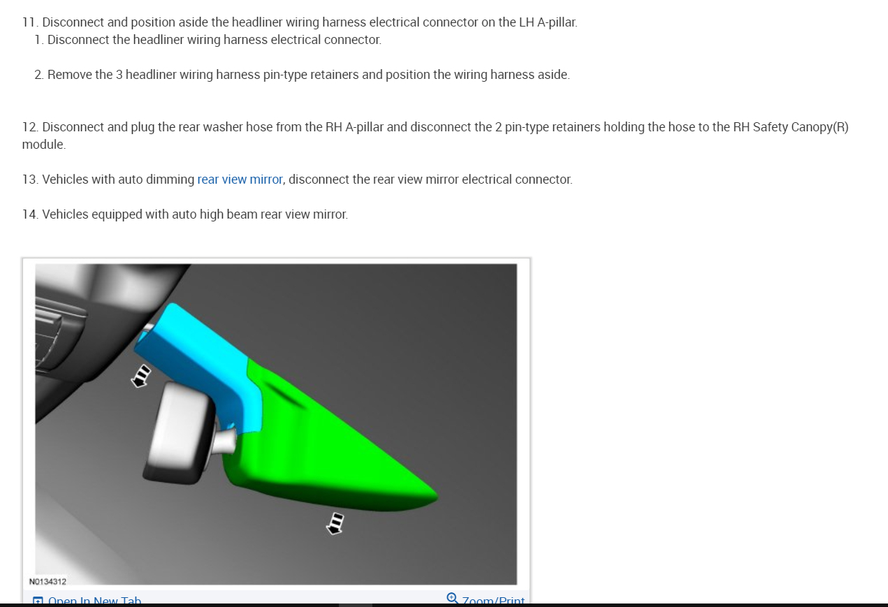

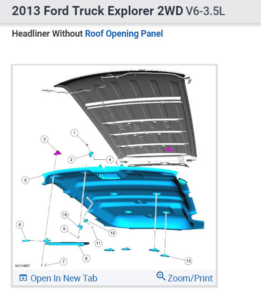

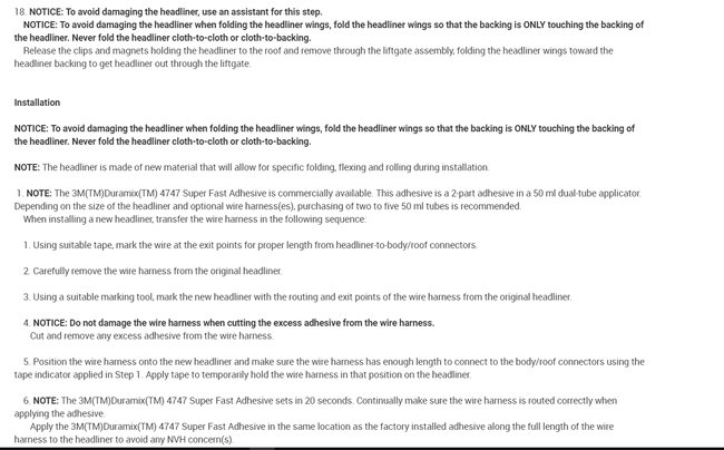

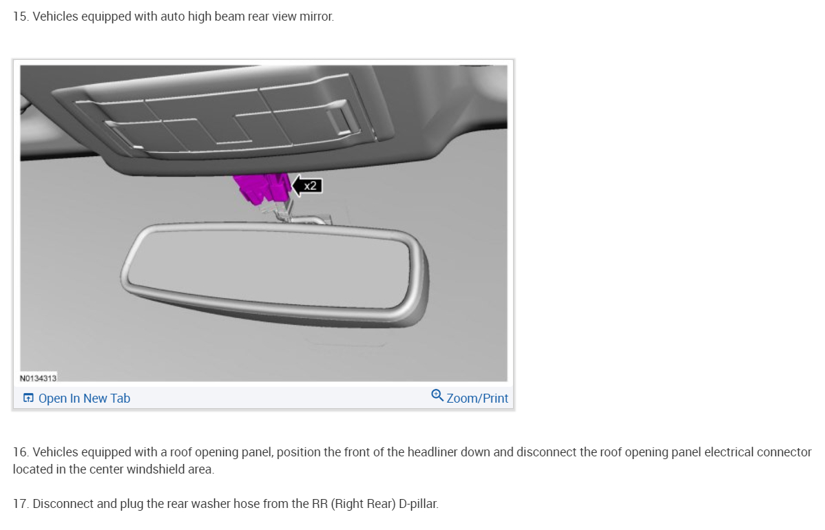

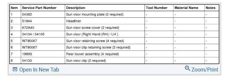

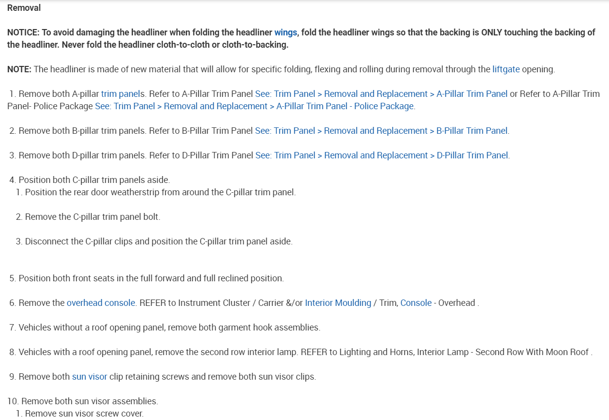

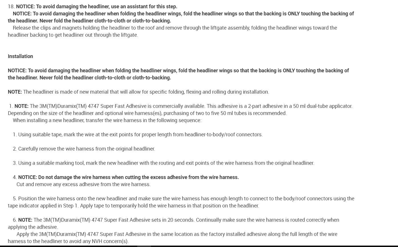

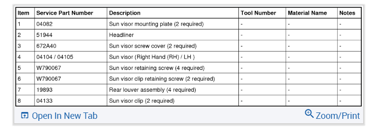

Not to sure about the big 3 maybe you can give a picture or something but I did find out how to remove the headliner. Check out the diagrams (below). Please let us know if you need anything else to get the problem fixed.
