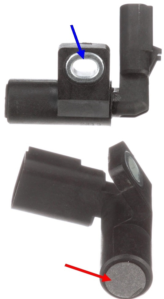

On your engine, the crankshaft position sensor uses a different style of mounting ear that sets the air gap automatically. The camshaft position sensor is a different story. In the photo below, my blue arrow is pointing to the oval mounting hole that allows for the adjustment. The red arrow is pointing to the paper spacer that sets the air gap. When you installed the replacement sensor, if the paper spacer wasn't there, or the sensor didn't get pushed in all the way, the air gap can be too big. That will decrease the size of the signal being developed, possibly to the point the Engine Computer can't read it. In response, it turns off the automatic shutdown, (ASD) relay. That relay sends 12 volts to the injectors, ignition coils, alternator field, and fuel pump or fuel pump relay.
