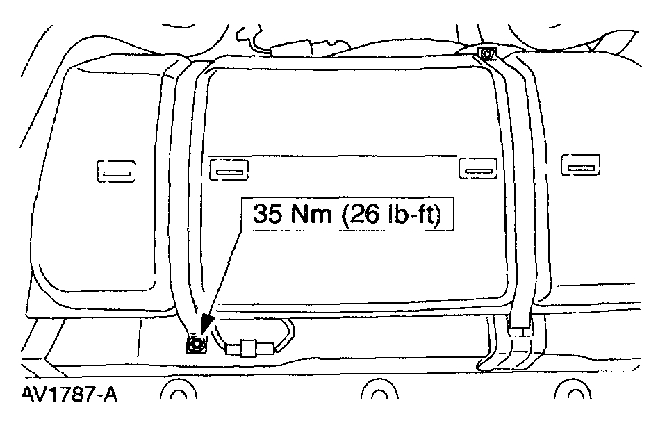

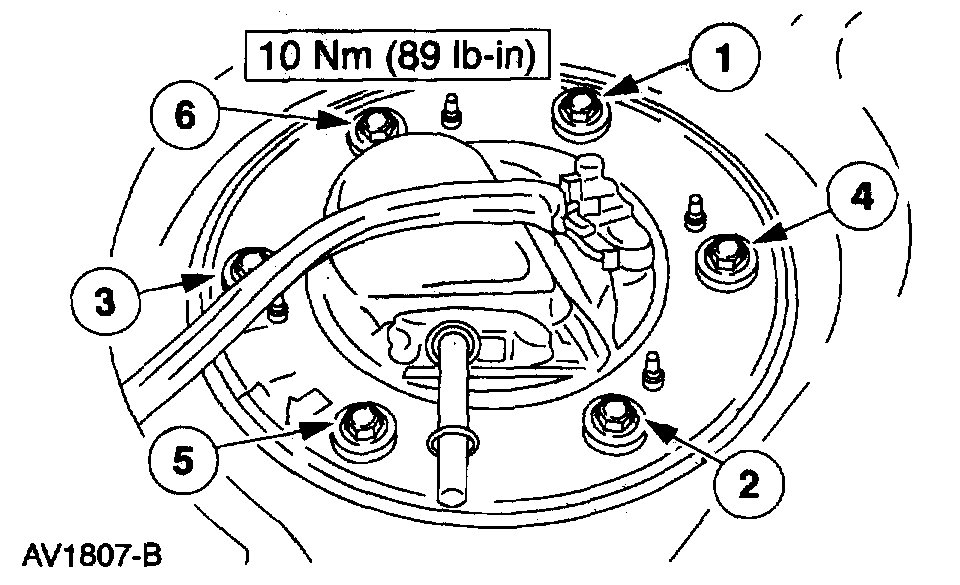

2. Remove the module assembly flange bolts.
NOTE: For installation, tighten the bolts in the sequence shown.
3. Clean the area around the fuel delivery module mounting flange.
pic 2

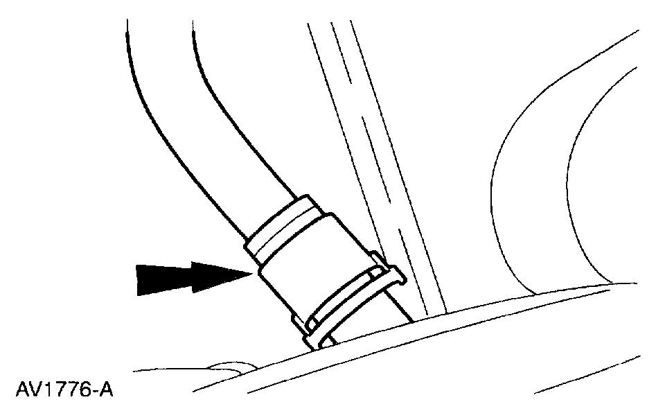

pic 4

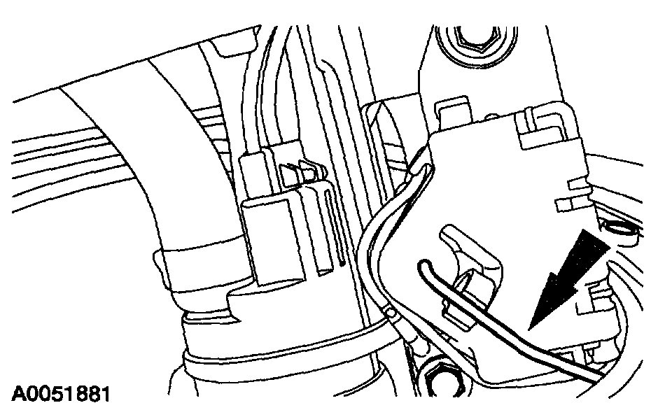

5. Remove the filler pipe bolt and disconnect the filler pipe hose connections to the fuel tank.

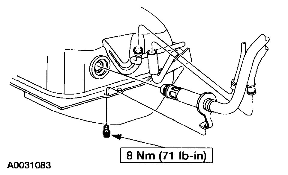

pic 5

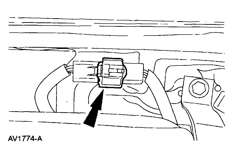

6. Disconnect the fuel tank electrical connector.

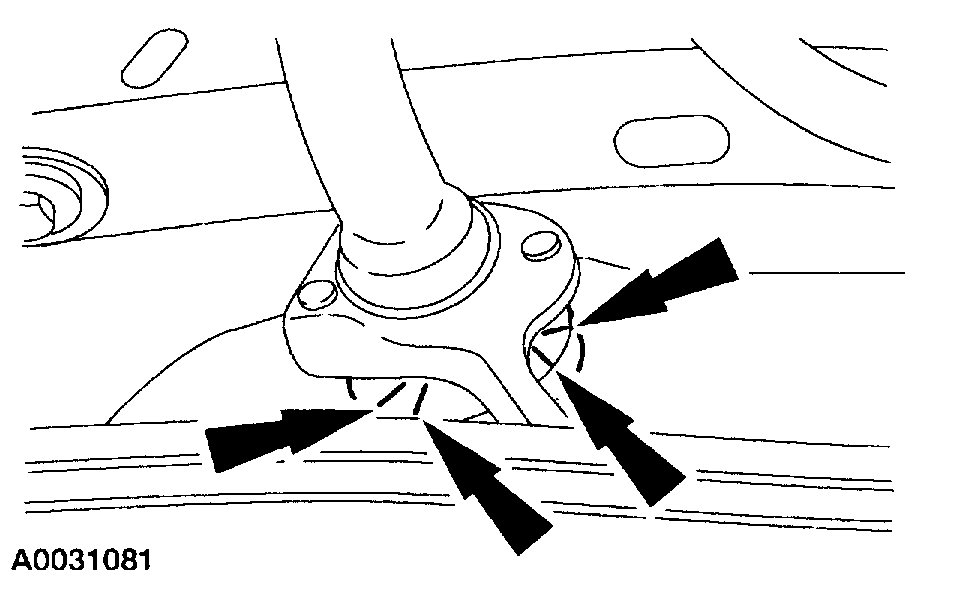

pic 6
7. Disconnect the vapor tube fitting at the left front of the fuel tank.

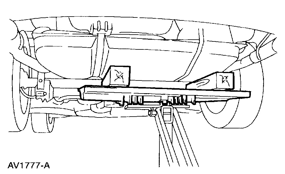

9. Place a safety support under the fuel tank.
pic 9

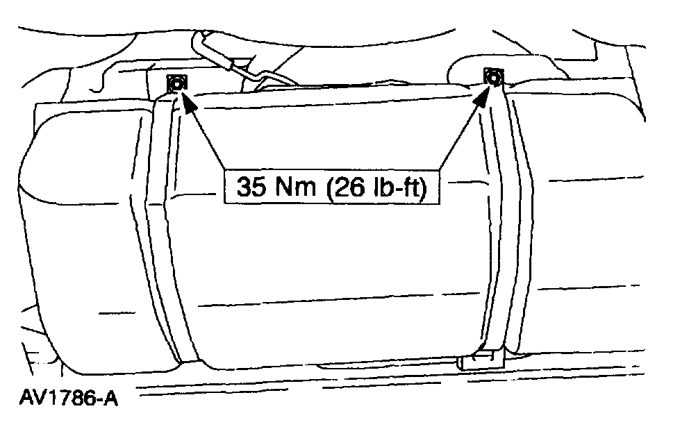

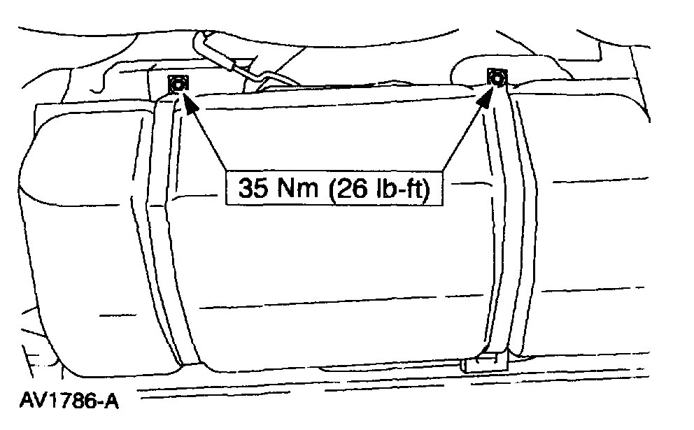

10. Remove the front bolts from the fuel tank support straps and swing the LH strap out of the way.
pic 10
11. Remove the RH fuel tank support strap bolt and remove the strap.

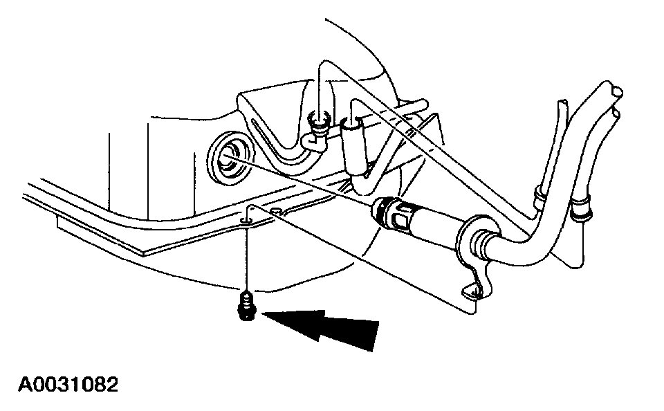

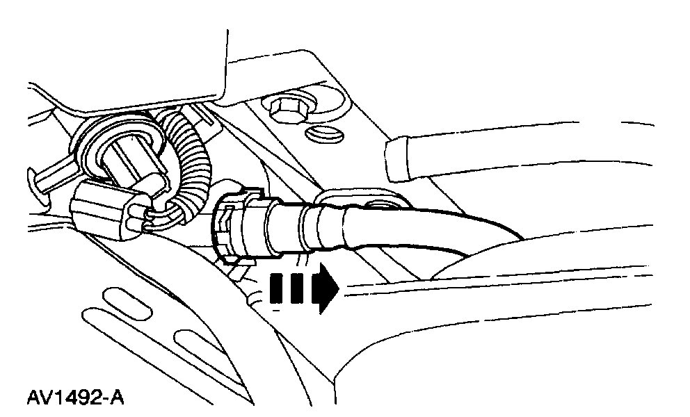

12. Partially lower the fuel tank and disconnect the fuel line.
pic 11
13. Cut outer edge of pipe-to-tank grommet to facilitate pipe removal and carefully remove the grommet from the fuel tank. Take care to avoid damage to the filler pipe check valve.
CAUTION: The filler pipe grommet must be removed prior to removing the fuel tank from the filler pipe or damage to the fill tube check valve will occur.
