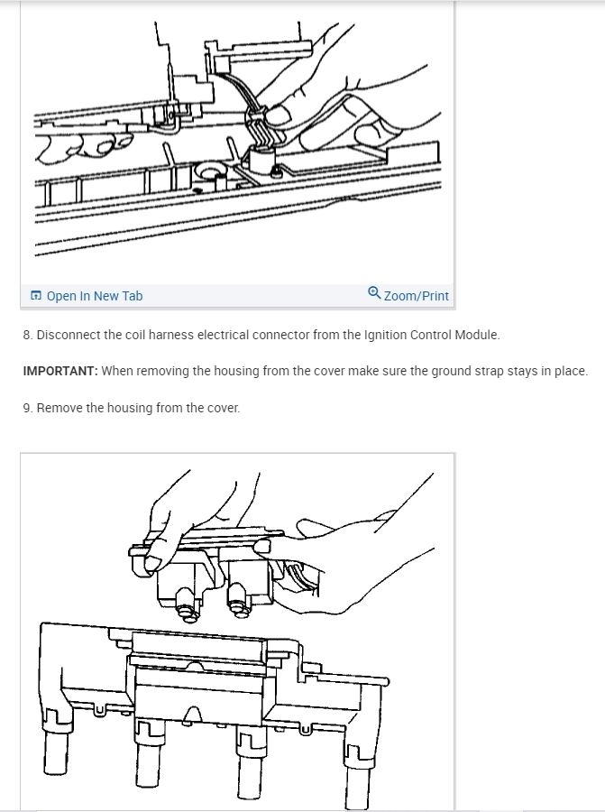

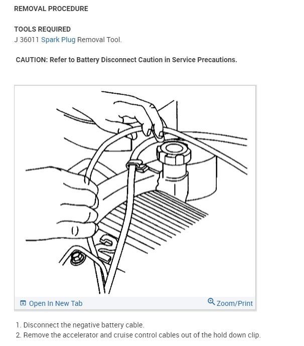

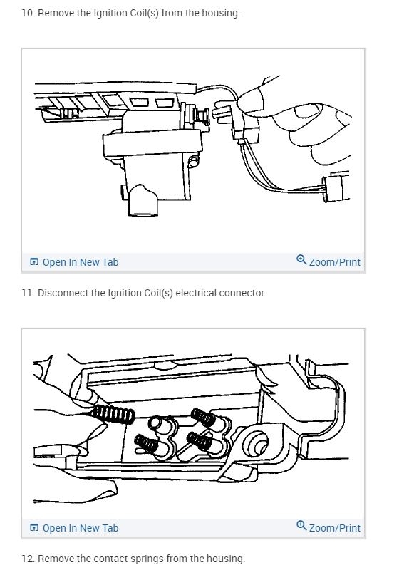

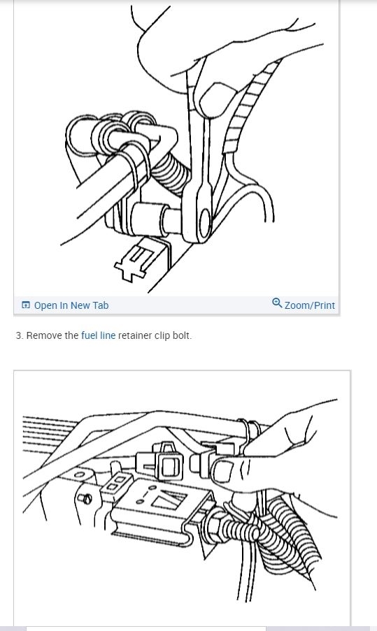

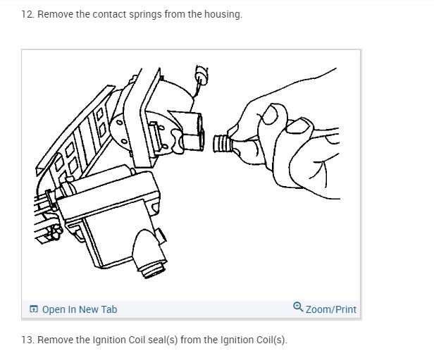

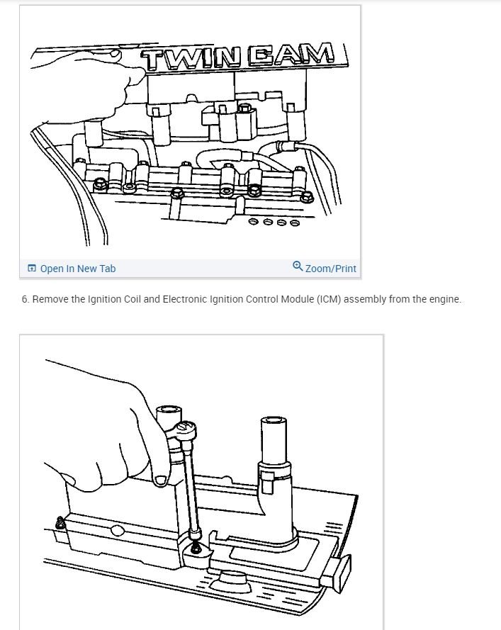

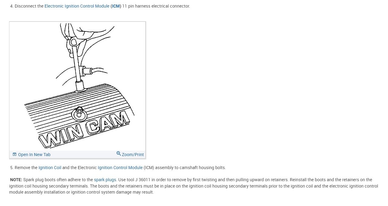

Whenever we had one of these with a misfire, we replaced the plugs, boots, coils, and cap adapter. The cap adapter is the most common failure.
I attached the procedure for you.
Let me know if you have any other questions.

You guys' rock. Fast reply, you send easy to see the steps. One question though, where is the cap adapter located? I searched and searched those diagrams and didn't see it. I know my eyesight isn't great, but no luck. Thanks in advance.
Mar 13, 2022 at 8:18 AM
Thank you for the kind words.
When you remove the top cover, turn it over and it is there bolted to the inside of the cover. Four little screws and it comes off.

So I've got the new plugs in but little improvement. Have the new coil pack and cap adapter. What's the secret to holding the coil packs in place when you put the adapter cover on?
Mar 16, 2022 at 11:14 AM
DAN DAVIES
  • 7 POSTS
So, I've got the new plugs in but little improvement. Have the new coil pack and cap adapter. What's the secret to holding the coil packs in place when you put the adapter cover on?
Mar 16, 2022 at 11:38 AM
Take off the top cover and work on it on a flat bench.
Look at the pictures and the procedure and follow them.
