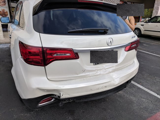

We bought this vehicle brand new off the lot in August of 2016. white/black.

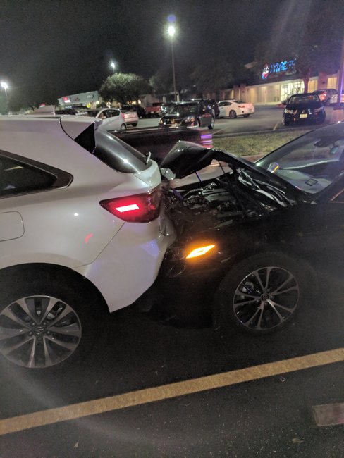

It had 11,000 miles on it when we were rear ended by a 2017 Camry (which was a rental) and I swear she was going thirty five to forty mph (based on some of the other pictures here I have seen of cars being hit at fifty plus mph, my car was damaged pretty similarly). Another guy ended up hitting her from the back, which caused even more damage to my car.
In total there were four cars in this accident.
Front car - Jeep Patriot (barely got a scratch on his bumper, as I tapped his car after the impacts of the cars behind me).
Second Car - me.
Third Car- The girl going thirty to fifty mph in the Camry that rear ended me (totaled).
Fourth Car- Chevrolet Malibu with a uninsured motorist with expired drivers license.
Police report deemed the fourth guy at fault. So this is a uninsured motorist claim with my insurance carrier (Geico). I have coverage for this.

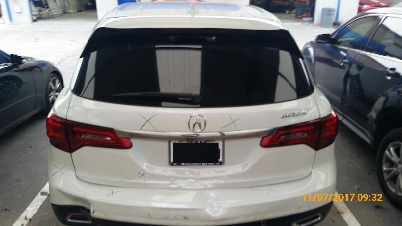

November 3, 2017- Accident occurred, took to a local highly reputed Austin shop on Nov 5.
Nov 5- December 6, 2017 - Shop "worked" on my car. "no frame damage" "The whole impact was on a aluminium impact bar"

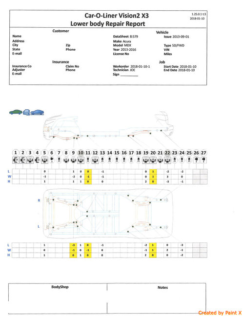

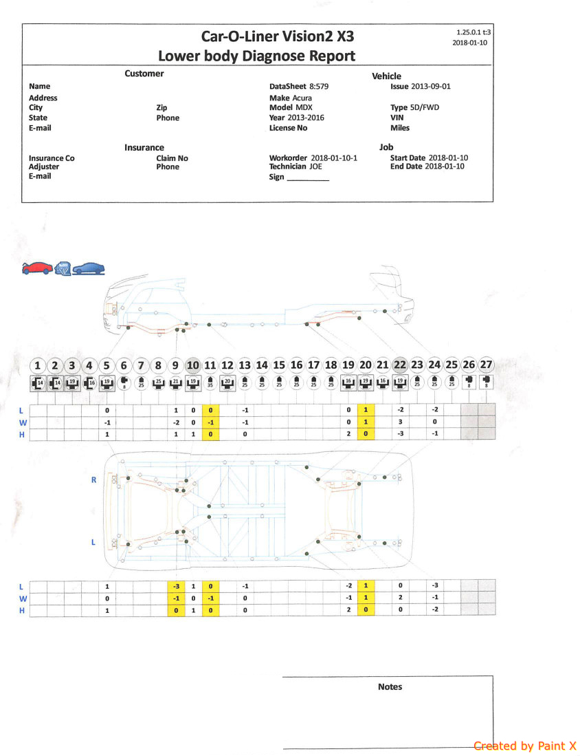

Can you help me read this car-o-liner report? Why didnt the measure the entire underbody left, right, etc? Seems like they did a spot check on this. What are the highlighted numbers and the mismatches?

I have no idea what that means, I have never seen one of those before.
Jan 10, 2018 at 9:59 AM
SPEEDWAY121
  • 4 POSTS

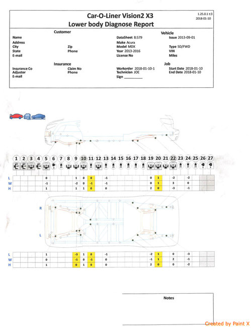

OK so the report above is basically showing how far off the spec this car is from the manufacturer off the production line specifications. the numbers mean 1,2,3 mm off specification. of course there is a 1mm tolerance allowed, but much more than that is due to frame warping etc. I have taken the car for multiple alignments and the CASTER between the left and right wheel has a huge difference, and cannot be adjusted any further to put it in spec. Hence a few of the people who looked at the car are telling me there is something else going on potentially with the frame or subframe.
Jan 30, 2018 at 4:55 PM
PATENTED_REPAIR_PRO
  • 1,853 POSTS
The caster usually gets thrown off when the lower control arm gets knocked back toward the rear of the vehicle, that would make the caster go too much negative. If that is what happened, chances are the lower control arm is bent and will have to be replaced cause any adjustment procedure isn't designed to correct that much of an error.
Jan 30, 2018 at 4:59 PM
SPEEDWAY121
  • 4 POSTS
Which lower control arm should I focus on? Acura has already replaced the front driver side one and that didnt fix the problem.
remember the accident was on the rear driver side impact.
