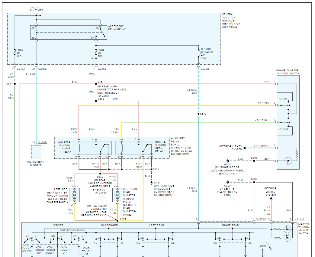

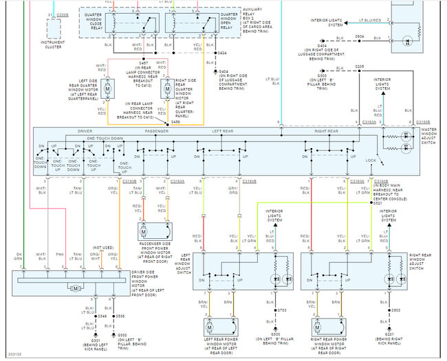

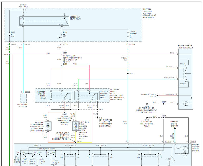

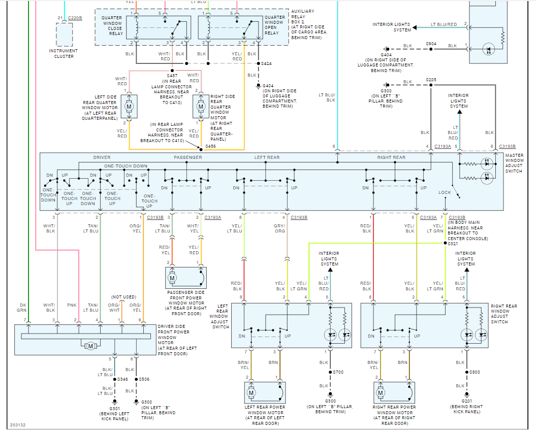

There is a logic module inside the window motor FYI, you might need to get an OEM unit. Also, check the window tracks so make sure the window itself can be moved easily. Check out the images (below). Let us know how it goes.
