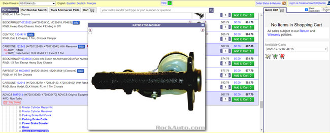

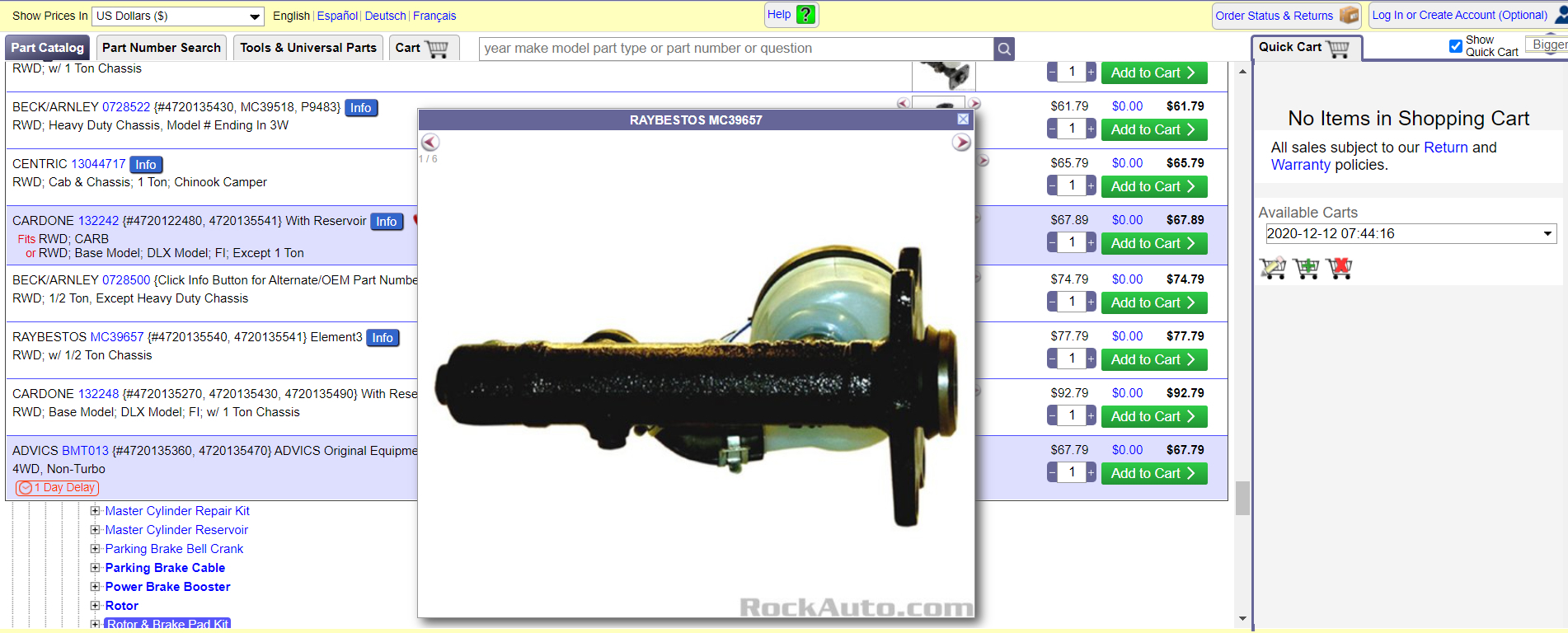

I would get a better brand.
I attached a Raybestos from Rock Auto for you.
