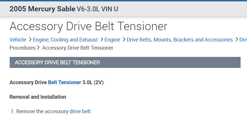

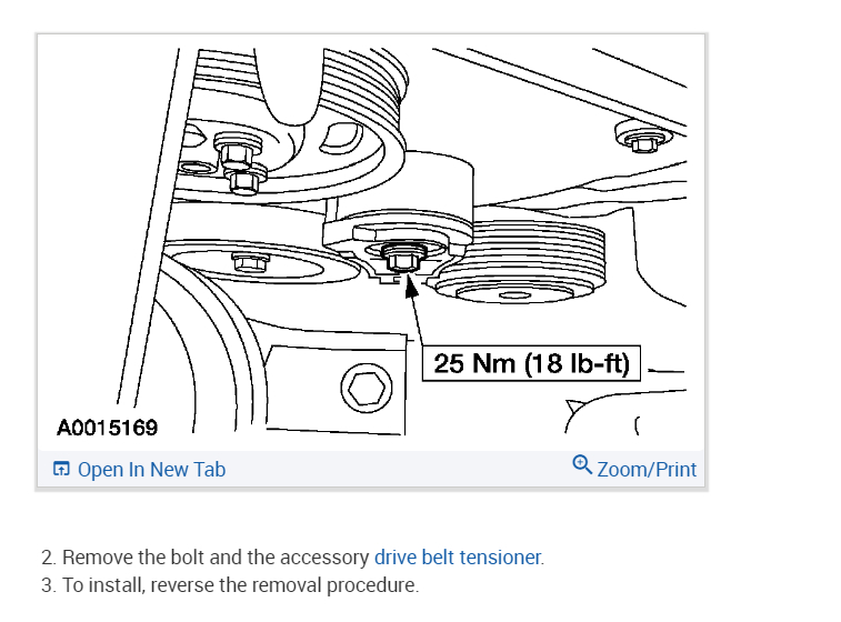

The procedure is pretty straightforward and simple. I have included it in the diagrams down below for you. I hope this helps. Check out the diagrams (Below). Let us know what happens and please upload pictures or videos of the problem.
