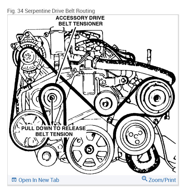

First you must remove the serpentine belt, then the tensioner is attached by stud through the bracket with a nut on the back of the bracket. Check out the image below to help see what I am talking about. Check out the images (below). Let us know what happens and please upload pictures or videos of the problem.
