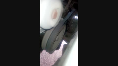

My car belt squeaks only when I apply brakes to slow down speed. it squeaks and when I apply a little acceleration it stops means when I apply brakes 800 RPM's. then apply acceleration to 900 RPM's it stops squeaking. I am adding a video I guess it will help me out. And yeah I installed a new water pump pulley and new belts two times. Problems solved for three months then came back again.

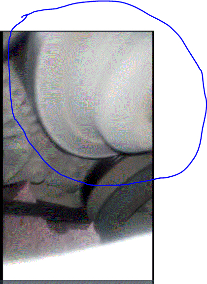

Try tightening the alternator belt and let me know if the sound goes away. Also, while watching your video, it appears that the water pump pulley is moving around as if there is a bearing issue. Please check the pulley for tightness and make sure there isn't any play in the pump shaft. One other thought, make sure there is no coolant leaking from the pump and getting onto the belt.
I attached a pic from your video and circled the pulley I'm referring to.

Water pump pulley is brand new, I believe it's only runs 4000km . I also suspect noticed that moving but its not bad I will tight the but and will tell you.
Dec 22, 2020 at 11:36 AM
Let me know what happens. Also, check to make sure there isn't excessive play in the pulley. The way it is moving may be the problem.
