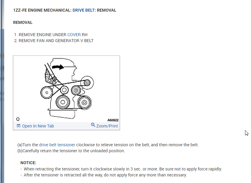

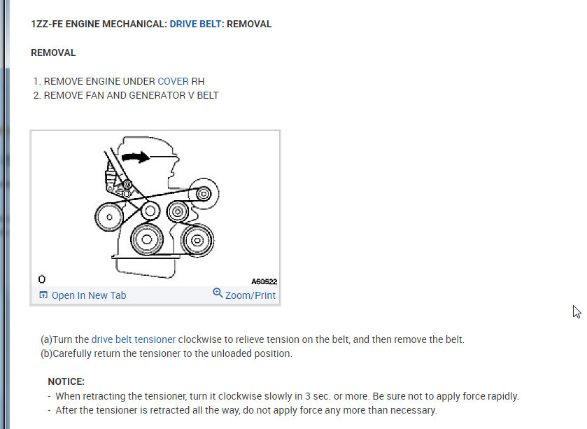

This could be the tensioner but I bet there was just something that got on a belt or a pulley that is causing the noise.
https://www.2carpros.com/articles/car-squeaking-noise
I would just get some stuff called belt dressing and see if it stops. If it does not then I would replace the tensioner as the incorrect tension is the next most likely cause.
