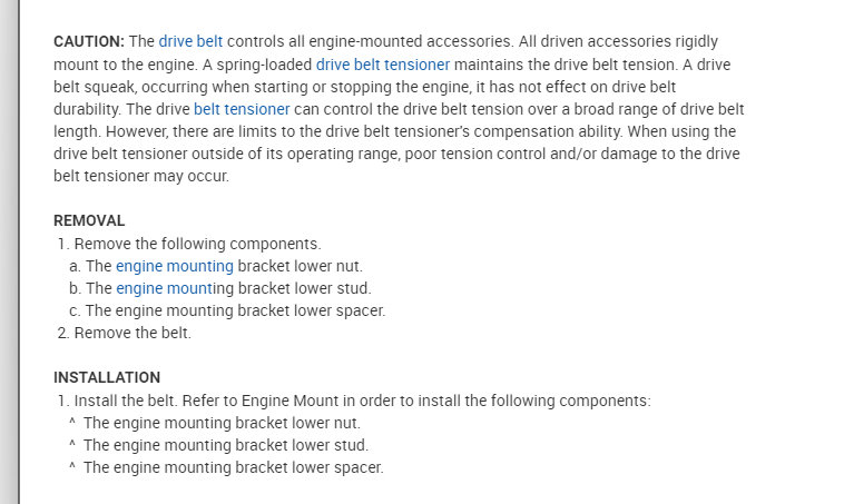

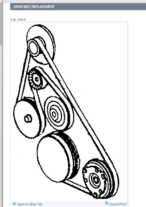

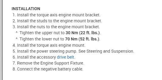

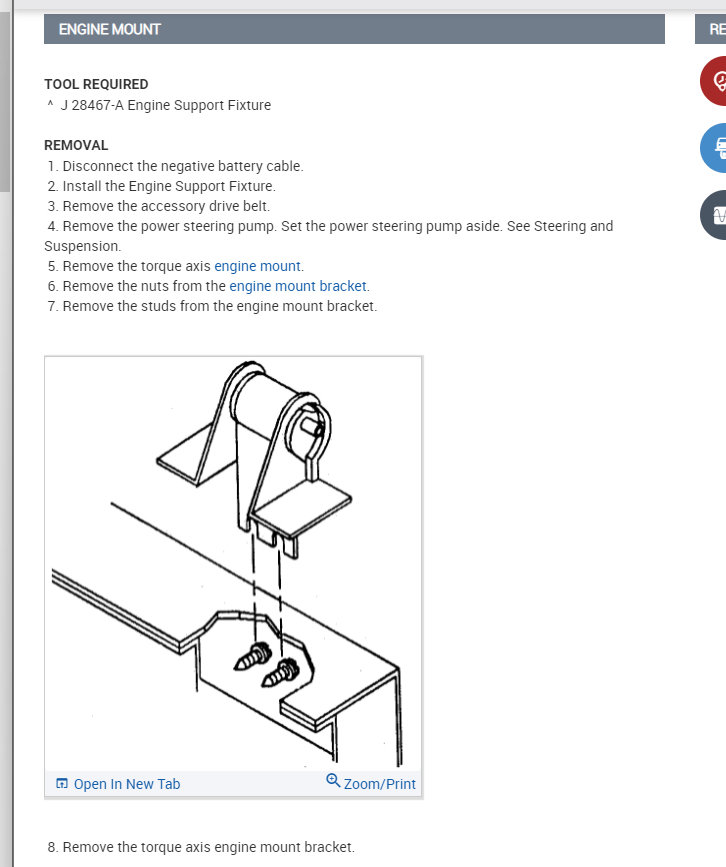

Hoe do i remove the mmotor mount to replce the serpentine belt
Nov 29, 2021 at 8:50 AM
CERTIFIED EXPERT
18,907 POSTS
I will attach all the needed info from the manual, but here are two guides that will help with good info:
https://www.2carpros.com/articles/replace-serpentine-belt
https://www.2carpros.com/articles/replace-motor-mounts
Below you will find the info from the manual. Please run through this and let us know what questions you have.
