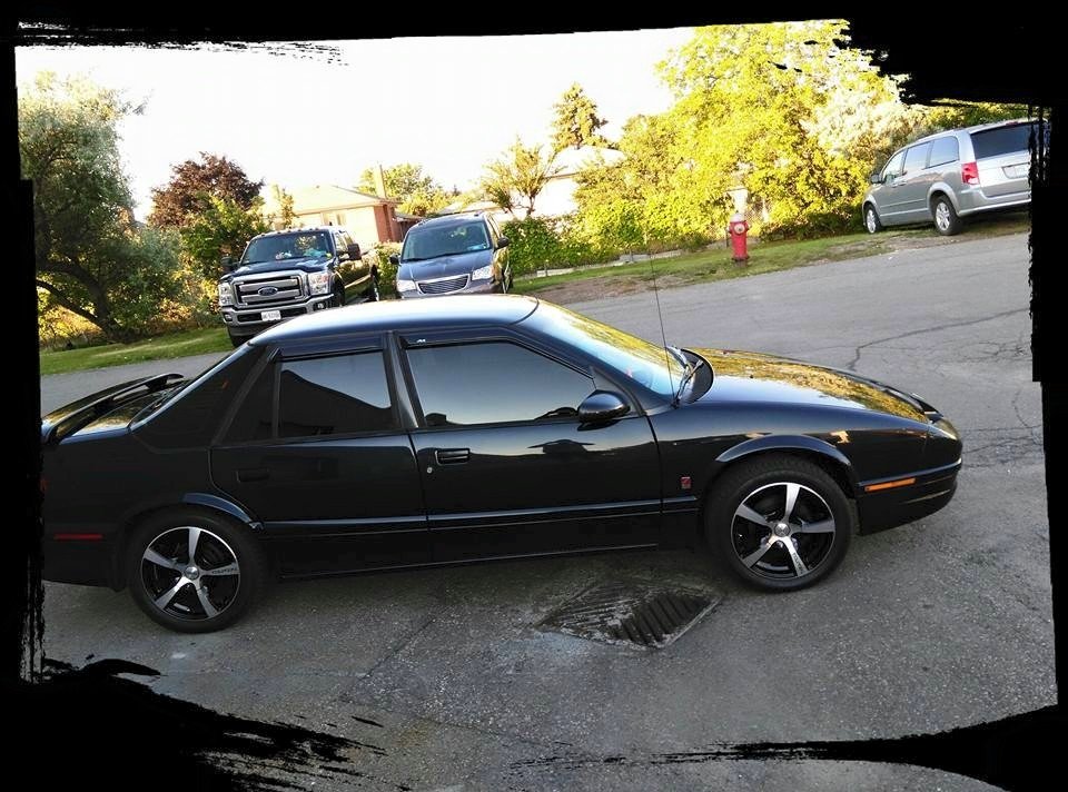

Please use 2CarPros anytime, we are here to help. Please tell a friend. Nice car BTW :)
