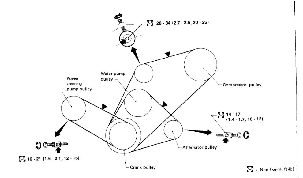

Kid took it apart cannot remember what belt order to reinstall. Please help with diagram of install.

I attached a diagram of the belts, pulleys and tension-er.
It does not show what pulley on the crank but if you set the belt, just be sure they align with all the pulleys.
