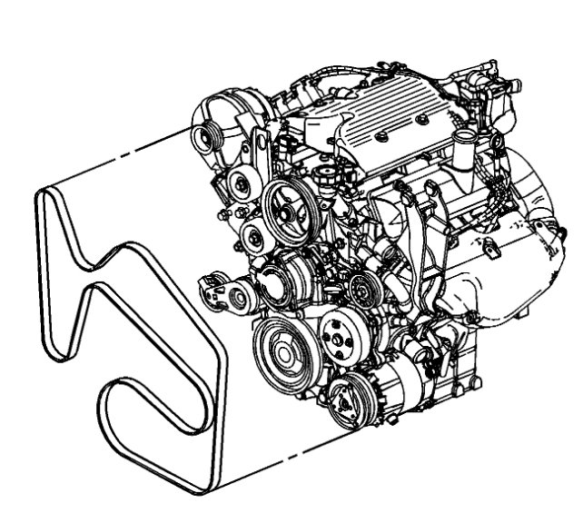

Diagram, what could cause to come off. Can I just put it right back on?

It's possible the belt tensioner is weak/not holding tension any longer.Here is a tutorial showing what is involved for its replacement and replacing the belt:
https://www.2carpros.com/articles/replace-serpentine-belt
https://www.2carpros.com/articles/how-a-serpentine-belt-tensioner-works
https://www.2carpros.com/articles/serpentine-belt-tensioner-replacement
I've attached a diagram below as you requested on the proper belt routing.Hope this helps and thanks for using 2CarPros.
