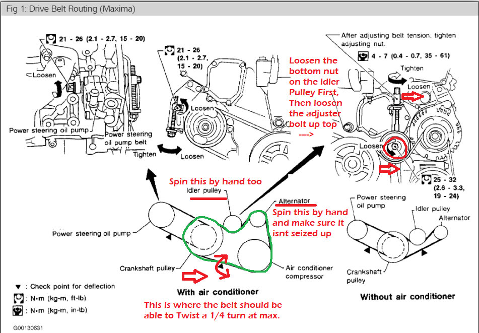

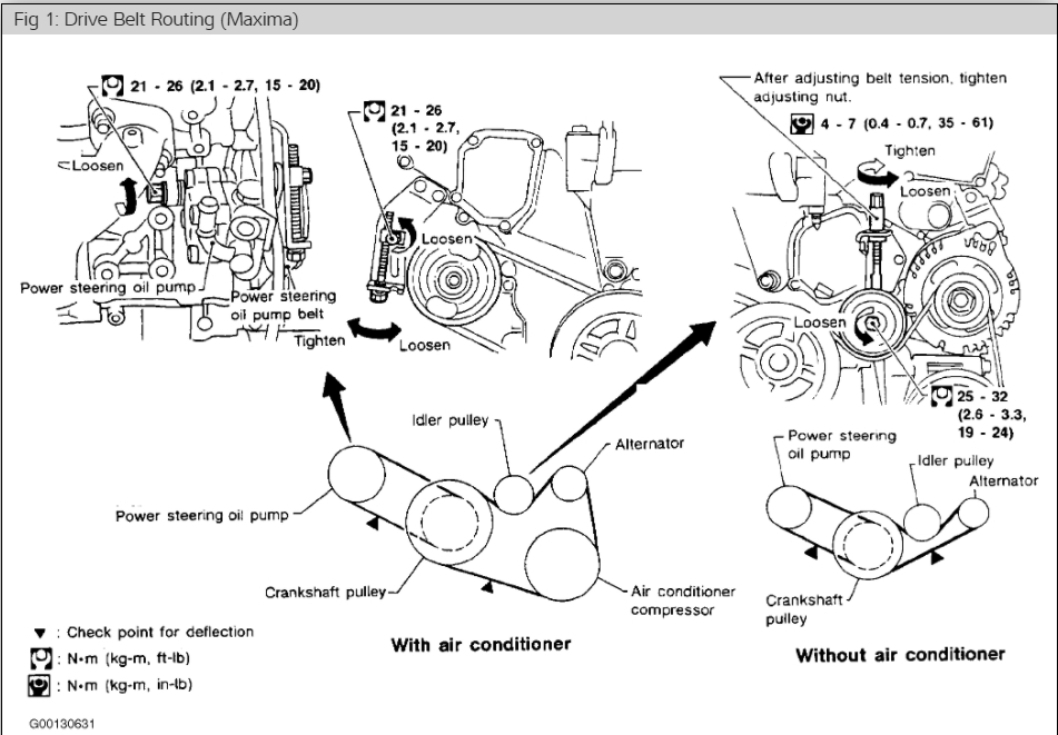

By this diagram can you tell me which one came off? I only see 2. The smaller one is for the power steering pump.
I would possibly suggest finding a new mechanic if a belt came off only 10 days after a repair, that absolutely should not happen, especially since it's probably your power steering belt.

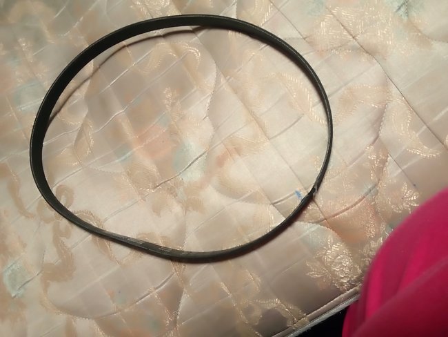

Here's a picture of the belt.
Feb 20, 2022 at 4:03 PM
AMANDA ODOM
  • 6 POSTS
https://www.2carpros.com/files/temp/3470138810.jpg
Feb 20, 2022 at 4:09 PM
AMANDA ODOM
  • 6 POSTS
When it came off it made a very funny sound and my battery light and brake light, and engine light came on my headlights got dim, I was able to drive home but haven't driven it since. I did try to start it this morning and it still starts. It wasn't hard to steer like my van when the serpentine belt broke.

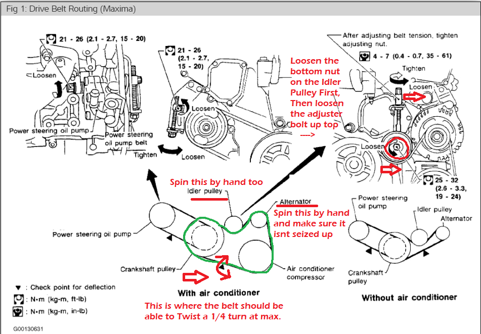

Okay, I see, the instructions are in Red below. In Green is the belt Routing. Make sure the belt is not broken. Start with the Idler Pulley, loosen the nut in the middle of the Idler Pulley, but don't take it off. Just enough so the Pulley can slide to be adjusted by the Upper Bolt.
Next Loosen the Adjuster Bolt in the direction of the Red Arrow. You'll notice the Idler Pulley starts moving upwards. Adjust it only far enough to get the belt on.
With the Belt, Start with the Air Conditioner Compressor, Then to the Crankshaft Pulley, Next the Alternator. and finally slide it on the Idler Pulley.
Make sure that it is lined up in the Groves on all the Pulleys, except the Idler Pulley because that doesn't have any Groves.
Once the belt is in place, start to turn the Idler Pulley Adjuster Bolt (up top) the opposite way to tighten it.
You'll notice the Idler Pulley moving downwards and tightening the Belt.
This is the important part. only tighten the belt so much and check it.
As a rule of thumb, when it adjusted you should be able to twist the belt 90degrees with your fingers. At a point between the Crankshaft Pulley and the Air Conditioner Compressor at the bottom, (this is where the belt has the longest point where it's not touching any other pulleys). It should be able to twist a maximum of about a 1/4 the way around by hand. Hopefully you understand what I'm saying. I'll put it on the diagram.
Once you get it tight enough, you'll need to tighten the Idler Pulley Nut that you loosen in the first step. It should only take 2 wrenches to do this.
It may look intimidating, but the most important part is getting the belt tightened enough and tightening the Idler Pulley Nut, (which it seems is what your mechanic forgot) or there's a problem with one of those other pulleys.
If the Alternator, Idler Pulley, and Air Conditioner Pulleys don't move by hand, then something seized up and you will have to have it towed to the mechanic.
If you have any questions just ask and take a picture of it when you're done so we can see it.
