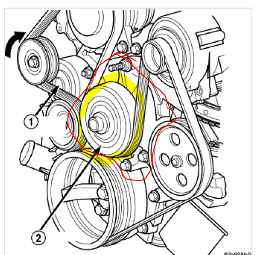

Either coolant or oil could cause the belt to slip. Not always but often, a failed water pump will get leak coolant on the belt causing it to get wet.
I attached a picture for you below showing the pump's location. Check around that area. Also, check behind the water pump pulley to see if it's wet.
Let me know what you find.
See pic below.
