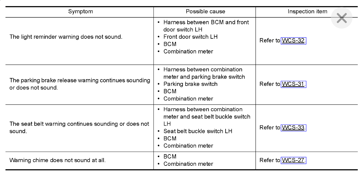

My car is making three beeping noise every time I turn it on and off.

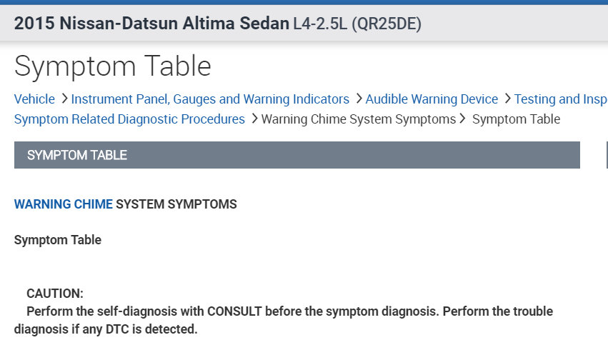

In the diagrams down below I have included the troubleshooting guide for the warning chime system for your vehicle. Please go through this guide and get back to us with which symptom related issue from the guide best describes your vehicle's issue. We can then send you the related diagnostic troubleshooting guide for that symptom.
Thanks,
Alex
