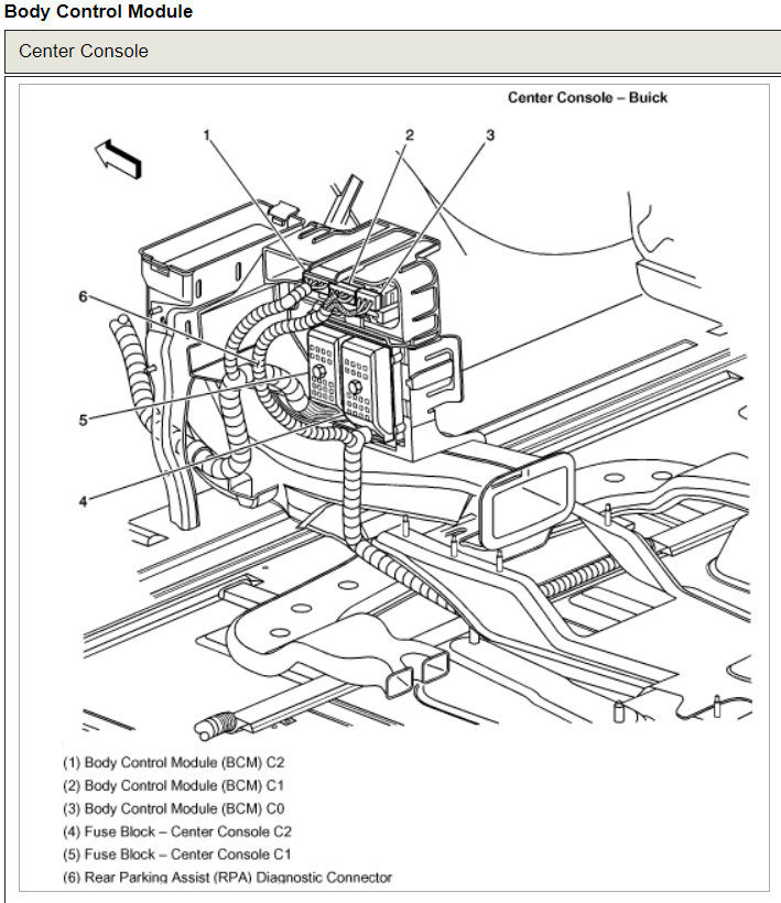

I got a 2004 Buick rendezvous it stopped on me wouldn't jump off when I got it home changed starter didn't help but left it unhooked from battery now found inside car 30 amp metal fuse bad do I need to reset bcm cause I now don't have low beam head lights window want work doors locks don't work so what cause that
Feb 25, 2018 at 6:33 PM
It sounds like the BCM has had a problem could be from a voltage spike when the battery was connected.
You will need the BCM reprogrammed by a shop here is the location.
Feb 28, 2018 at 11:23 AM
LUCKYONE
Thanks I got it fixed it was the wires got cought in the seat rail and cut them caused a direct short.
Mar 1, 2018 at 7:58 AM
Glad you could get it fixed, that kind of problem can be tough. Please use 2CarPros anytime we are here to help. Send a pic of the damage if you can :)
