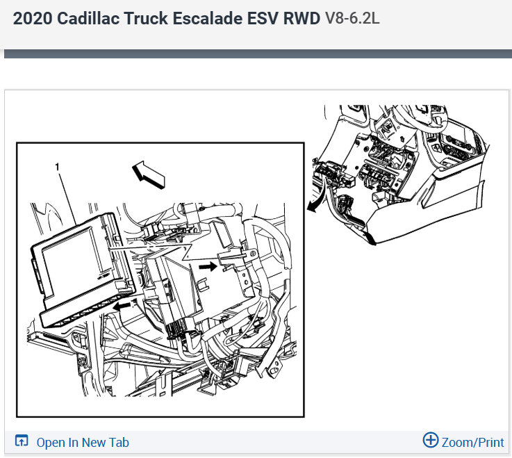

The BCM is under the dash on the driver side, I would remove the lower knee bolster to see if that helps, here are the instructions on how to remove it, start by disconnecting the battery. Can I ask if you have a replacement BCM that has been per-programmed are you using a scanner to store the code and you plan to upload the code to the new BCM? Check out the images (below). Please let us know what happens.
