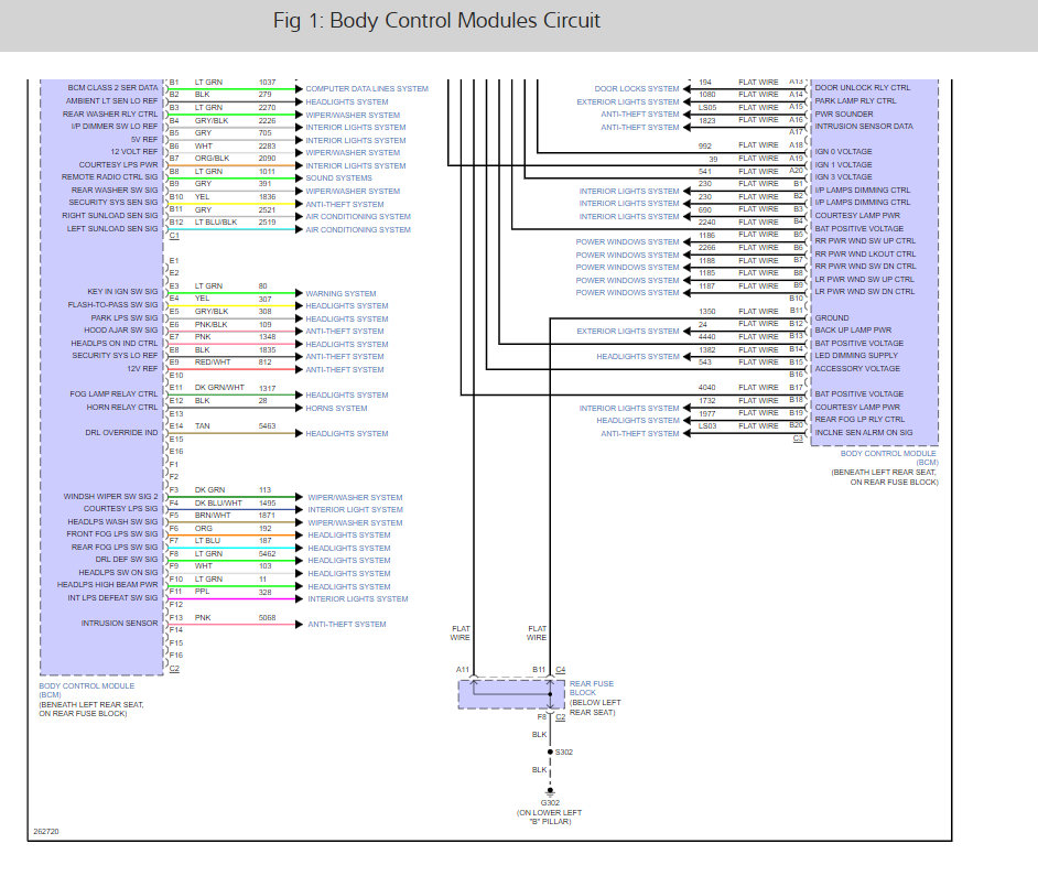

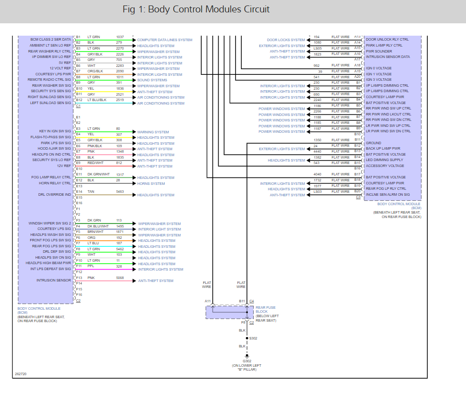

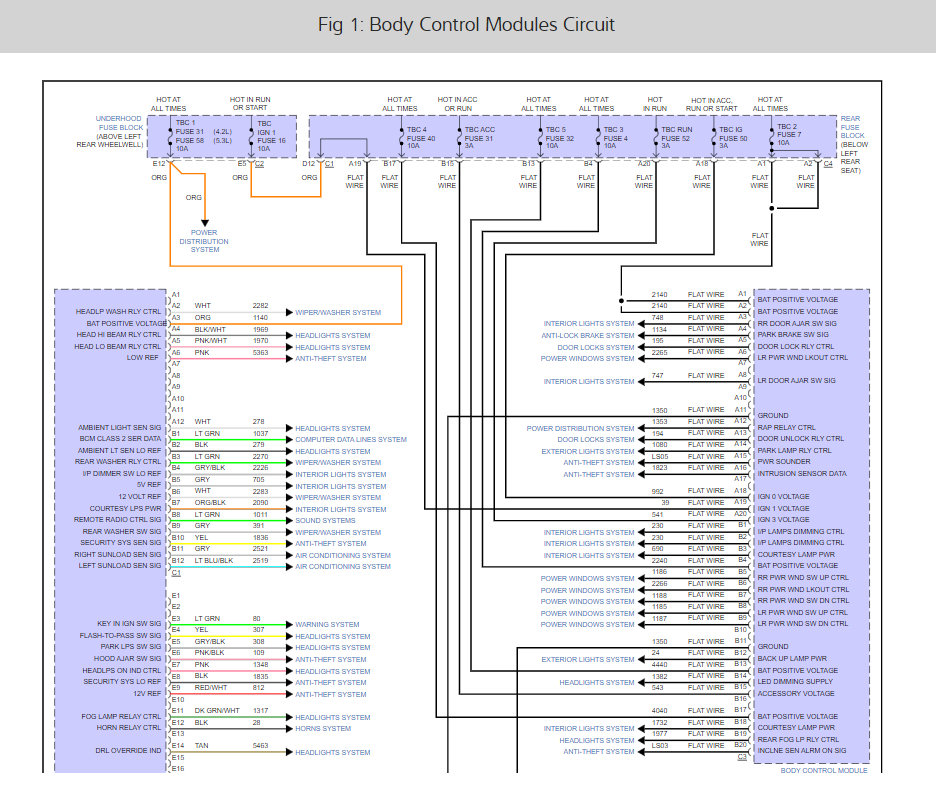

This sounds more like the alternator is overcharging or one of the diodes is bad and it is throwing AC voltage into the system, have you gone through batteries prematurely as well? I would also check the BCM system grounds high resistance can cause the BCM to go out. The BCM only has one ground check out the wiring diagrams in the images below. This guide can help you check the ground, and the second guide will show you how to check for AC voltage.
and
