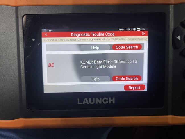

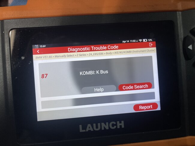

Failed to communicate with:
-Central information display
-Top module
-Light switching center
-Instrument cluster had 2 codes i cleared them and they deleted, a BE and a k bus
-radio
-airbag module
-SZM
-ZKE central body electronics
Apr 14, 2026 at 8:57 AM

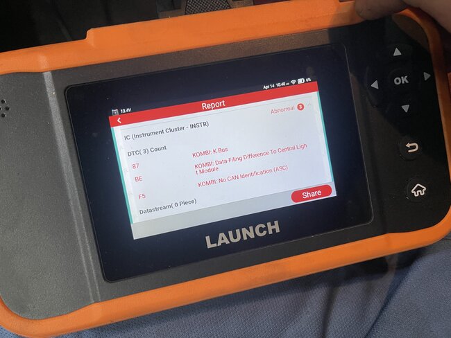

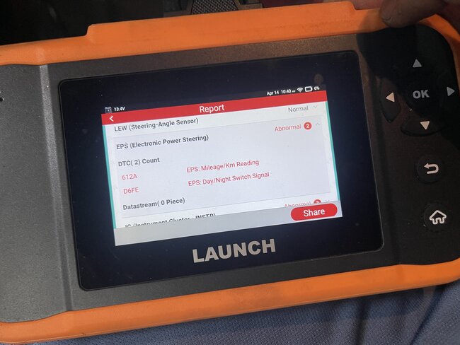

These popped back under instrument cluster

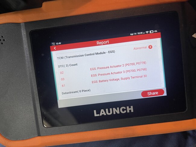

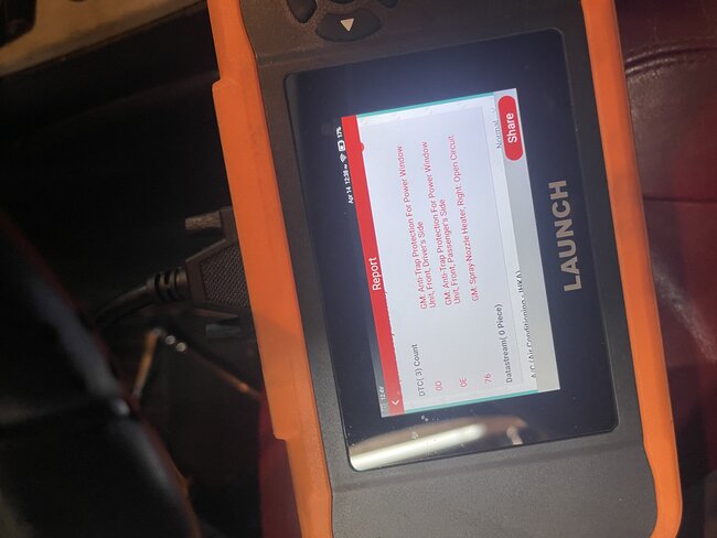

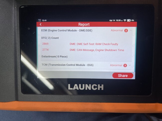

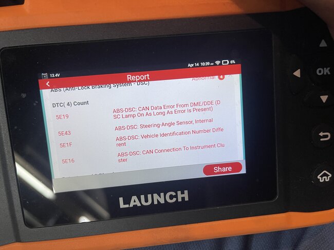

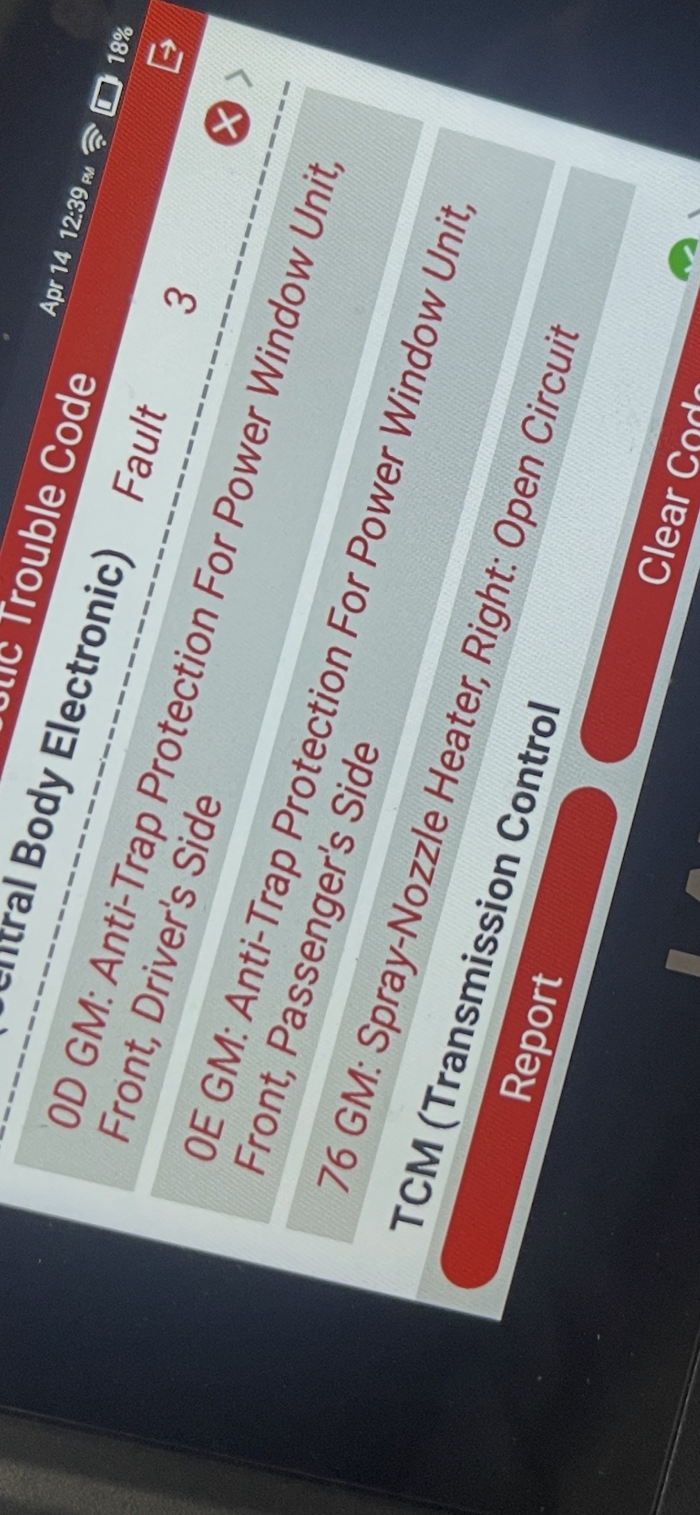

Not sure if these matter, they popped up
Apr 14, 2026 at 10:51 AM
The image is too small to read, can you enlarge it or tell me the codes?? So you unplugged the airbag module and it fixed everything except the top? I say you found the problem and the top is a separate issue.
Apr 15, 2026 at 7:32 AM
BHAMDOC1
  • 101 POSTS
attached
Apr 15, 2026 at 7:45 AM
Hmm I don't think this has to do with the top, this looks more like the window operation issue, does both windows work?
Apr 15, 2026 at 7:46 AM
BHAMDOC1
  • 101 POSTS
both windows work up and down, but because it is a convertible whenever you press the top to latch remember they have to go down a bit, also when you close the door they should roll up a bit, but they are doing neither nor
Apr 15, 2026 at 7:48 AM
Yep, that is not right, this will be the general module issue which is what they were trying to replace, I would start with the reprogram of the module or try a hard reboot of the system this video can help.
