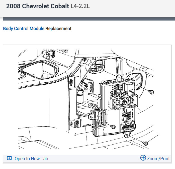

Sure, here is the location of the BCM and how to replace it. Check out the images (below). Let us know if you need anything else.

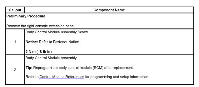

Is there more information? States to reprogram the new BCM and to refer to the BCM references on the setup.
Feb 21, 2025 at 3:03 AM
If you are getting a preprogrammed unit, you can disregard that part.
