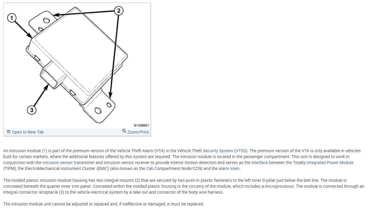

STEVE W.
  • 15,113 POSTS

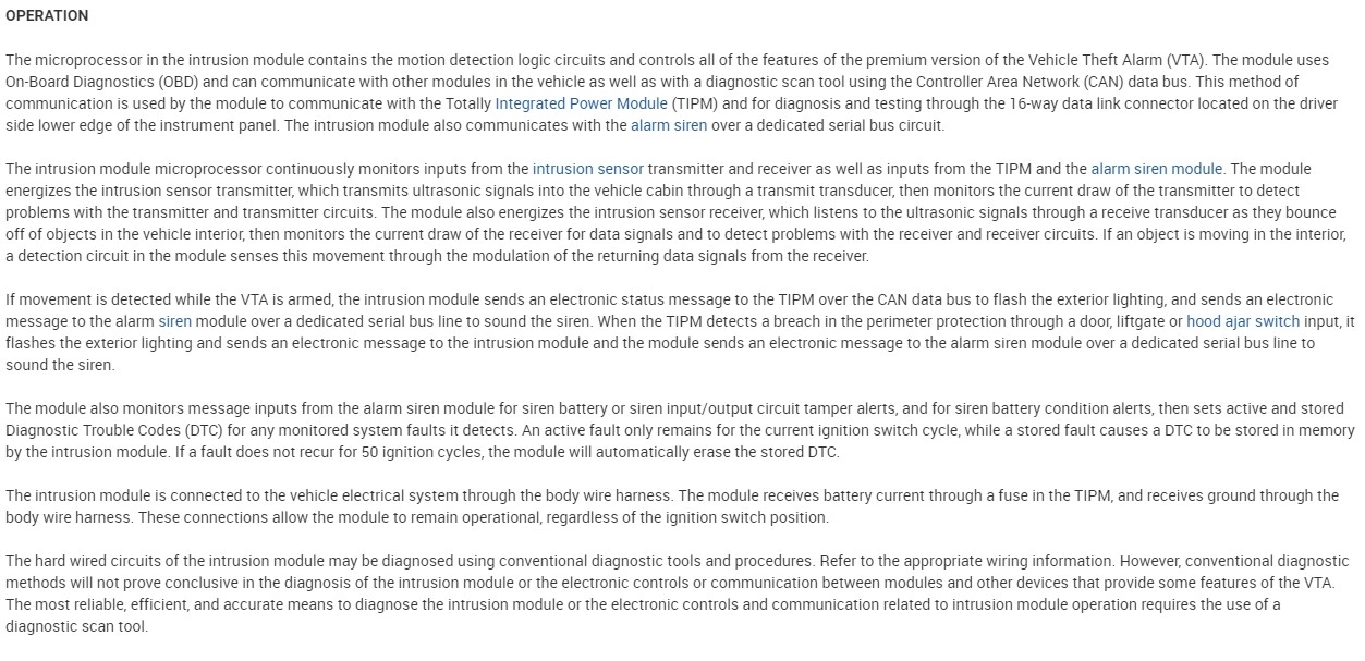

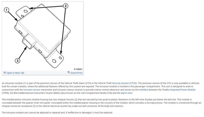

That sounds like it has a bad intrusion module antitheft system. You will want to use a dealer level scan tool to see if the issue is a mechanical one like a bad door switch or hood switch or if it's the module itself. You can get to the module by removing the rear trim on the D pillar on the driver's side. If the unit tests bad it has to be replaced. Then the replacement is programmed to the vehicle.
