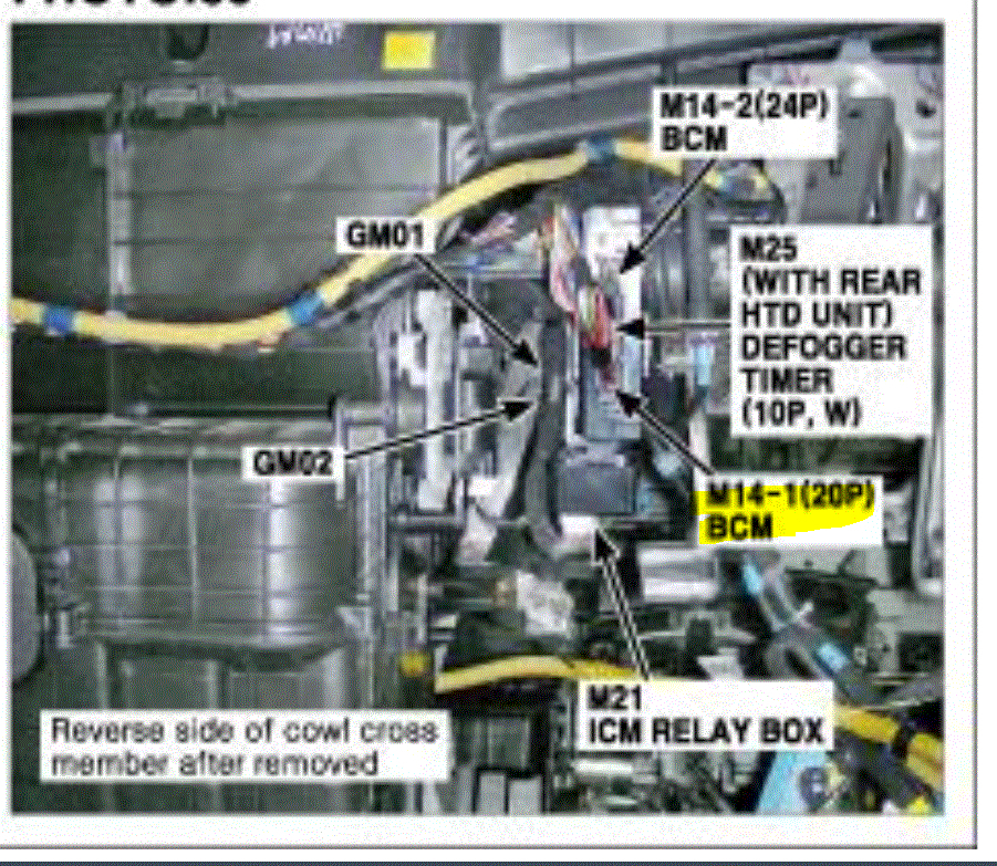

BCM location needed.
Can I reset it without bringing it in?

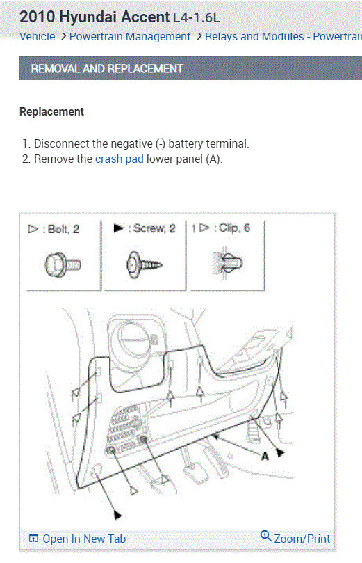

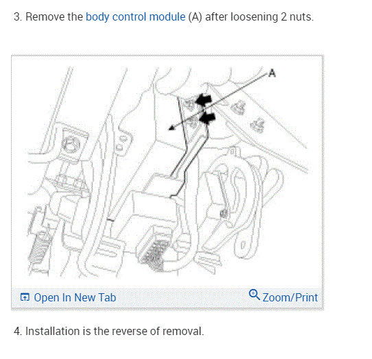

The body control module is located under the left side of the dash (driver's side).
I attached a pic below showing its location and pics 2 and 3 are the removal and replacement of it.
There is no reset. What is happening with it?
See pics below.
