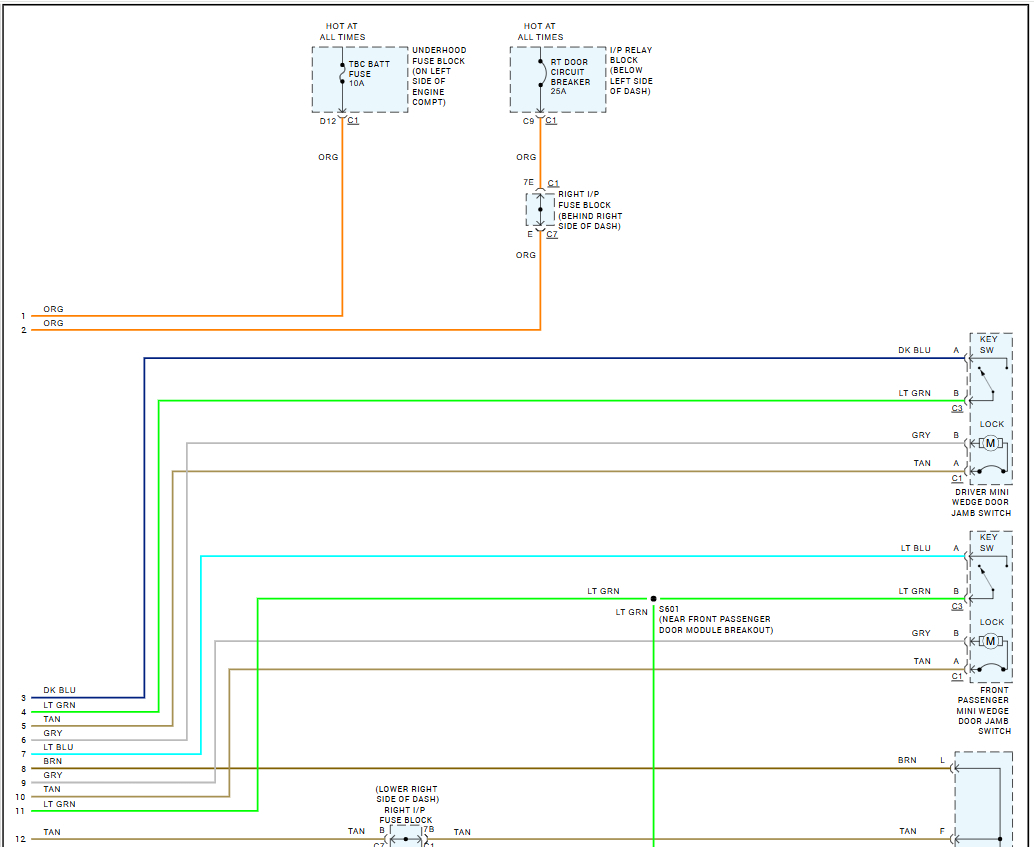

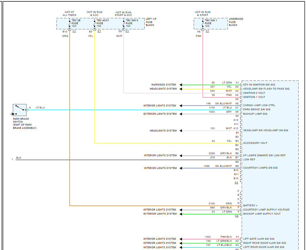

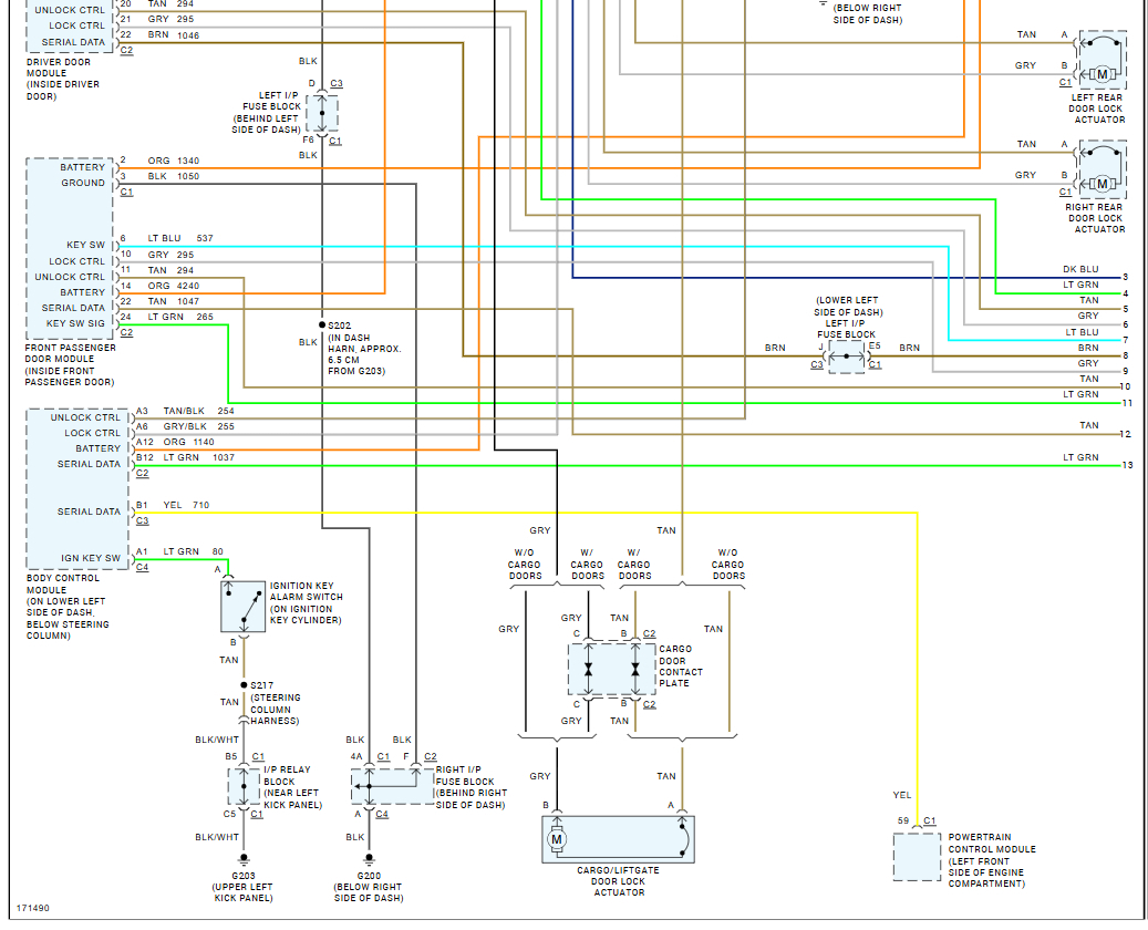

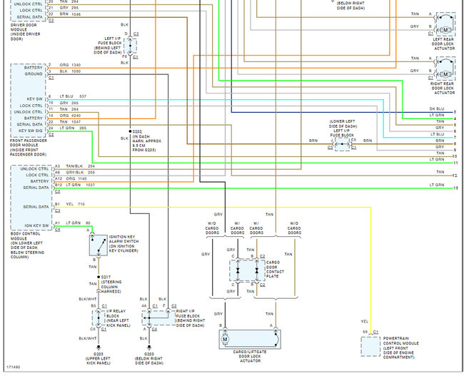

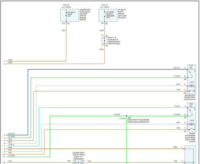

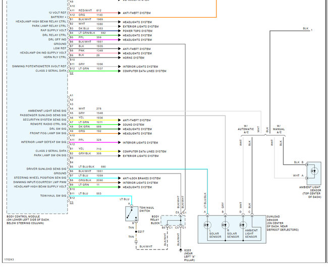

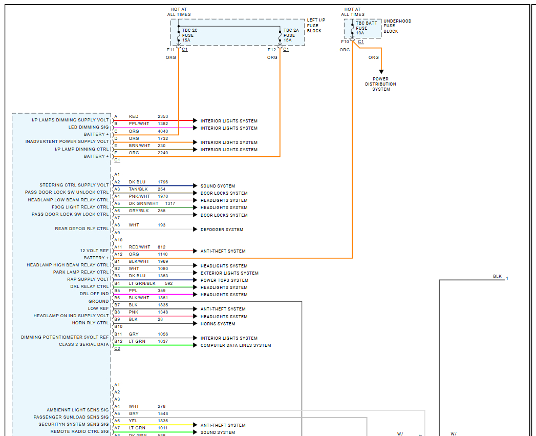

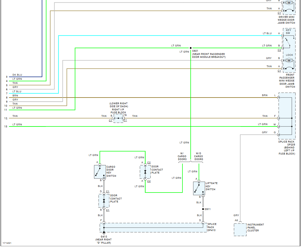

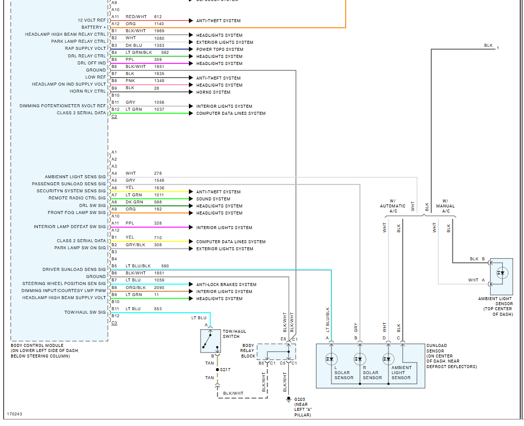

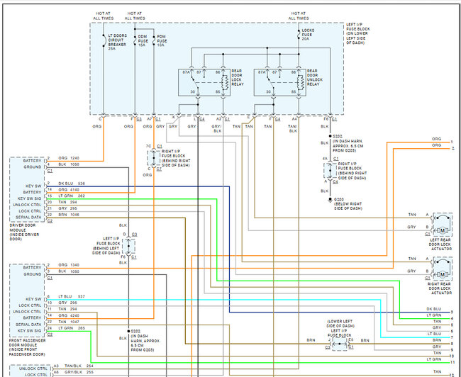

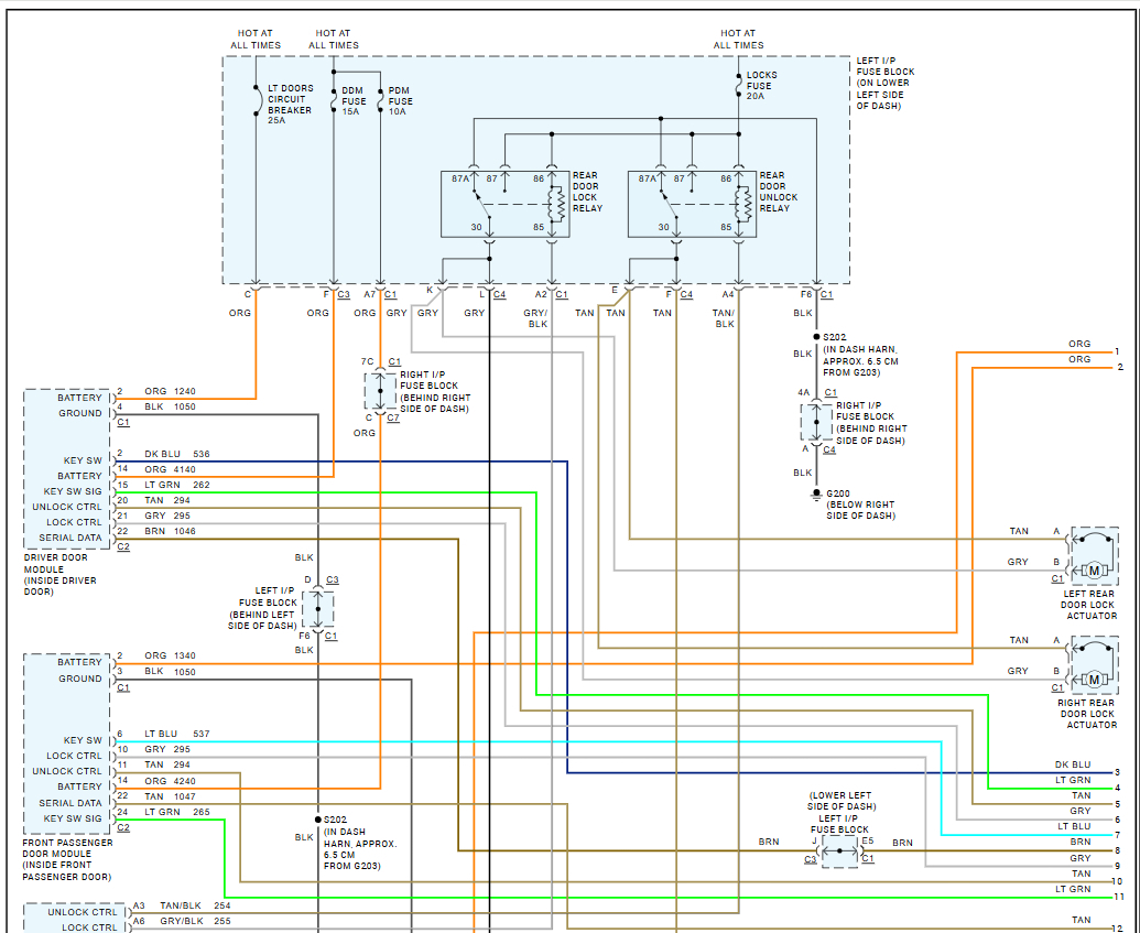

This sounds like the DDM is out, but here is the BCM and door lock wiring diagrams so you can go over the outputs and inputs. Also, did you try a CAN scan which can help give you the codes for a bad DDM? You can get a CAN scanner (Controller Area Network) which will work on most cars from Amazon.
Here is a video to show you how:
https://youtu.be/u-4syLc-ifQ
As you can see the BCM does not have much to do with the door locks. Check out the images (below). Please let us know what happens.

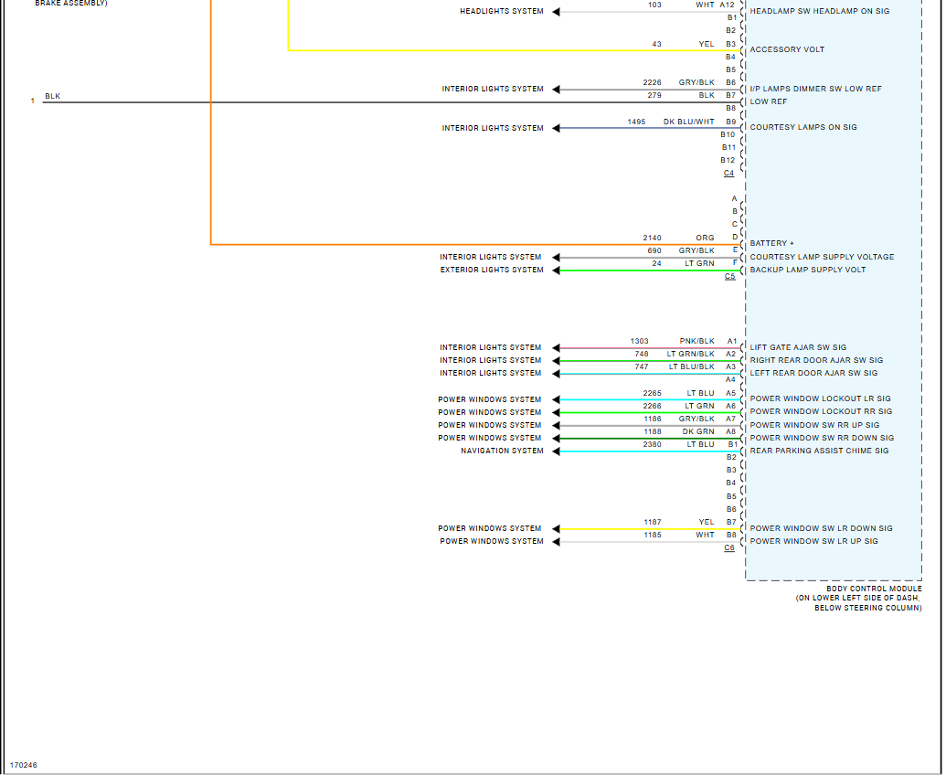

Today, I went and checked the voltage readings at the BCM Connector C6 terminals a2 (RR Door Ajar) and a3 (LR Door Ajar). Since the LR Door Ajar switch is known to work properly, I got a baseline from it.
With the LR door closed, the voltage at a3 is 10.7v, opening the door causes this to drop to 0.0v
The voltage at a2 (for the RR door) is 0.5v and drops to 0.0v when opening the door.
To confirm proper operation of the switches, I swapped the terminals a2 and a3. With ck#748 (for RR door) plugged into terminal a3, the vehicle recognized the LR Door being opened when I opened the RR door. In my opinion, this confirmed proper switch function in the rear doors.
