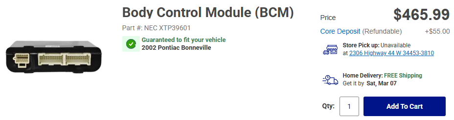

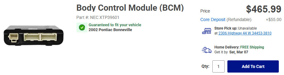

If there is no BCM, I wonder why Napa sells them for my car? See attached NAPA screenshot. Rock Auto sells one too?.

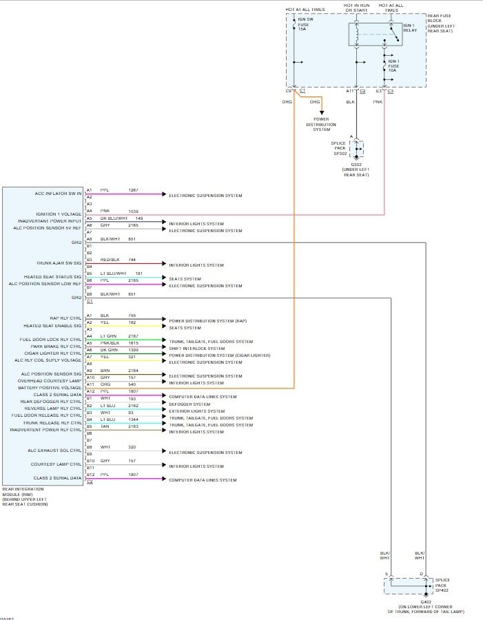

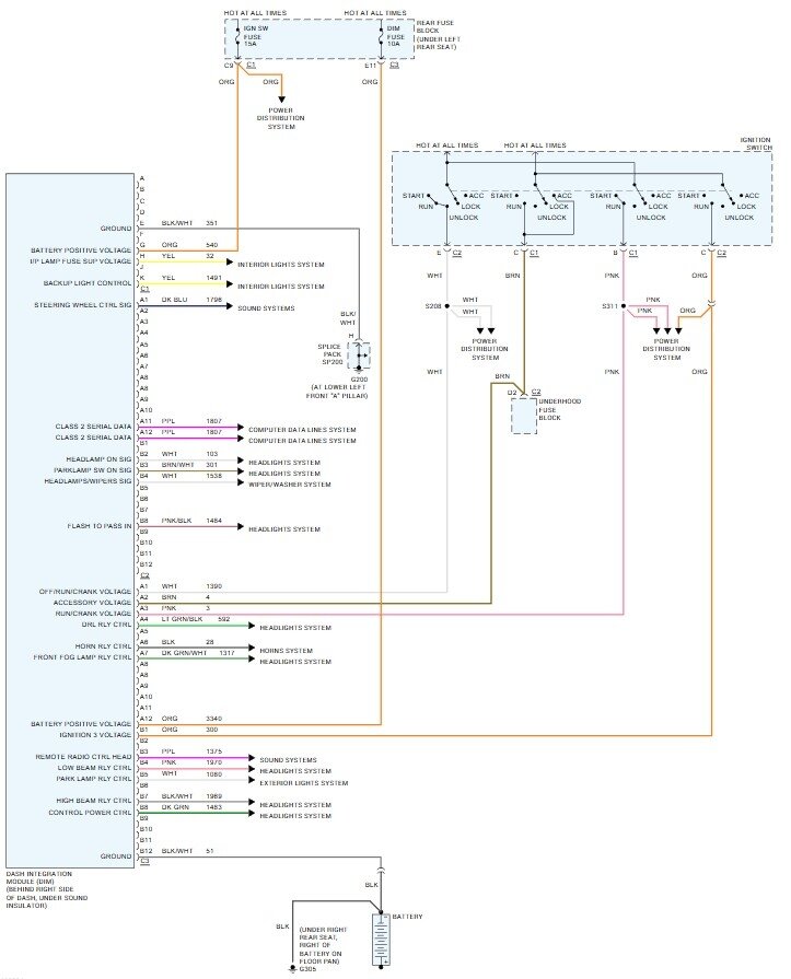

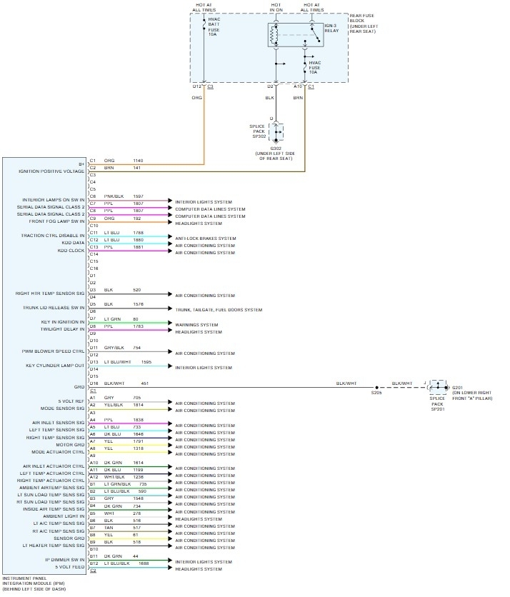

The part they sell as the BCM is actually the DIM, the Dash Integration Module. It's one of the three modules that control the body systems and one that is the most failure prone. Attached are the three circuit diagrams for the modules. In a vehicle with a single module BCM they integrate the three systems into more of a single module with maybe one or two specific functions as a different module depending on the options. Might I ask why you want to eliminate the chimes so much? Not a common issue that is asked. Depending on which chime it would stop them if you fully disconnect the radio, but then you are left with none of the important warning chimes either. If they are constantly going off there is usually some failure involved.
