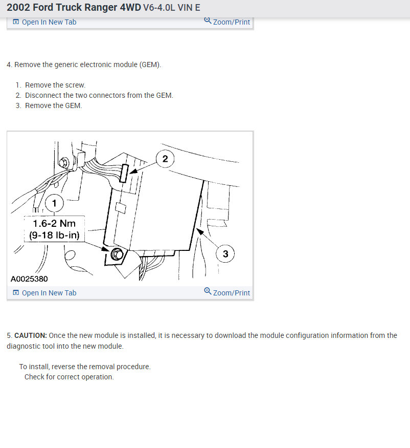

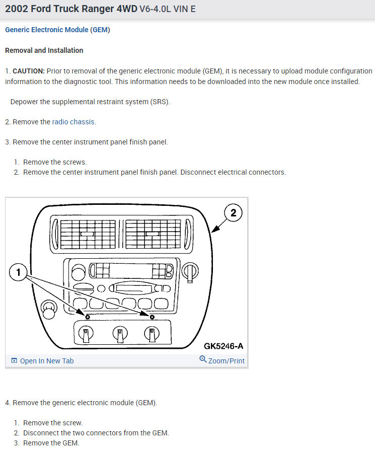

On the Ranger Ford calls the BCM, General Electric Multifunction module (GEM).
It is located on behind the radio panel.
In order to access it you will have to remove the radio panel.
After removing the radio, you will see the GEM module on the left side of the opening.
Here is a helpful video of how to access it:
https://youtu.be/v1vruft5TAE

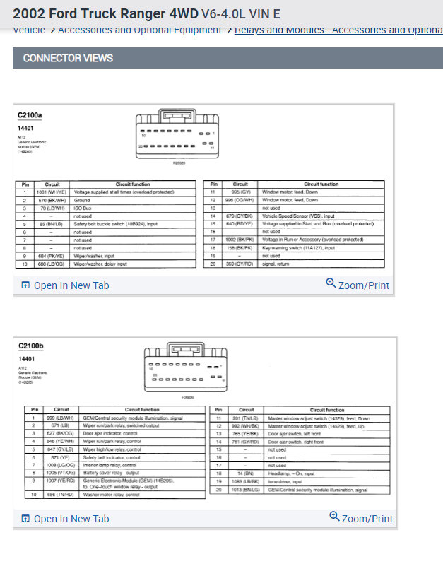

Please let me know of any questions. Thank you.Replacement diagrams for the GEM. Look below.
